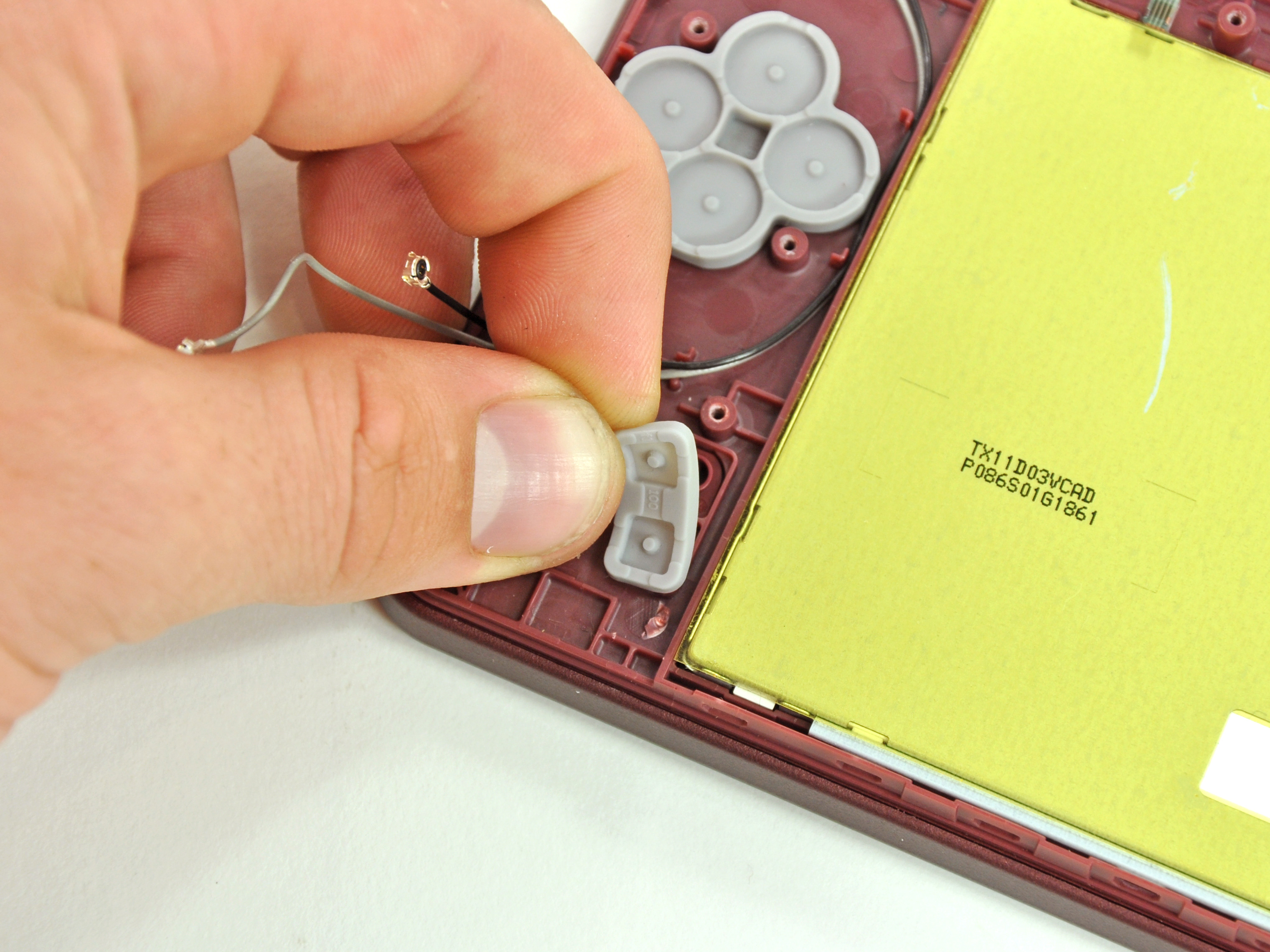

Installing Nintendo DSi XL Start/Select Buttons
Replace or repair faulty or sticky start and select buttons.

  • Close the display and turn the DSi XL over.
  • Lift the lower case from the front edge.
  • Rotate the lower case away from the DSi.
  • The lower case cannot be completely removed yet, since it is still connected to the motherboard.
Image #1 Image #2
Add Note Edit Step 7  ¶
  • Using a spudger, pry the SD card/right shoulder button connector off its socket.
  • Pry the volume button/left shoulder button connector off its socket on the motherboard with a spudger.
Image #1
Add Note Edit Step 8 — Motherboard  ¶
  • Use a spudger to pry the microphone cable off the motherboard.
  • Pry from underneath the cable.
