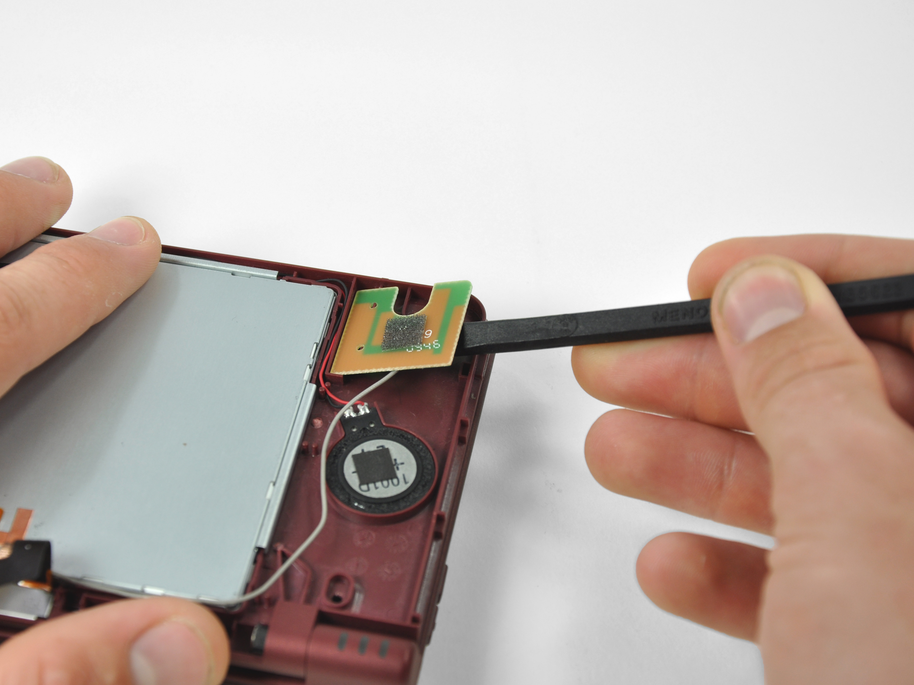

  • Insert a spudger into the gap between the front and rear bezel
  • Rotate the spudger away from the DSi XL, prying the two bezels apart.
Image #1
