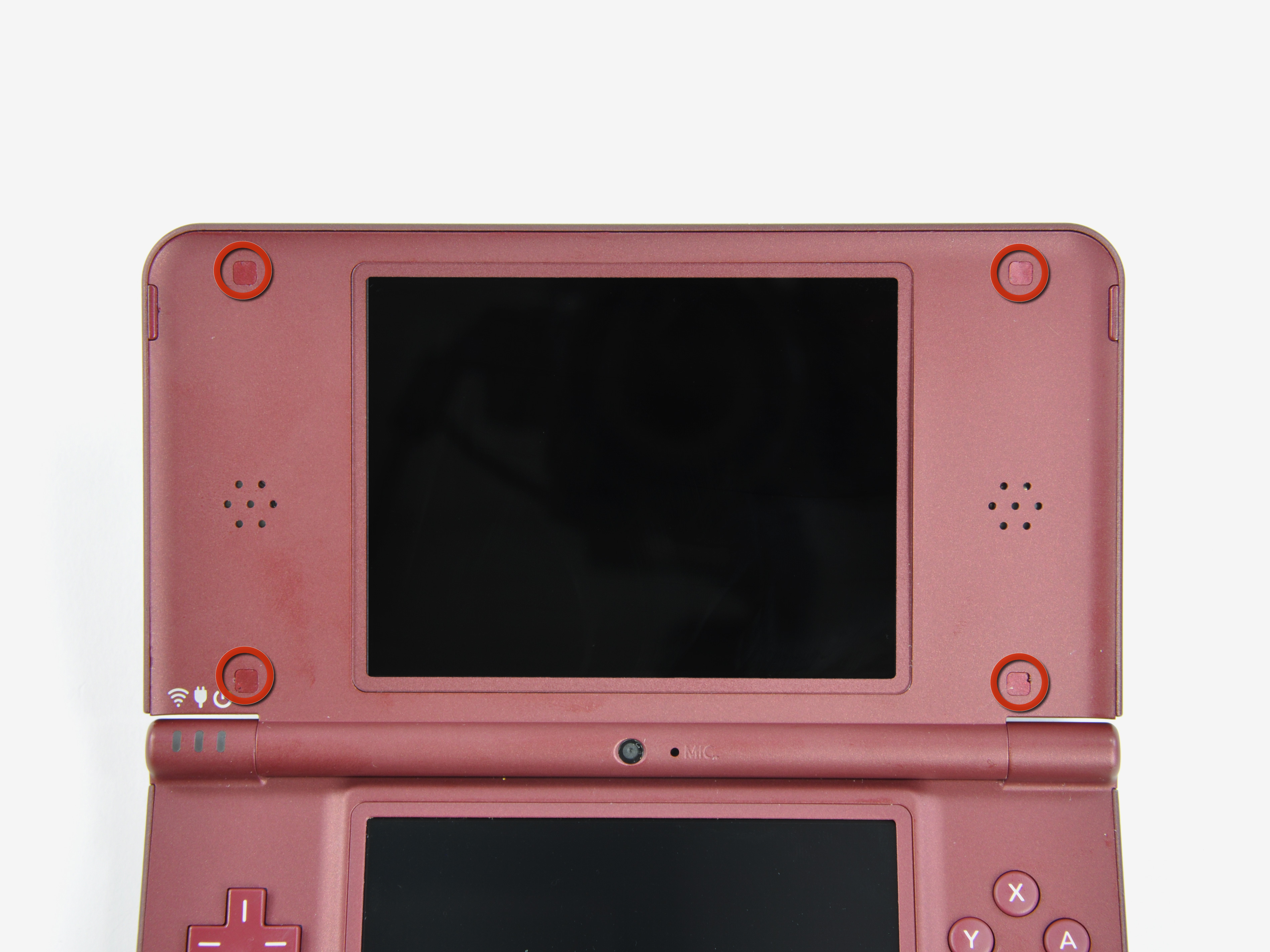

  • Use a push pin to remove the four plastic screw covers on the front bezel.
Image #1
