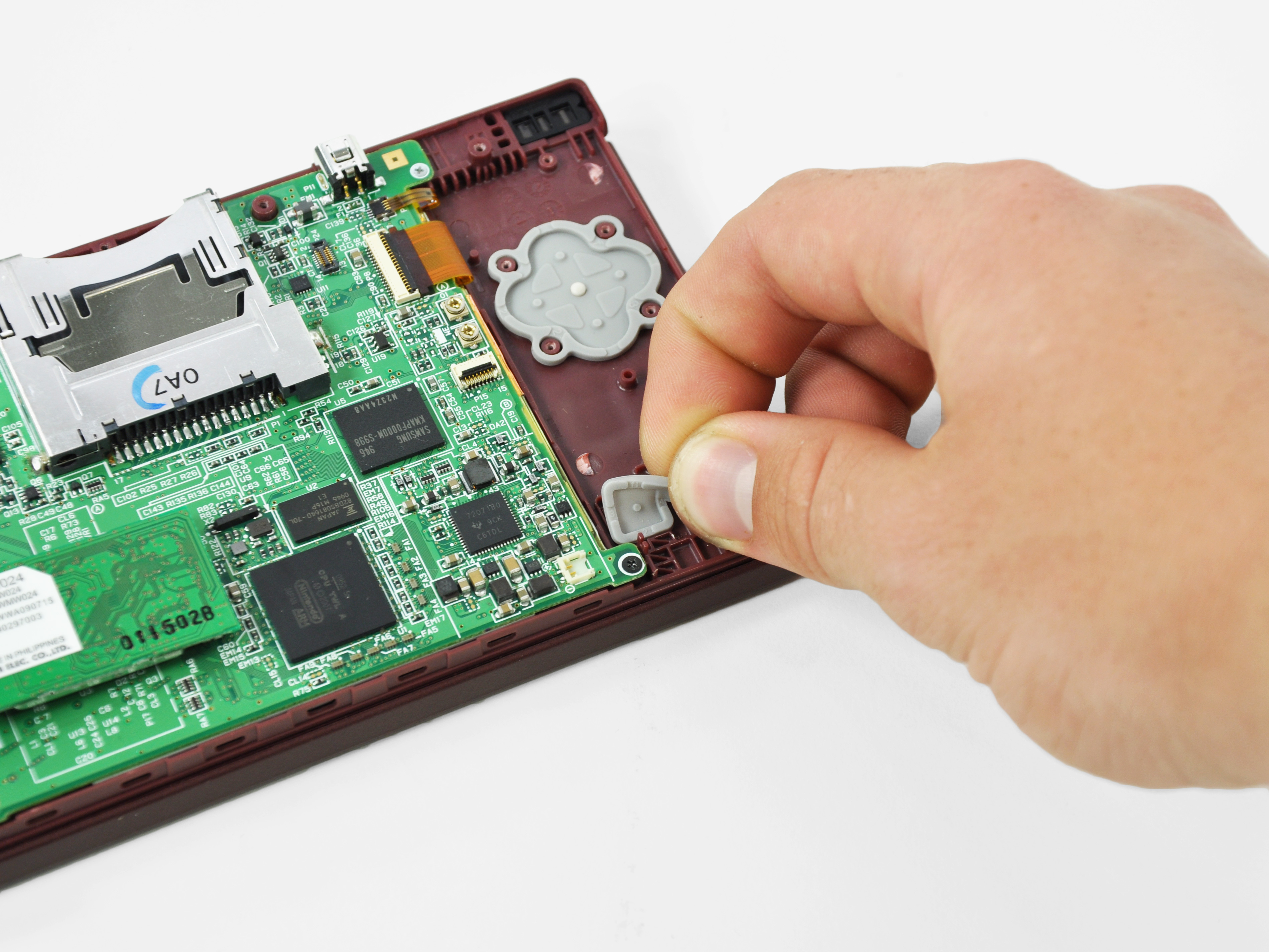

  • Using a spudger, pry the SD card/right shoulder button connector off its socket.
  • Pry the volume button/left shoulder button connector off its socket on the motherboard with a spudger.
Image #1 Image #2
Add Note Edit Step 8 — Power Board  ¶
  • Using the flat end of a spudger, flip up the retaining flap on the ZIF connector for the D-pad/power button cable.
  • With the pointed end of the spudger, pull the D-pad/power button cable from its connector on the motherboard.
