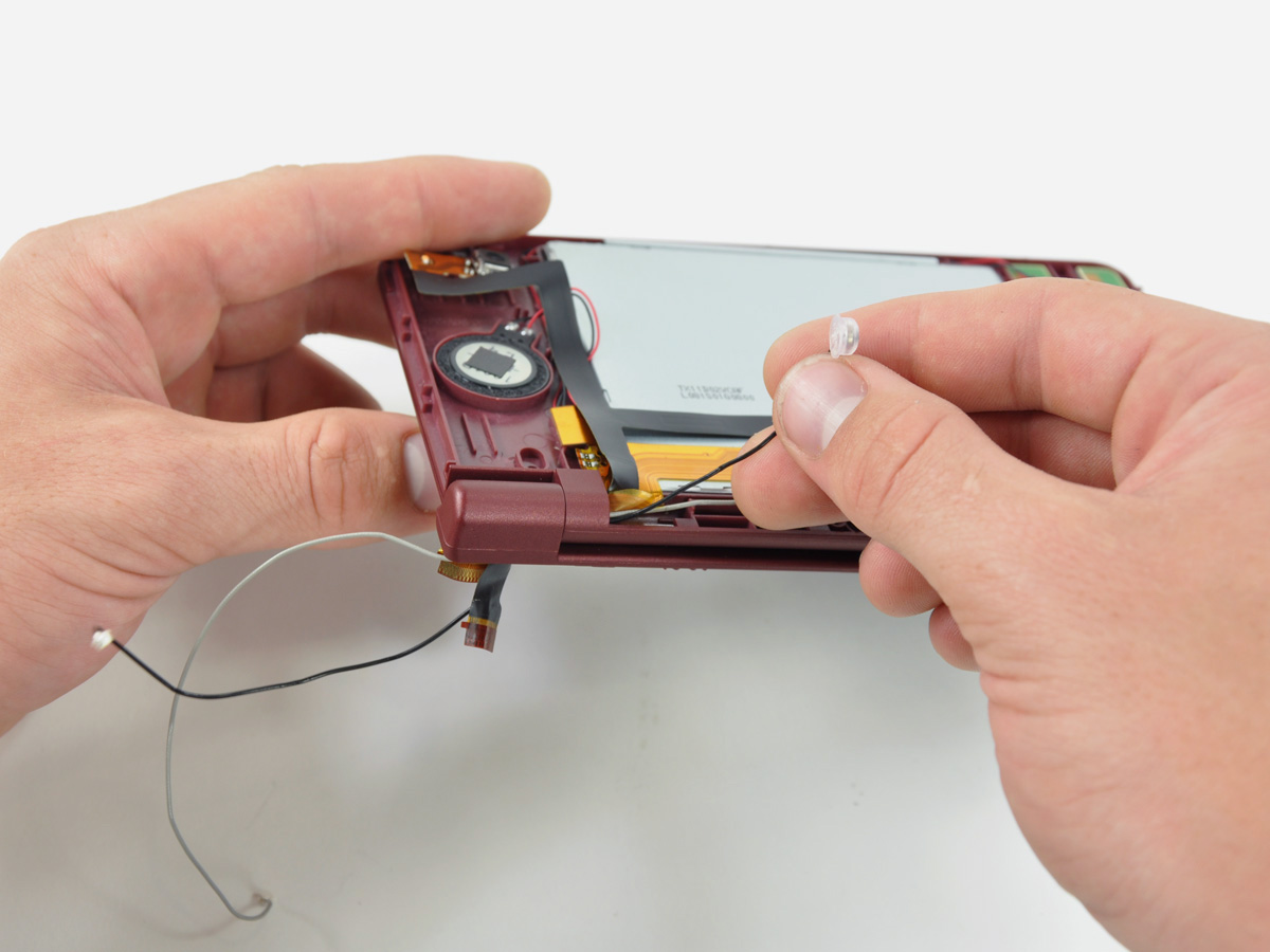

Add Note Edit Step 8 — Wi-Fi Board  ¶
  • Lift the Wi-Fi board up off its socket on the motherboard.
  • Do not attempt to completely remove the Wi-Fi board yet. It is attached to the motherboard by an antenna cable.
