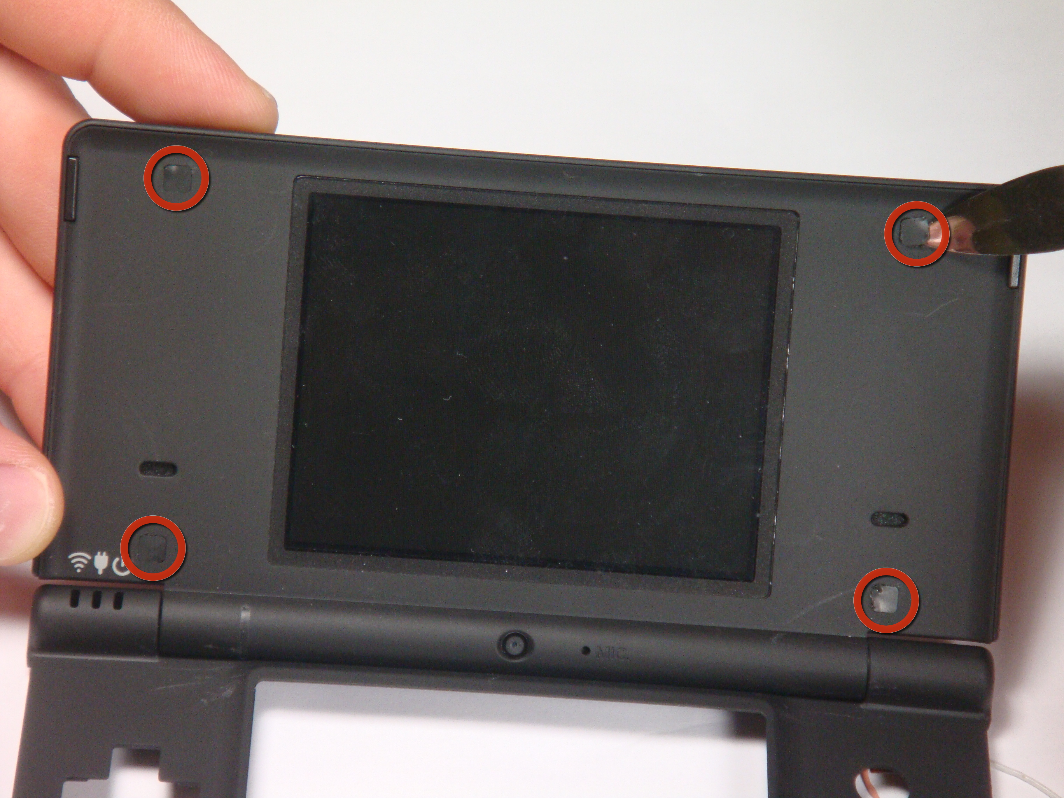

Add Note Edit Step 8 — Top LCD Screen  ¶
  • To make the repair easier, we recommend removing the bottom LCD screen prior to replacing the top LCD screen.
  • Using a spudger, or similar tool, pry out the 4 square screw covers.
