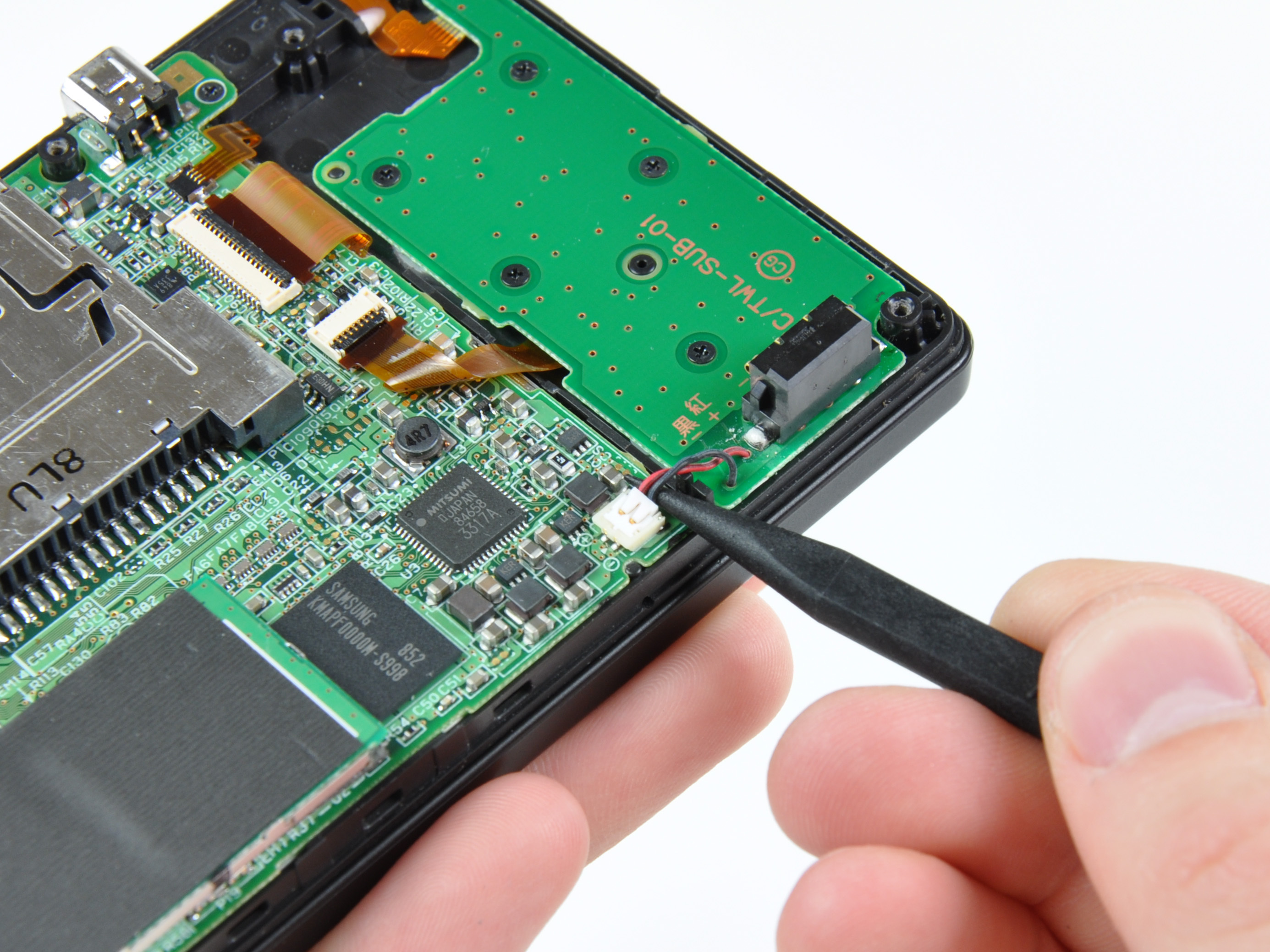

Add Note Edit Step 7 — Power Board  ¶
  • Use the tip of a spudger to pry the power board connector out of its socket on the motherboard.
Image #1 Image #2
