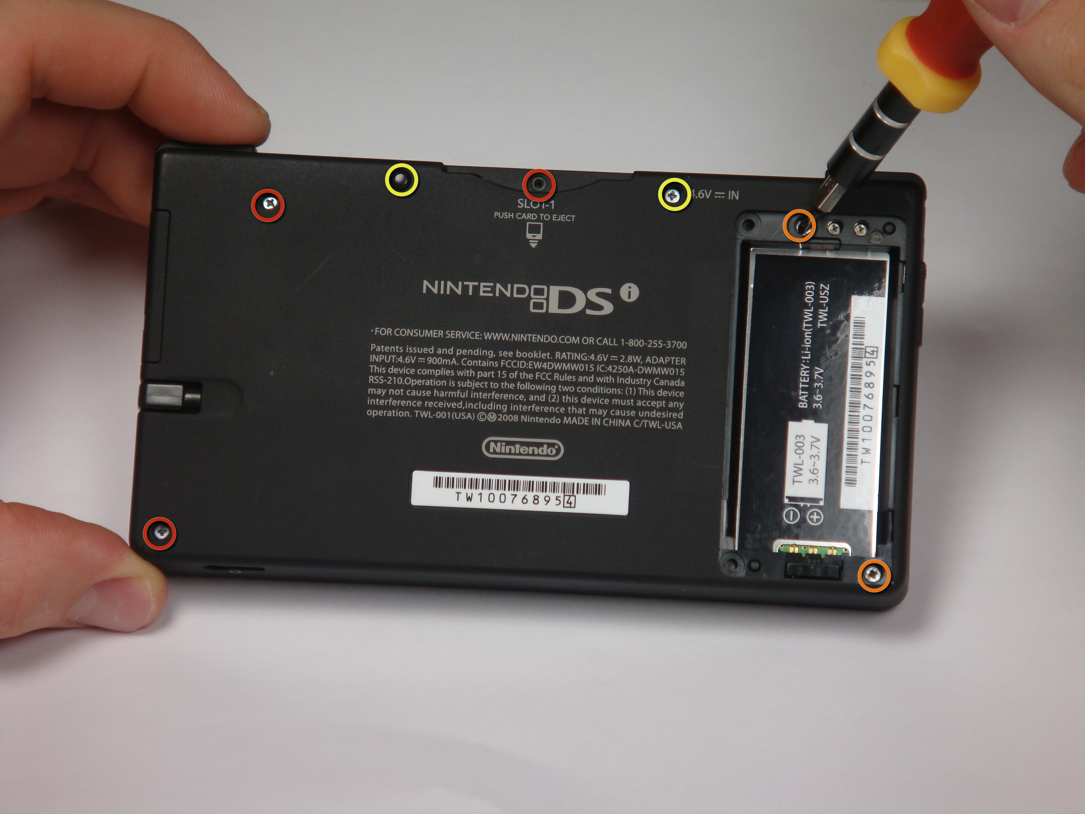

  • Loosen the two captive screws on the battery panel, and lift the panel up to remove it.
Image #1

  • Remove the following screws securing the lower case to the body of the DSi:
    • Six 5.2 mm Phillips screws.
    • One 2.7 mm Phillips screw.
Image #1 Image #2 Image #3
