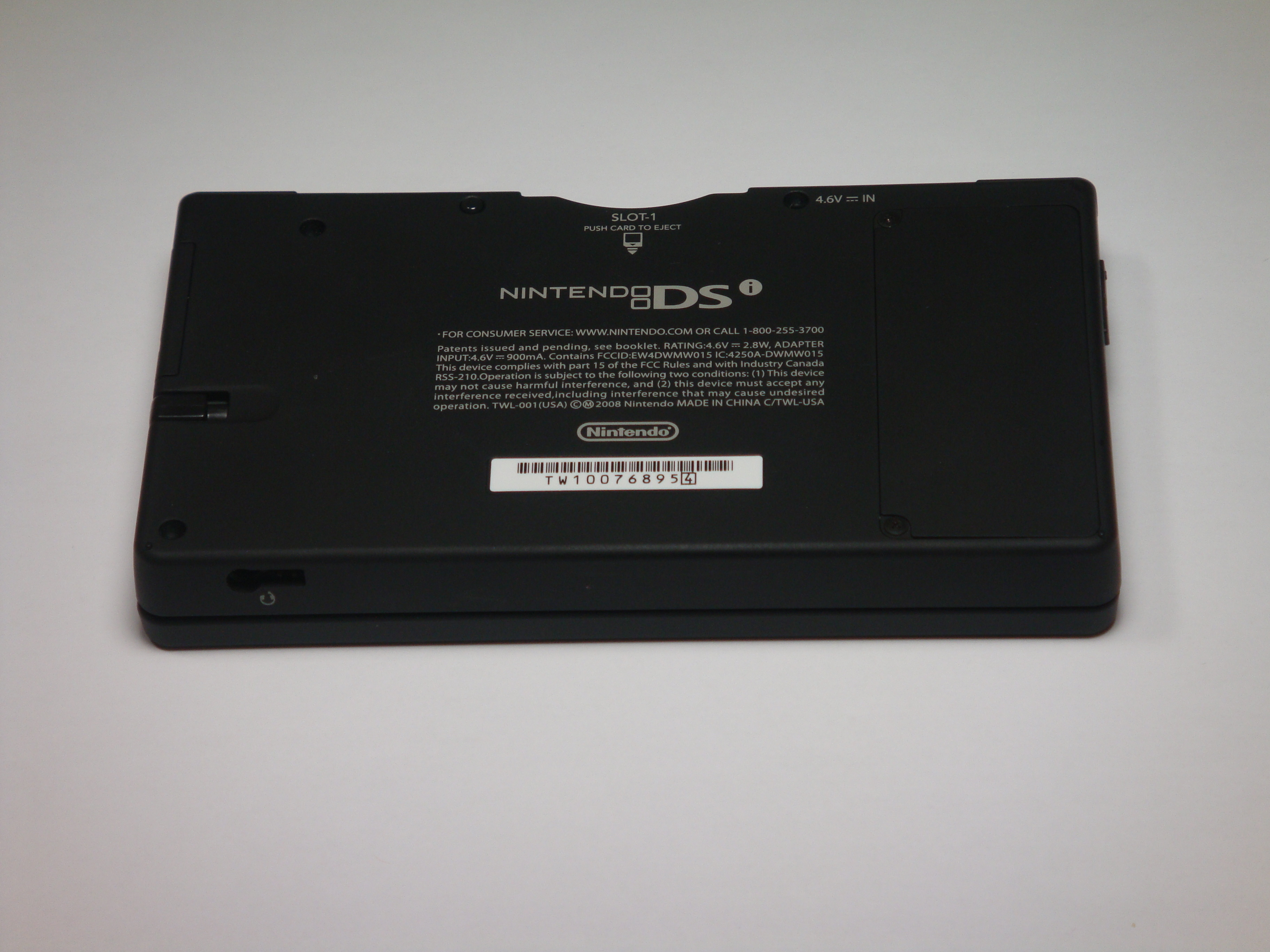

  • Loosen the two captive screws on the battery panel, and lift the panel up to remove it.
Image #1
Add Note Edit Step 2  ¶
  • Place a spudger (or fingernail) at the topside of the battery (near the L button) and lift up to remove the battery.
