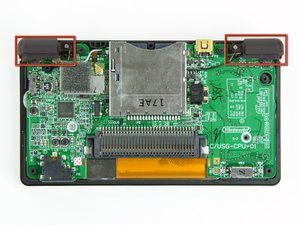

Add Note Edit Step 7 — Trigger Buttons  ¶
  • Lift both trigger buttons out of the DS Lite.
  • The trigger buttons are held in very loosely by small metal pegs and springs. Don't lose track of these pieces.
  • The second picture shows the correct configuration of the trigger assembly for reassembly purposes.
