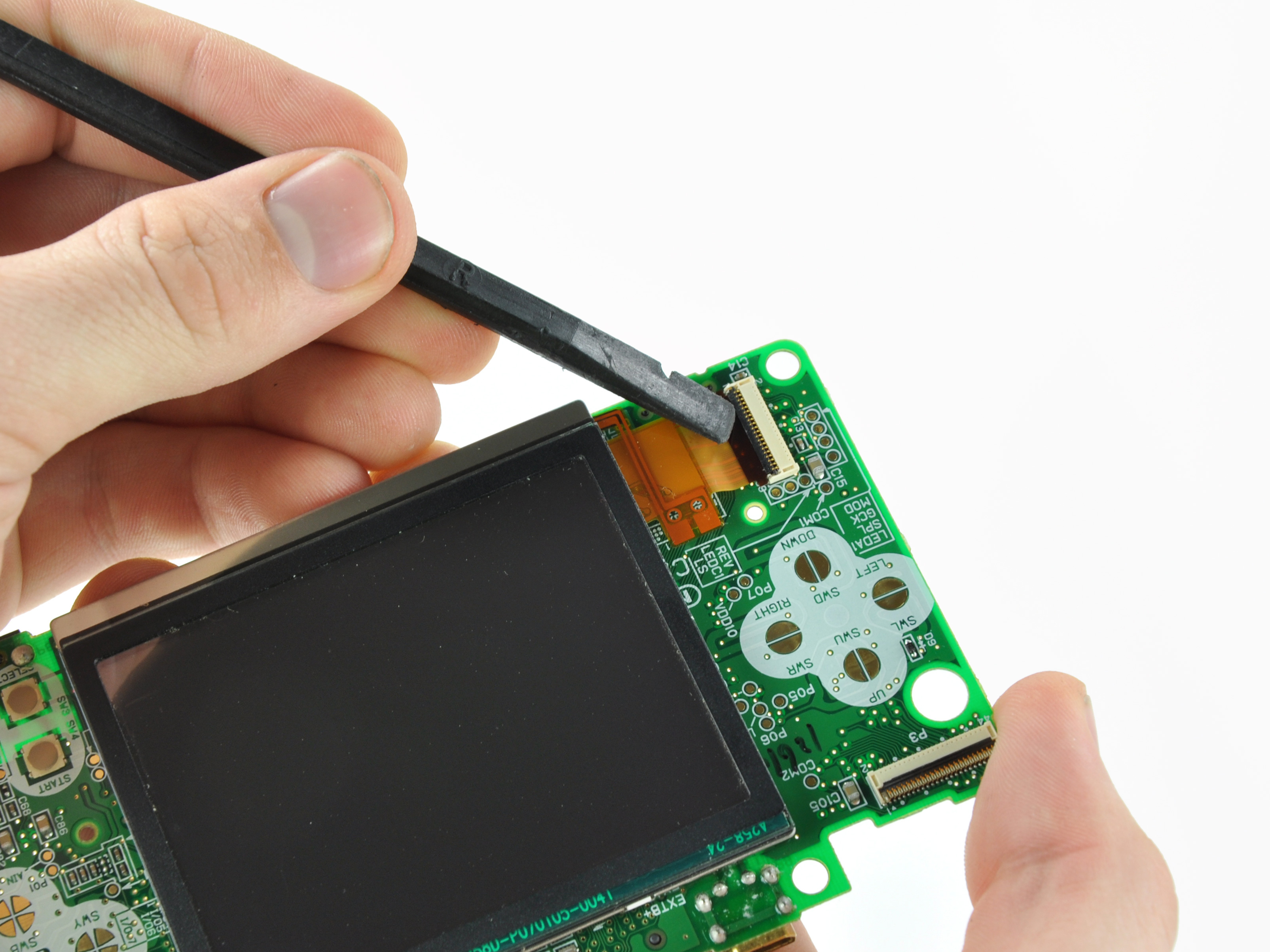

Add Note Edit Step 1 — Lower LCD Assembly  ¶
  • Use your fingernail or the edge of a plastic opening tool to carefully flip up the lower LCD ribbon cable retaining flap.
  • Make sure you are flipping up the retaining flap, not the socket itself.
  • Pull the lower LCD assembly straight away to separate the lower LCD ribbon cable from its socket on the motherboard.
  • Remove the lower LCD assembly from the motherboard.
