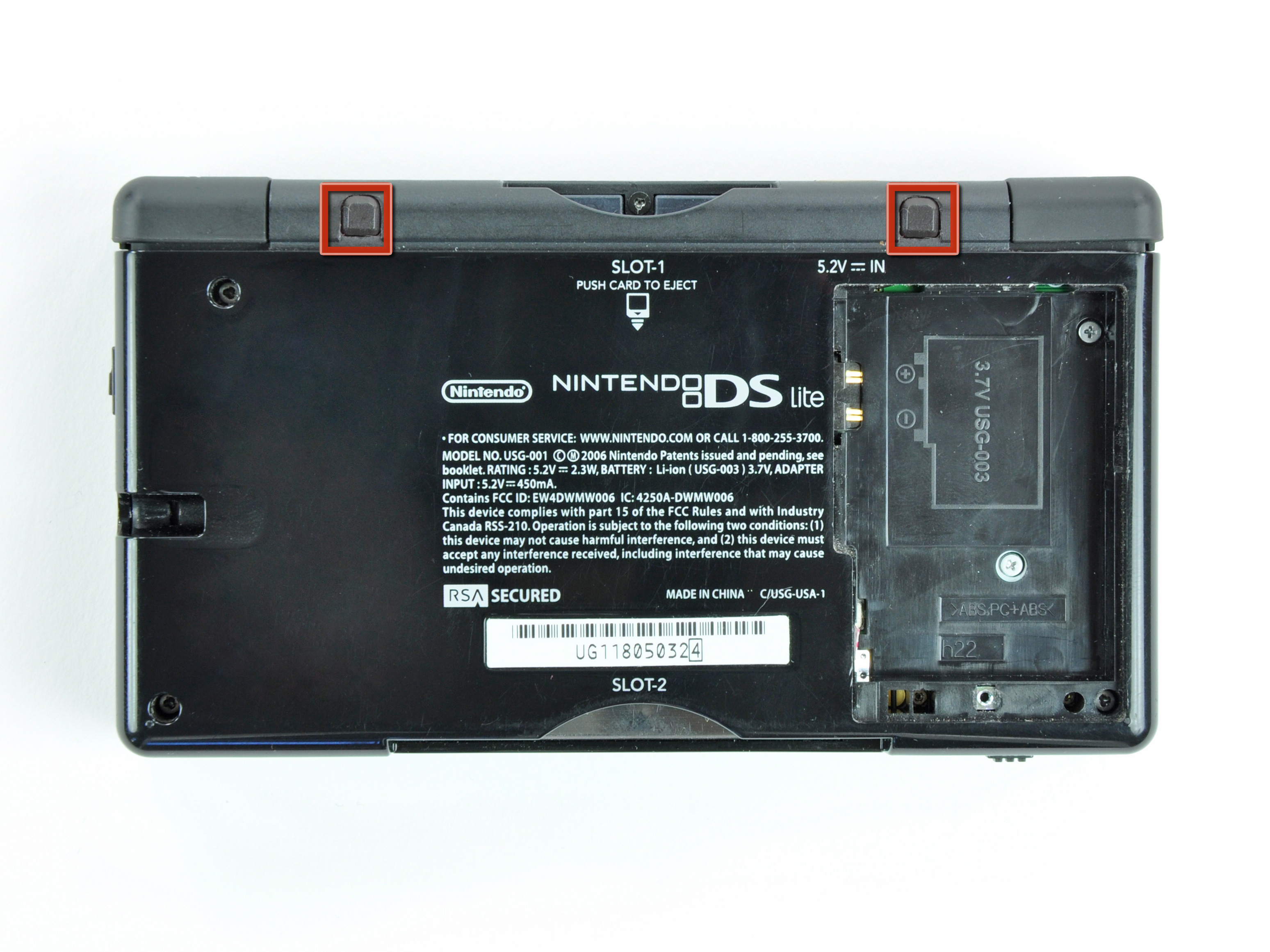

  • Use the tip of a spudger to pry both rubber feet off the DS Lite.
Image #1
