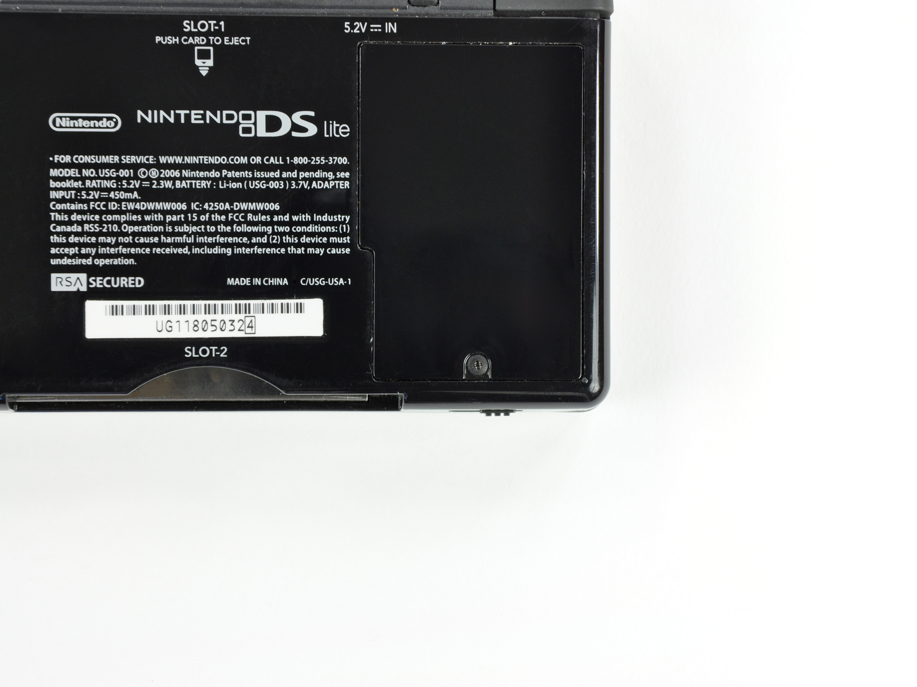

Has your DS Lite battery stopped providing the game time you deserve? Replace the battery to free yourself from the wall charger.
Image #1 Image #2
  • Unscrew the Phillips screw securing the battery cover to the lower case.
  • The screw remains captive to the battery cover.
  • Pry the battery cover upward with a spudger or fingernail, and lift out of the lower case.
Image #1
Add Note Edit Step 2  ¶
  • Wedge the edge of a spudger in between the side of the battery and the lower case housing and pry upward to dislodge the battery.
  • Remove the battery from the DS Lite.
