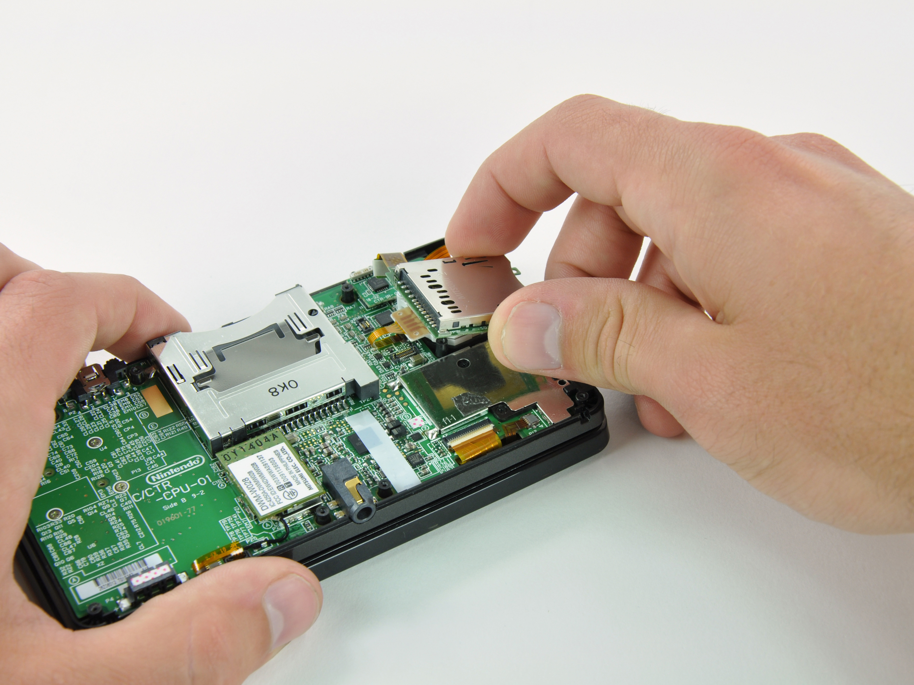

Add Note Edit Step 6 — SD Board  ¶
  • Remove the two 4.5 mm Phillips screws securing the SD board to the motherboard.
Image #1 Image #2
Add Note Edit Step 7  ¶
  • The connector for the SD board sits underneath the Circle Pad ribbon cable.
  • Use the flat end of a spudger to pry the SD board ribbon cable connector off its socket on the motherboard.
Image #1 Image #2 Image #3
Add Note Edit Step 8  ¶
  • Insert the flat end of a spudger between the SD board and the motherboard.
  • Run the spudger along the sides of the SD board to free it from the adhesive pad holding it in place.
  • Once completely freed, lift the SD board straight off the motherboard.
