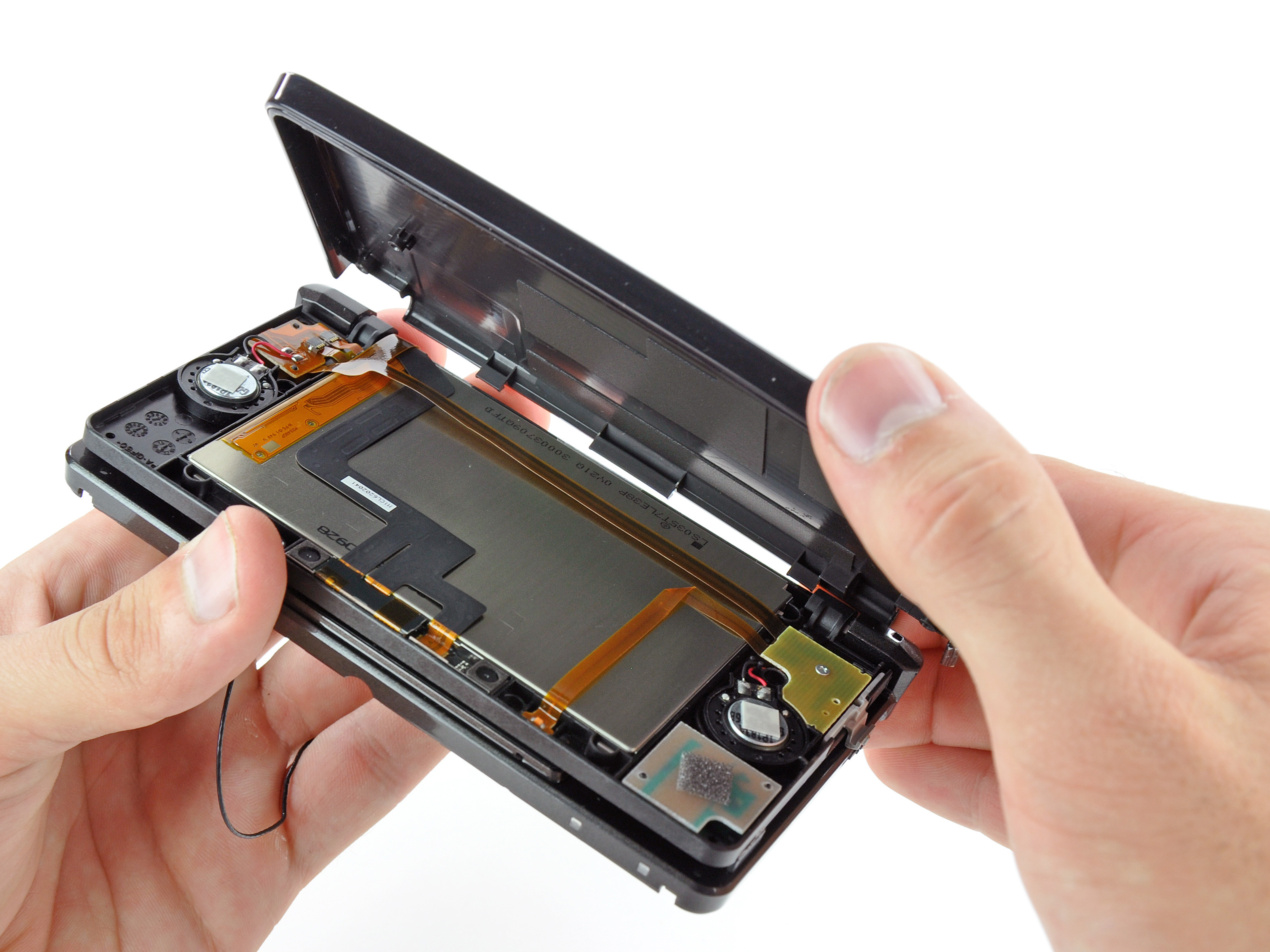

Installing Nintendo 3DS Rear Display Bezel
Nintendo 3DS rear display bezel replacement.
Outside case of your 3DS have a nasty crack in it? Replace the rear display bezel to make your Nintendo shiny again.
Image #1
Add Note Edit Step 1 — Back Cover  ¶
  • Unscrew the four Phillips screws along the top of the back cover.
  • The screws are held in place by locking washers, and will not come out of the back cover.
Image #1 Image #2
Add Note Edit Step 2  ¶
  • Hold the device in one hand and turn it over.
  • Grab the top edge of the back cover with your opposite hand so that the cover does not fall back into place.
  • Flip the 3DS over again so that the back cover is facing up.
  • Pull the back cover up and away from the rest of the device to remove it.
Image #1 Image #2 Image #3
  • Insert a plastic opening tool into the notch in the lower case above the battery.
  • Pry the battery up with the plastic opening tool.
  • Grab the top edge of the battery and lift it out of the lower case.
Image #1
Add Note Edit Step 4 — Lower Case  ¶
  • Remove the nine 6.3 mm black Phillips screws from the lower case.
  • Remove the 2.4 mm silver Phillips screw above the game cartridge slot.
Add Note Edit Step 5  ¶
  • Lift the bottom edge of the lower case off the rest of the 3DS.
  • There are still two ribbon cables connecting the mother board to the case, so be sure not to pull the lower case all the way off.
  • Use a plastic opening tool to pry the shoulder button ribbon cables off their sockets on the motherboard.
  • Remove the lower case from the device.
Image #1
Add Note Edit Step 6 — Circle Pad Joystick  ¶
  • Remove the two 7.7 mm Phillips screws securing the back of the Circle Pad to the motherboard.
Add Note Edit Step 7  ¶
  • Use the flat end of a spudger to pry the back of the Circle Pad off the motherboard.
  • Lift the Circle Pad joystick off the motherboard and lay it on its back so that the ribbon cable connector is accessible.
Add Note Edit Step 8  ¶
  • Use the flat end of a spudger or your fingernail to flip up the retaining flap on the Circle Pad ribbon cable ZIF socket.
  • Lift the Circle Pad joystick off the motherboard.
