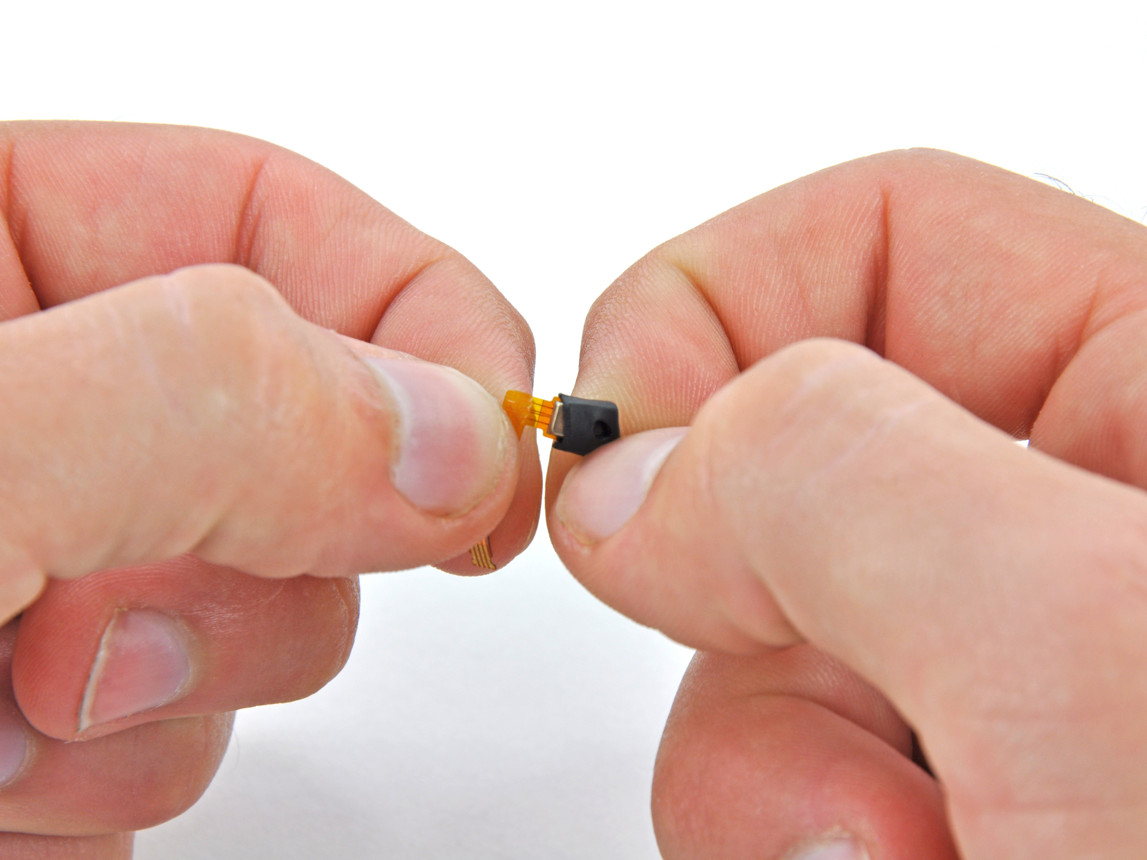

Add Note Edit Step 6 — Microphone  ¶
  • Grasp the microphone ribbon cable near the microphone with a pair of tweezers.
  • Pull the microphone straight up out of the upper case.
Image #1 Image #2
Add Note Edit Step 7  ¶
  • Use the flat end of a spudger or your fingernail to flip up the retaining flap on the Microphone ribbon cable ZIF socket.
Image #1 Image #2
Add Note Edit Step 8  ¶
  • Lift the microphone and its attached ribbon cable off the motherboard.
  • If your replacement microphone doesn't come with a silicone cover, peel the cover off the original one and reuse it.
