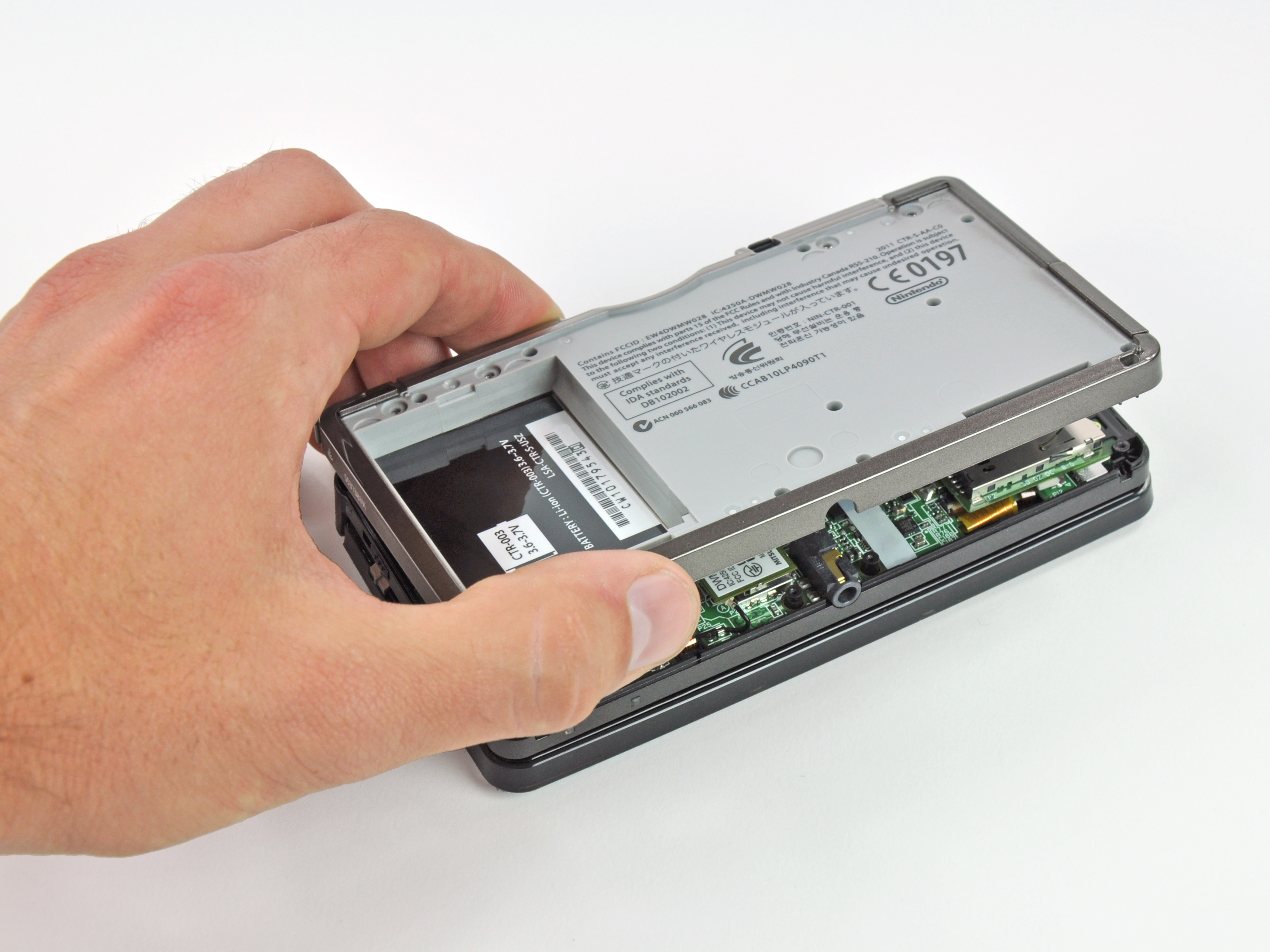

Add Note Edit Step 4 — Lower Case  ¶
  • Remove the nine 6.3 mm black Phillips screws from the lower case.
  • Remove the 2.4 mm silver Phillips screw above the game cartridge slot.
Image #1 Image #2 Image #3
Add Note Edit Step 5  ¶
  • Lift the bottom edge of the lower case off the rest of the 3DS.
  • There are still two ribbon cables connecting the mother board to the case, so be sure not to pull the lower case all the way off.
  • Use a plastic opening tool to pry the shoulder button ribbon cables off their sockets on the motherboard.
  • Remove the lower case from the device.
