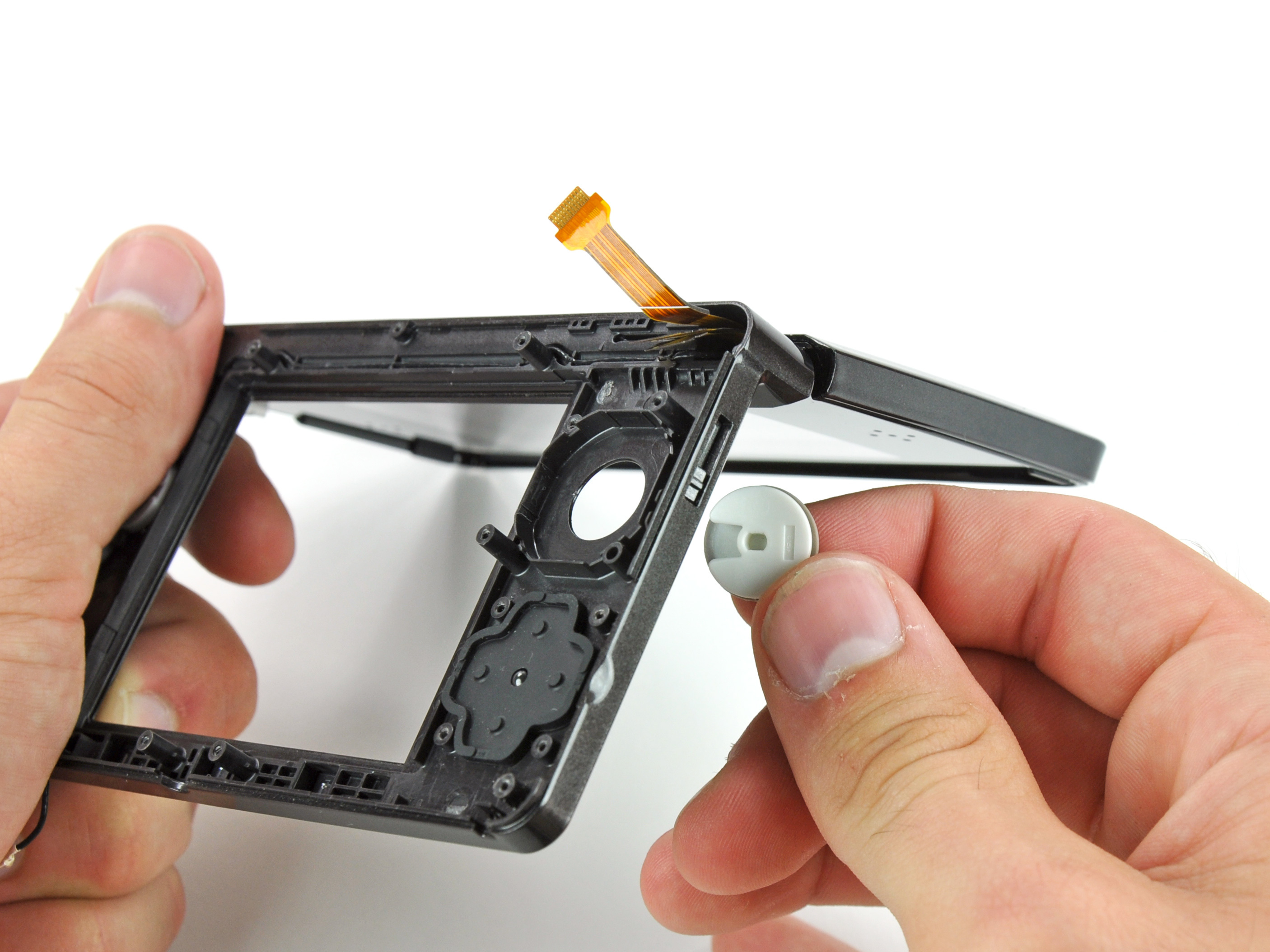

Add Note Edit Step 6 — Circle Pad Joystick  ¶
  • Remove the two 7.7 mm Phillips screws securing the back of the Circle Pad to the motherboard.
Image #1 Image #2 Image #3
Add Note Edit Step 7  ¶
  • Use the flat end of a spudger to pry the back of the Circle Pad off the motherboard.
  • Lift the Circle Pad joystick off the motherboard and lay it on its back so that the ribbon cable connector is accessible.
Add Note Edit Step 8  ¶
  • Use the flat end of a spudger or your fingernail to flip up the retaining flap on the Circle Pad ribbon cable ZIF socket.
  • Lift the Circle Pad joystick off the motherboard.
