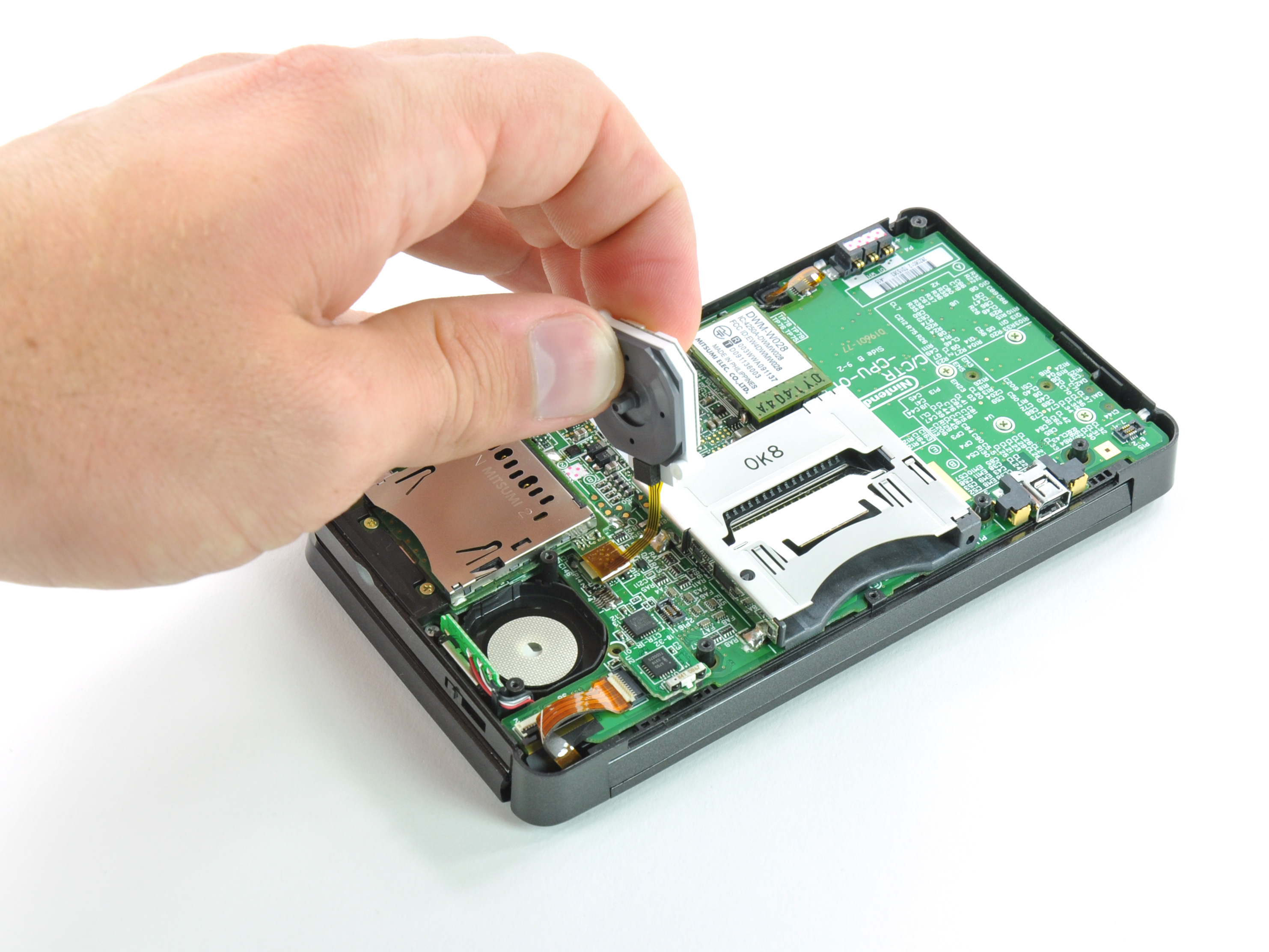

  • Remove the two 7.7 mm Phillips screws securing the back of the Circle Pad to the motherboard.
Image #1 Image #2 Image #3
Add Note Edit Step 2  ¶
  • Use the flat end of a spudger to pry the back of the Circle Pad off the motherboard.
  • Lift the Circle Pad joystick off the motherboard and lay it on its back so that the ribbon cable connector is accessible.
Add Note Edit Step 3  ¶
  • Use the flat end of a spudger or your fingernail to flip up the retaining flap on the Circle Pad ribbon cable ZIF socket.
  • Lift the Circle Pad joystick off the motherboard.
Image #1 Image #2
Add Note Edit Step 4  ¶
  • To decrease the chance of losing it during repairs, you may want to remove the two thin pads underneath the Circle Pad joystick.
  • Use a spudger or screwdriver to lift the pads up and remove them from the device.
