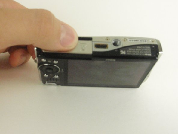

  • Turn the camera upside down to find the battery door.
Image #1

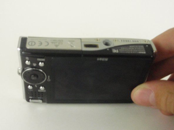

Add Note Edit Step 2  ¶
  • Slide the battery door in the direction of the arrow, toward the LCD screen. The door will then swing open.

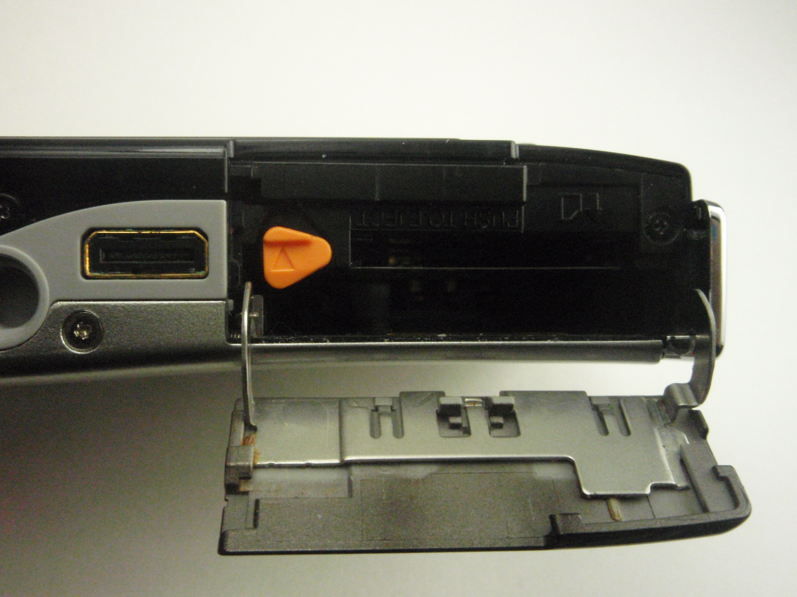

Image #1
Add Note Edit Step 3  ¶
  • Push memory card further into the camera. This will release the memory card making it available to remove.
