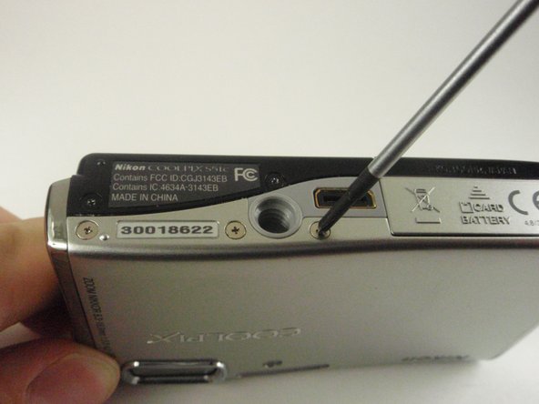

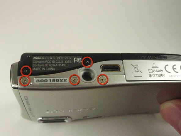

  • Turn over camera to find 5 apparent screws.
Image #1
Add Note Edit Step 2  ¶
  • Remove all 5 screws from the bottom of the camera and store them carefully.

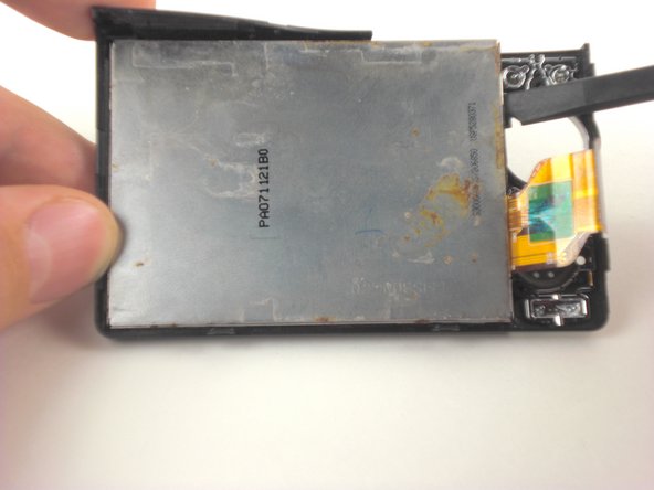

  • On back of LCD screen, locate the three screws underneath the ribbon and remove them.
Image #1 Image #2
Add Note Edit Step 8  ¶

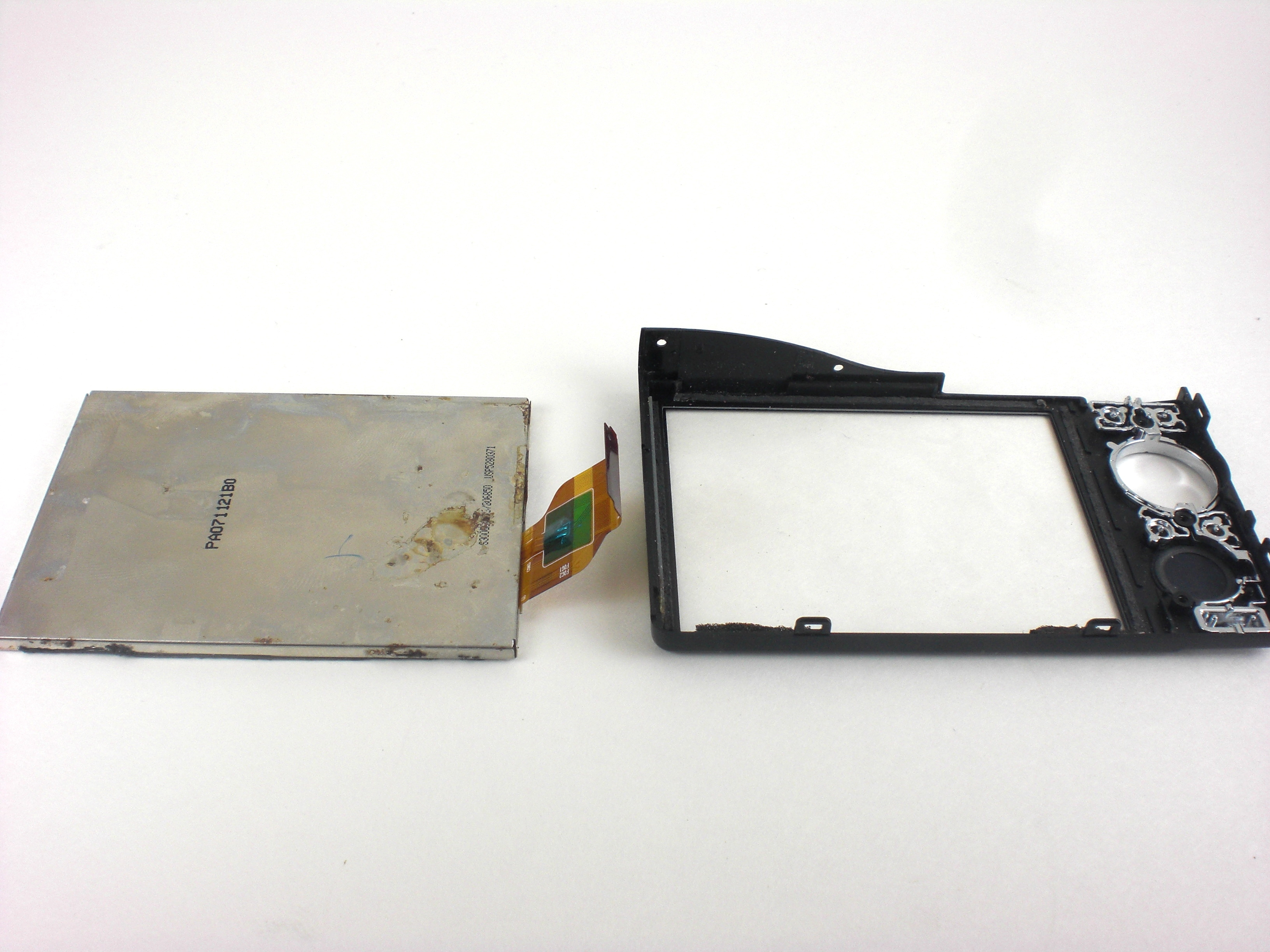

  • Take out rectangular component on the side where the screws were.
  • Pry apart screen from back casing using the spudger.
