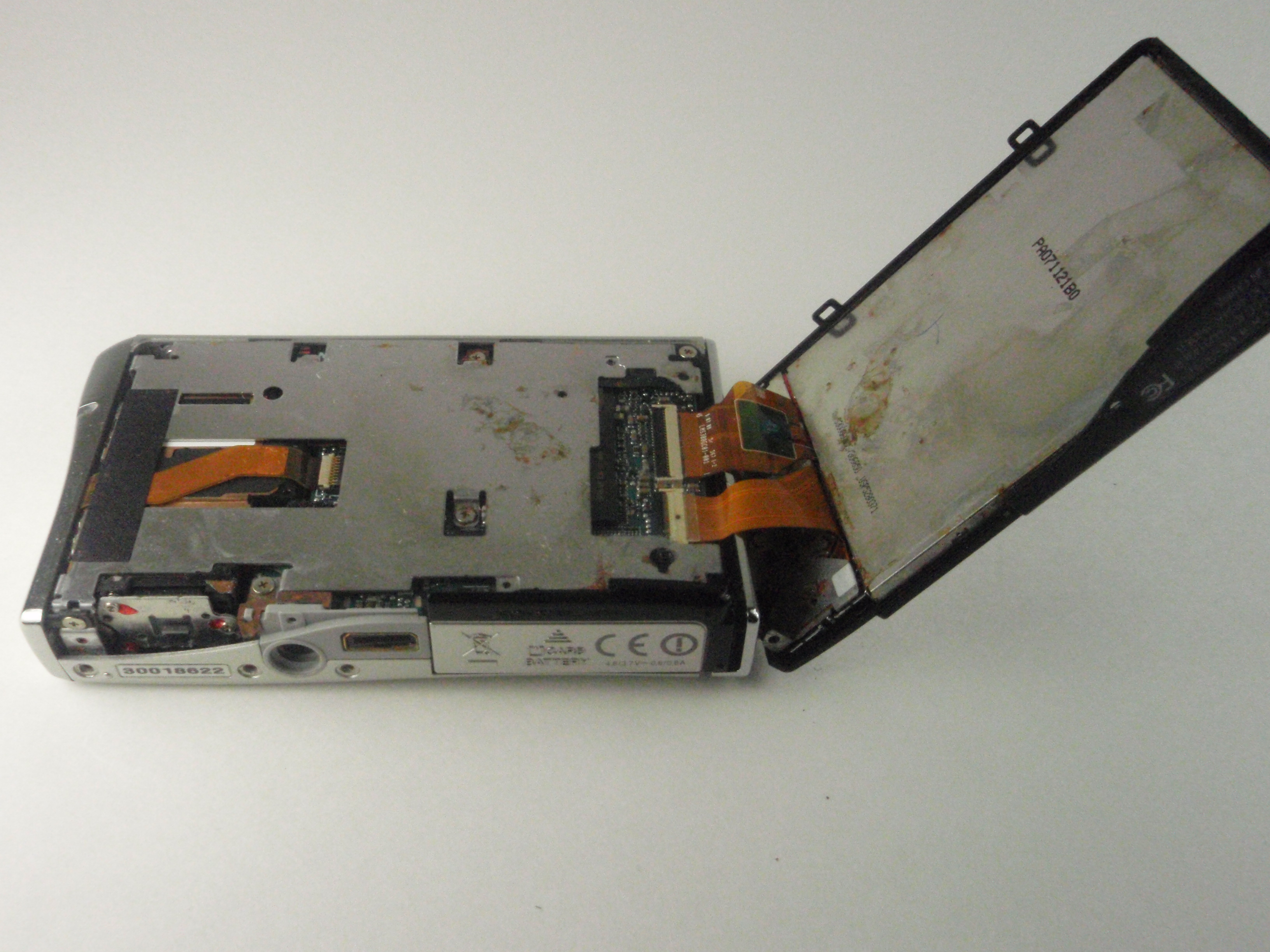

The following steps will allow you to remove the back cover for replacement or repair.
  • Author: Ryan
  • Difficulty: Moderate
  1. You will need a #00 phillip's head screwdriver and a black spudger (or equivalent tool)
Image #1
Add Note Edit Step 1 — Back Cover  ¶
  • Turn over camera to find 5 apparent screws.
Image #1
Add Note Edit Step 2  ¶
  • Remove all 5 screws from the bottom of the camera and store them carefully.
Image #1
Add Note Edit Step 3  ¶
  • Open battery door by sliding it in the direction of the arrow to reveal a hidden screw on the opposite side of orange lever. Remove this screw.
Image #1
Add Note Edit Step 4  ¶
  • Rotate camera to find side panel with lanyard attachment. Detach side panel by lifting bottom corner slightly with the spudger.
Image #1
Add Note Edit Step 5  ¶
  • Lift the back cover, being careful not to rip the orange cables between the camera and the back cover.
Image #1
Add Note Edit Step 6  ¶
  • With back cover lifted, lift the black flap that connects the ribbon to the motherboard with the spudger and carefully remove the back cover.
