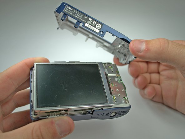

  • Remove all six 4.3mm silver screws along the perimeter of the camera using the Phillips #00 screwdriver.
  • There is one screw hidden under the AV cover that also needs to be removed.
Image #1
Add Note Edit Step 3  ¶
  • Pry the back cover from the left side of the camera. Remove the cover gently.
Image #1

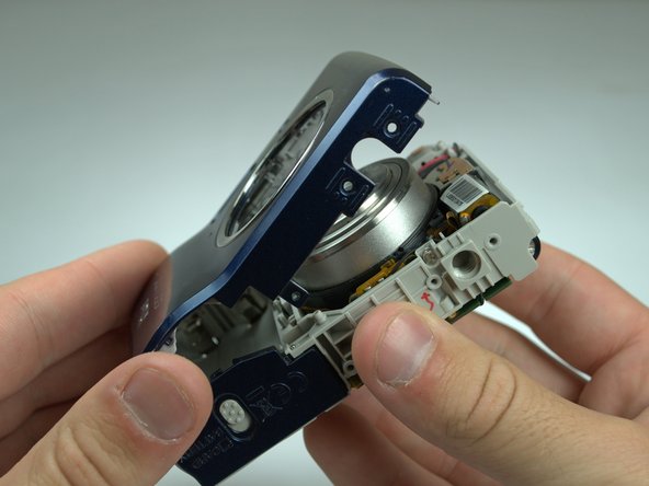

Add Note Edit Step 4 — Front Cover  ¶
  • Pry back the front cover of the camera starting from the right side.

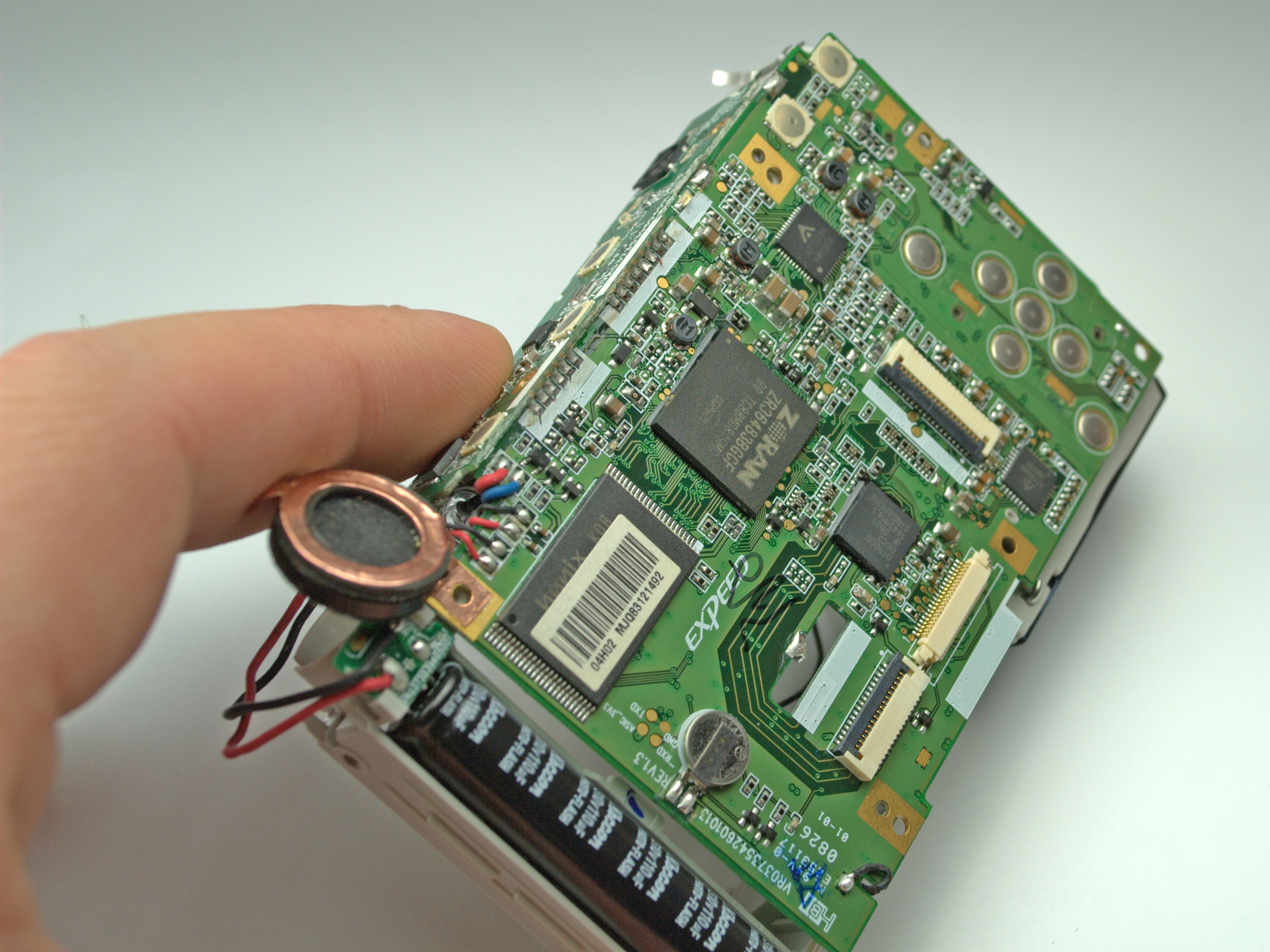

Add Note Edit Step 5 — LCD Screen  ¶
  • Remove the tape on the right side of the LCD screen.
  • Gently lift the LCD screen from its base.
  • Don't tug on the screen because it is still connected to the logic board.
Image #1
Add Note Edit Step 6  ¶
  • Lift the black latch connecting the LCD ribbon to the logic board.
  • Gently pull the LCD ribbon out.
Image #1 Image #2

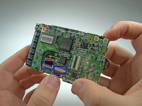

Add Note Edit Step 8  ¶
  • Gently pull the lens ribbon out.
