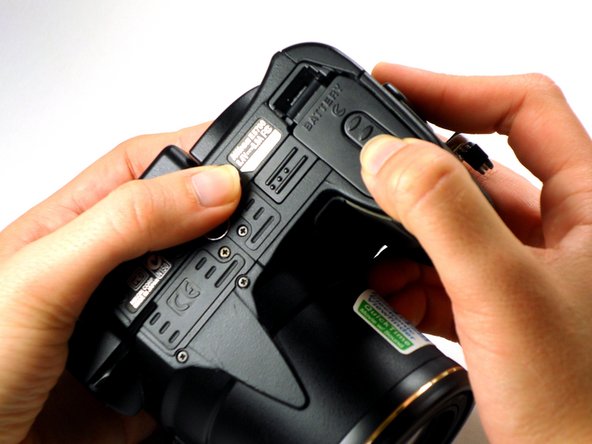

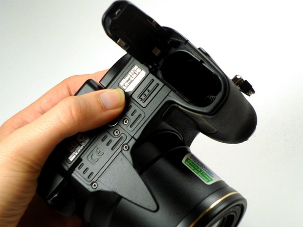

  • Use your finger tip to slide the battery release tab toward the battery symbol on the E5700.

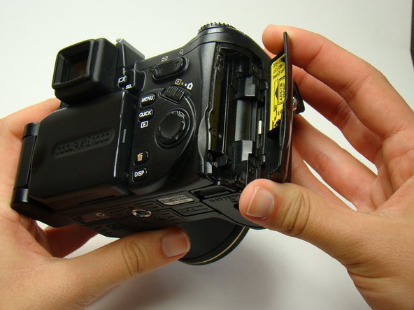

  • Open the battery door.
Image #1

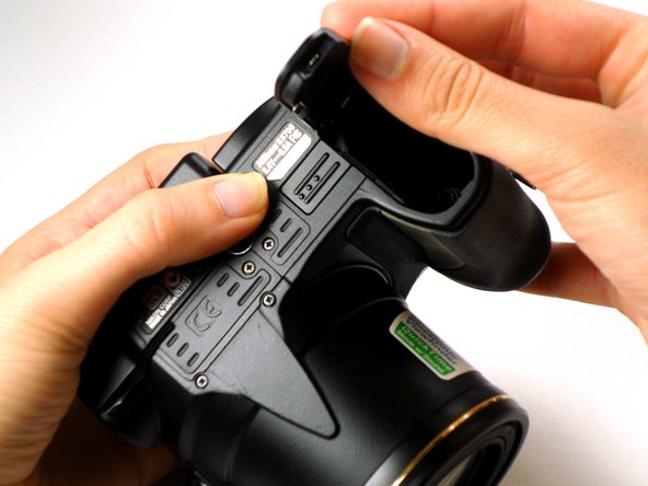

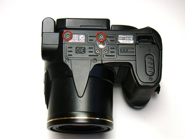

  • Turn to the bottom of the camera.
  • Remove the two Phillips screws located directly below the back monitor

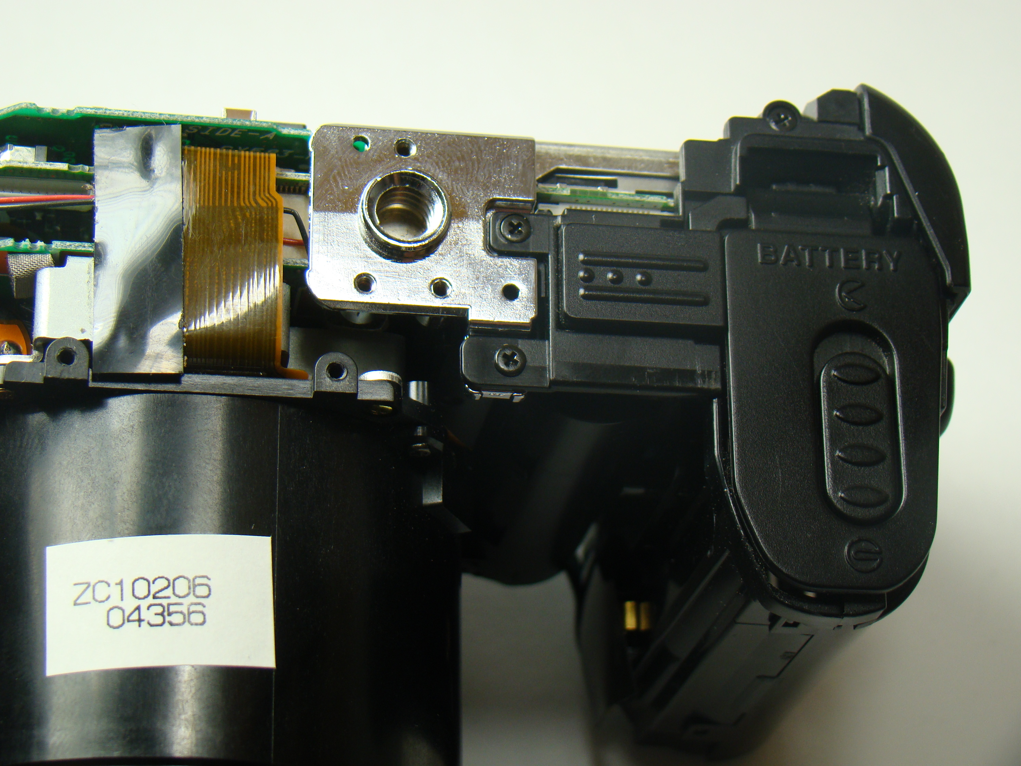

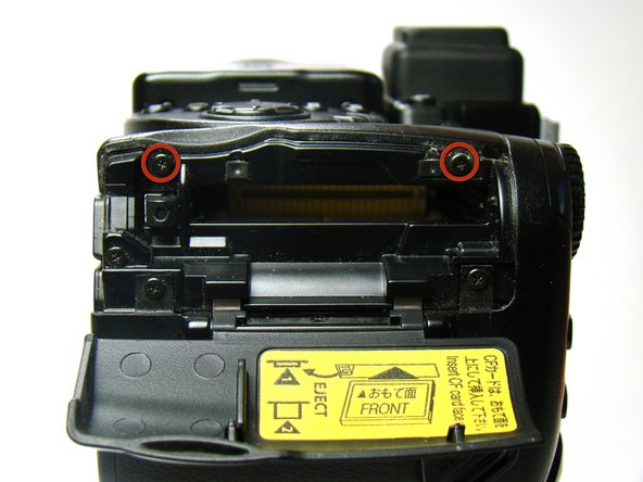

  • Turn the camera to the side with the memory card slot and open the compartment for the CF card.
  • Remove the top two Phillips screws closest to the back panel.

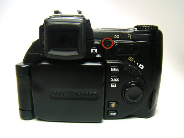

  • Turn to the back of the camera.
  • Remove the top most Phillips screw on the back panel.

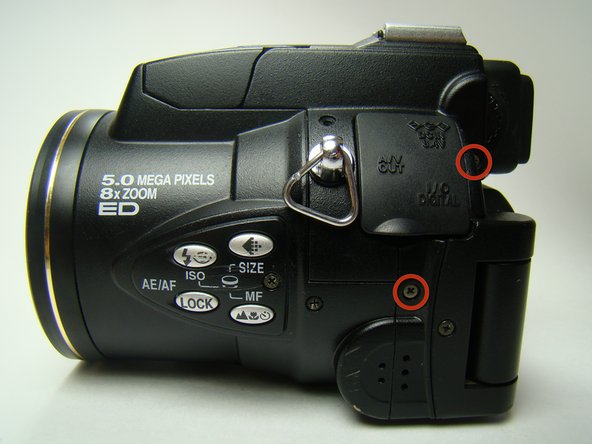

  • Turn to the last side of the back panel.
  • Remove the Phillips screw below the eyepiece.
  • Remove the Phillips screw located above the speaker.

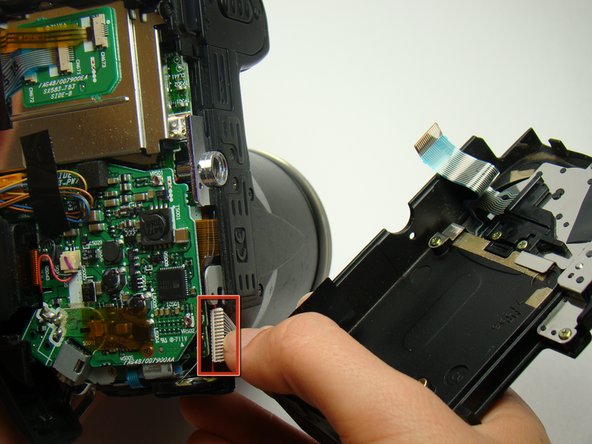

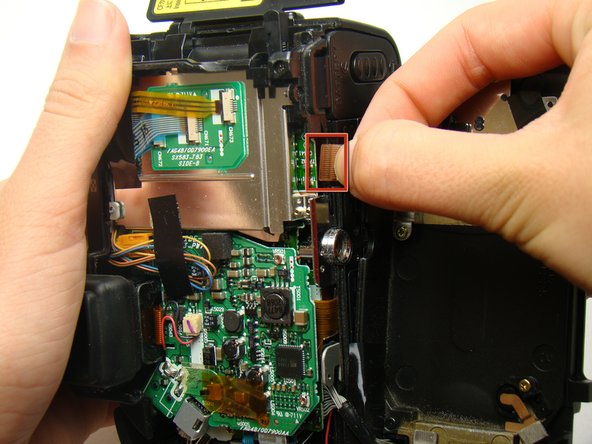

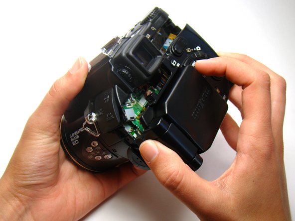

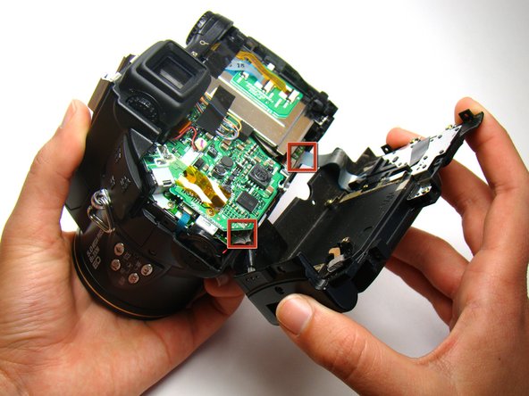

  • Gently begin to remove the back panel.
    • Caution: There are two bundles of wires connecting the back panel to the camera. Be sure not to pull too hard and yank these out.
Image #1 Image #2
Add Note Edit Step 8  ¶
  • Now gently unplug the two wires at the bottom of the panel.
