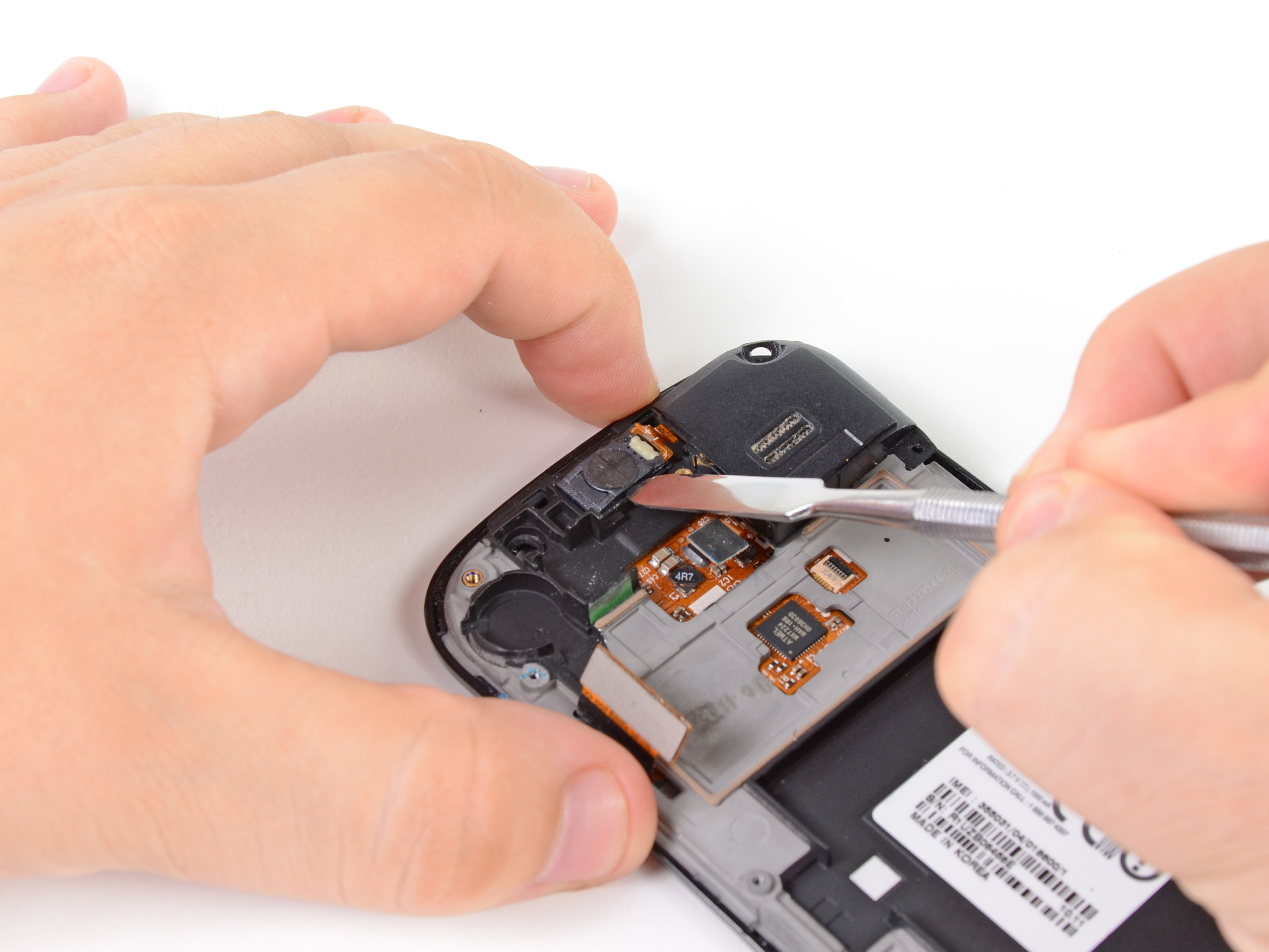

Image #1
Add Note Edit Step 1 — Speaker Assembly  ¶
  • Use the flat end of a metal spudger to dislodge the speaker from its recess in the front display assembly.
