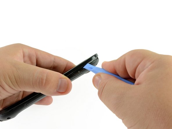

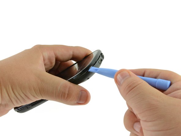

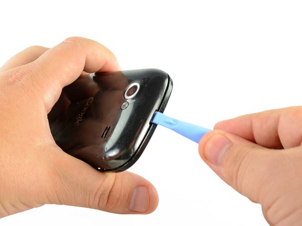

  • Gently insert a plastic opening tool between the rear panel and the inner rear frame near the rear-facing camera.
  • Use your plastic opening tool to pry up the rear case around the perimeter of the Nexus S.

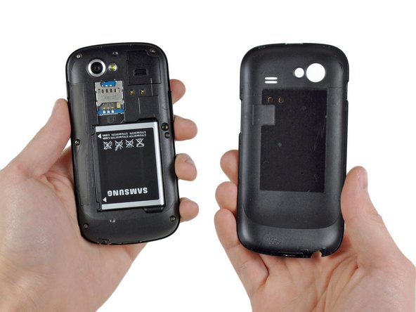

Add Note Edit Step 2  ¶
  • Remove the rear panel from the Nexus S.
Image #1

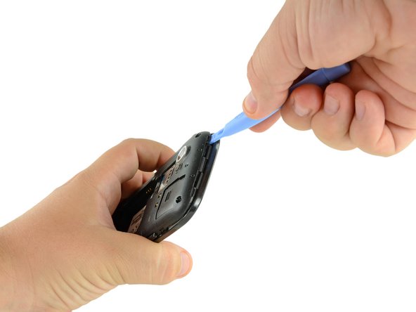

  • Using the edge of a plastic opening tool, lift the battery from the end closest to the headphone jack.
  • Remove the battery from the Nexus S.

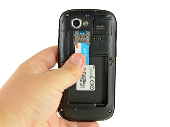

Add Note Edit Step 4 — SIM Card  ¶
  • Use your thumb to slide the SIM card downwards from the SIM card slot.
  • Remove the SIM card.

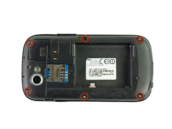

Add Note Edit Step 5 — Rear Inner Frame  ¶
  • Remove the six Phillips screws securing the rear inner frame to the inner case.

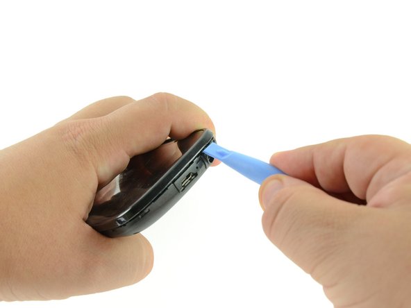

  • Insert the flat edge of a plastic opening tool in between the rear inner frame and the top left corner of the Nexus S.
  • Pry the opening tool upwards to pop the top right corner from the clips securing it to the inner assembly.

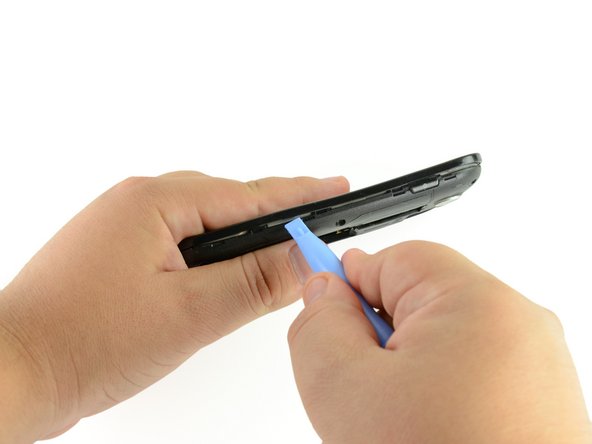

  • Insert the plastic opening tool to the right of the power button.
  • Slide the plastic opening tool downwards along the perimeter of the Nexus S to release the clips on the right side.
