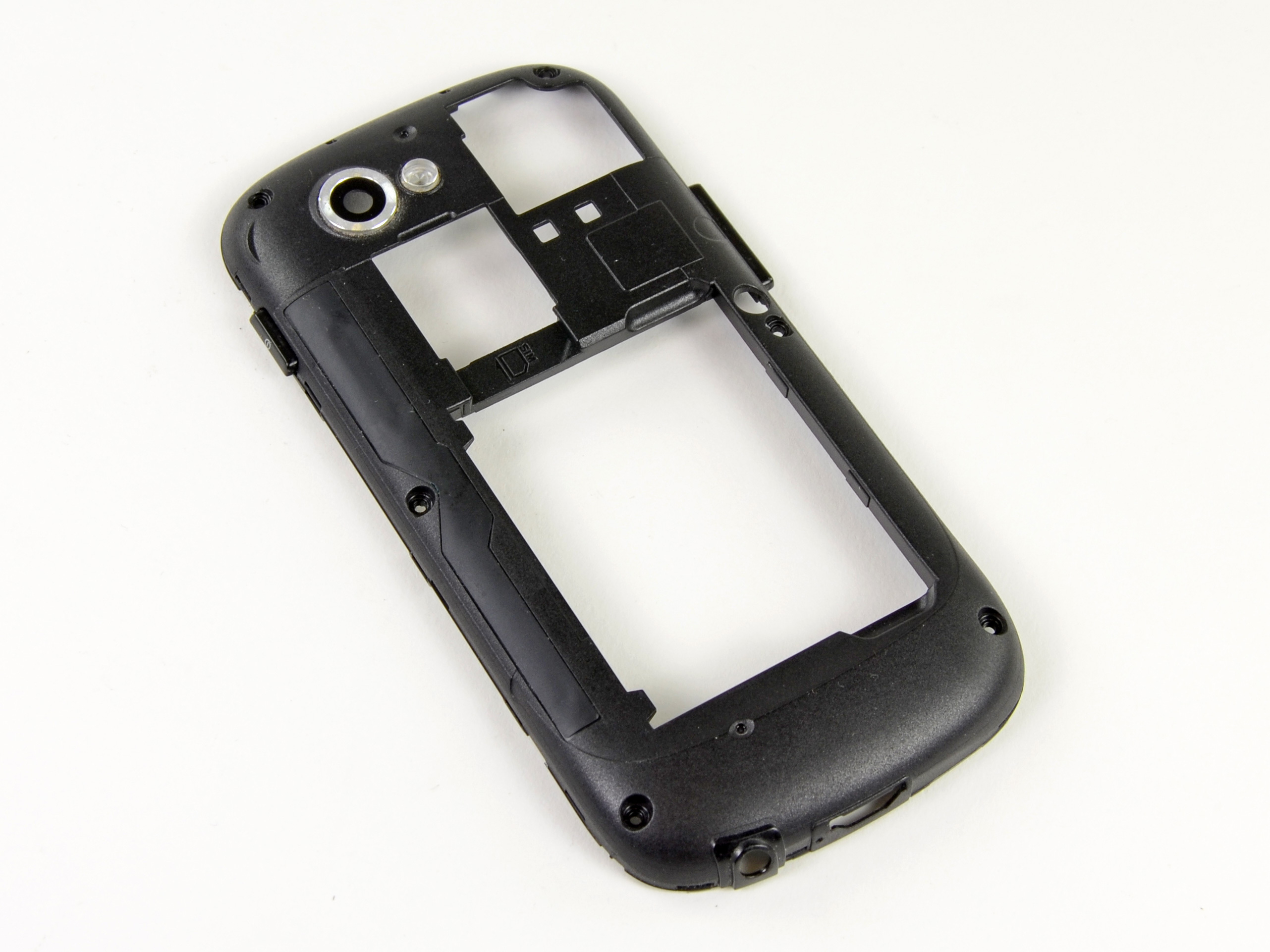

Add Note Edit Step 5 — Rear Inner Frame  ¶
  • Remove the six Phillips screws securing the rear inner frame to the inner case.
Image #1
Add Note Edit Step 6  ¶
  • Insert the flat edge of a plastic opening tool in between the rear inner frame and the top left corner of the Nexus S.
  • Pry the opening tool upwards to pop the top right corner from the clips securing it to the inner assembly.
Image #1 Image #2
Add Note Edit Step 7  ¶
  • Insert the plastic opening tool to the right of the power button.
  • Slide the plastic opening tool downwards along the perimeter of the Nexus S to release the clips on the right side.
Image #1 Image #2
Add Note Edit Step 8  ¶
  • In the same manner as previously described, release the bottom clips located near the bottom of the Nexus S.
