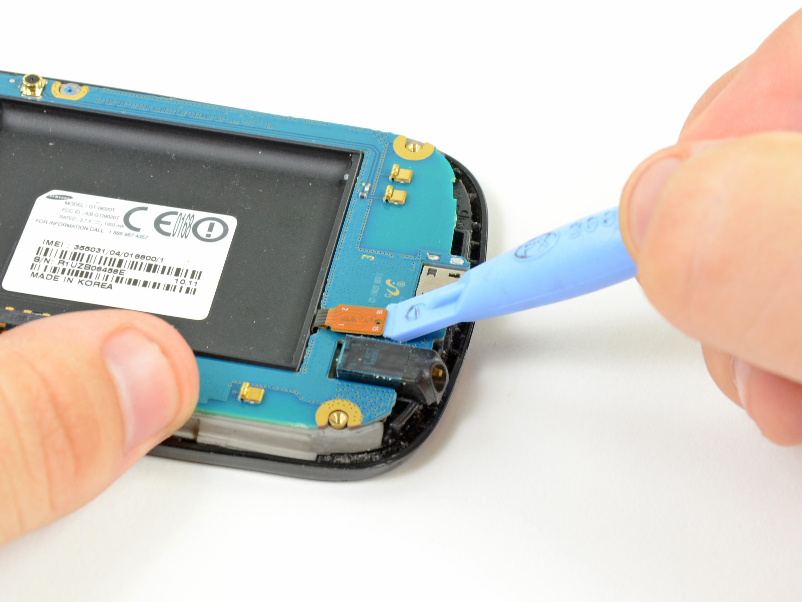

Add Note Edit Step 1 — Motherboard  ¶
  • Insert the flat edge of a plastic opening tool underneath the headphone jack connector and pry upwards.

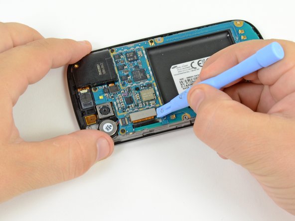

Add Note Edit Step 2  ¶
  • Repeat the same procedure as the previous step to disconnect the digitizer connector.

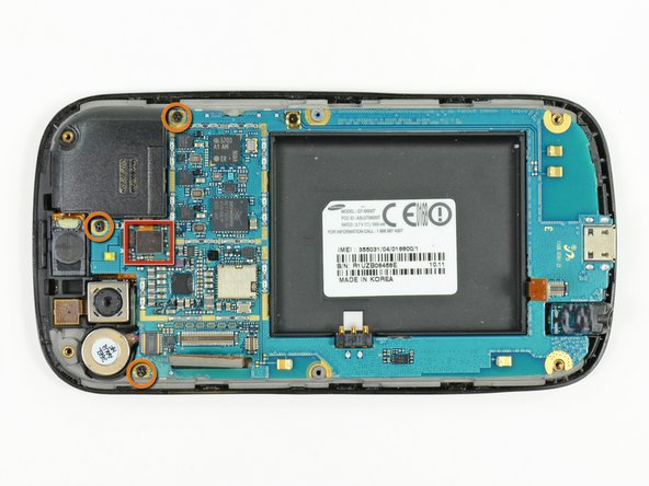

Add Note Edit Step 3  ¶
  • Use a plastic opening tool to pry the speaker connector (highlighted in red) from its socket on the motherboard.
  • Remove the three Phillips screws securing the motherboard to the inner assembly.
