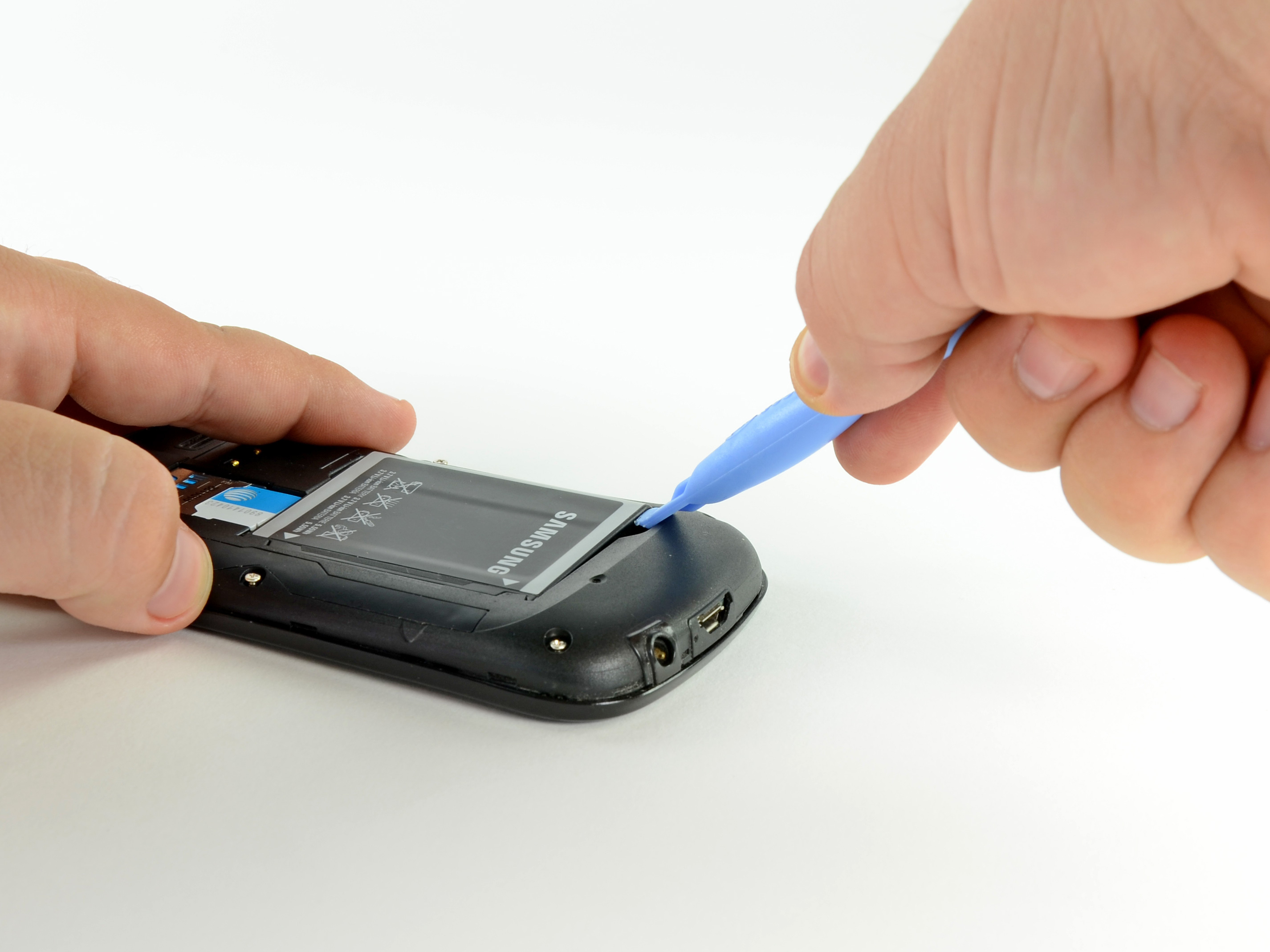

Add Note Edit Step 1 — Rear Panel  ¶
  • Gently insert a plastic opening tool between the rear panel and the inner rear frame near the rear-facing camera.
  • Use your plastic opening tool to pry up the rear case around the perimeter of the Nexus S.
Image #1
Add Note Edit Step 2  ¶
  • Remove the rear panel from the Nexus S.
Image #1
  • Using the edge of a plastic opening tool, lift the battery from the end closest to the headphone jack.
  • Remove the battery from the Nexus S.
