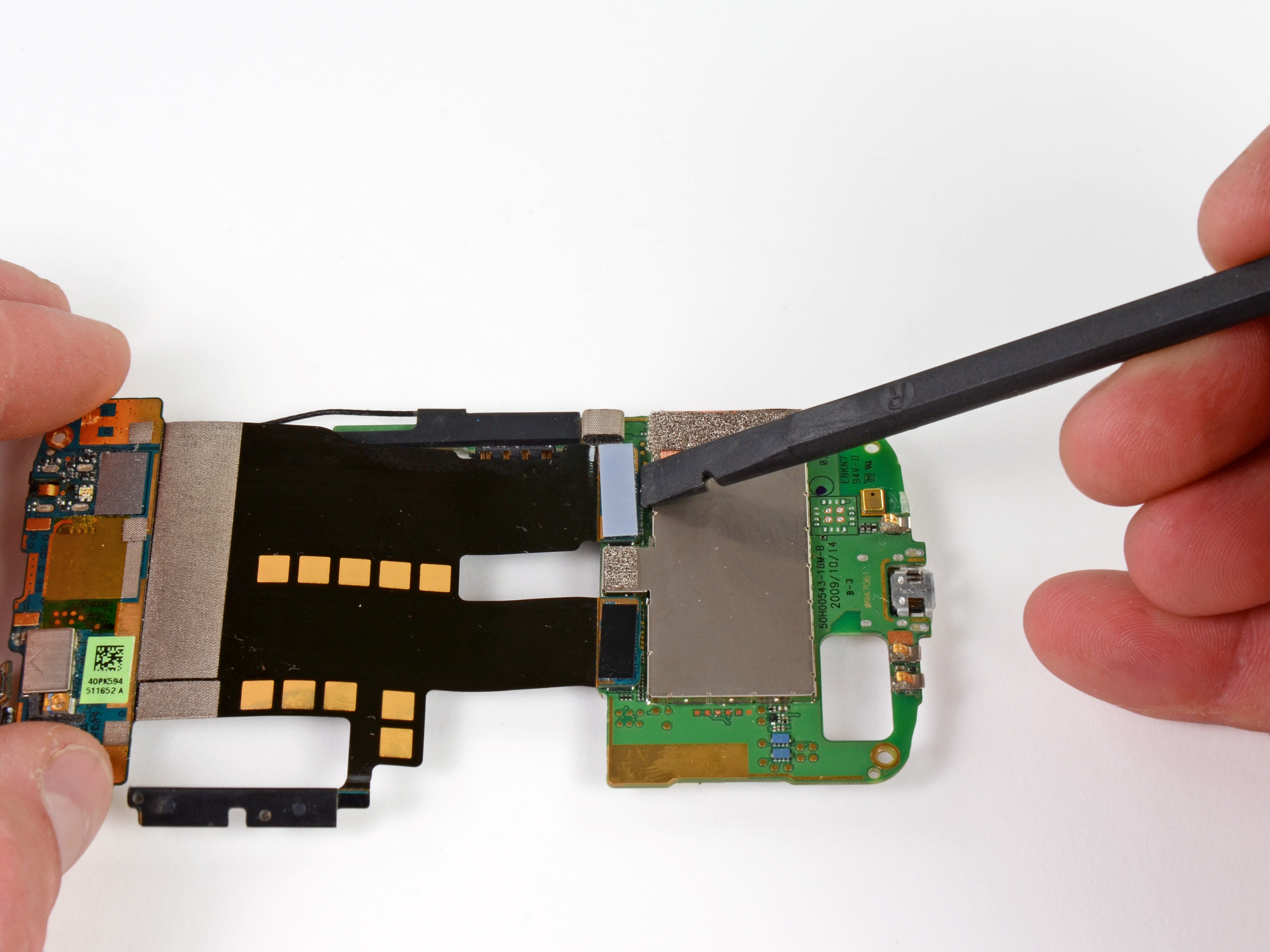

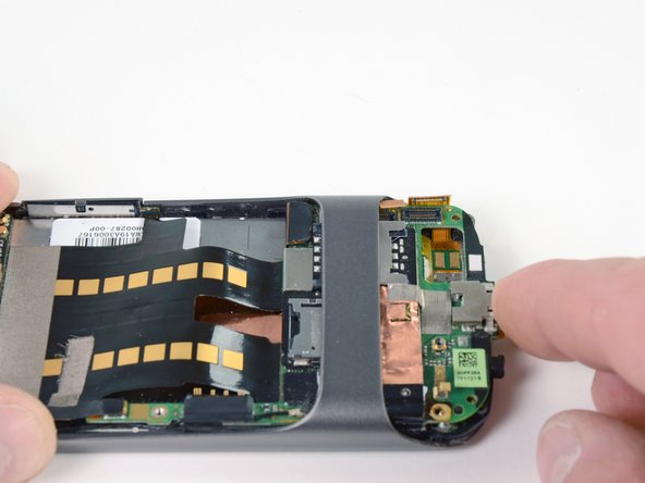

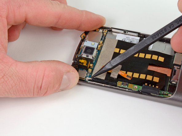

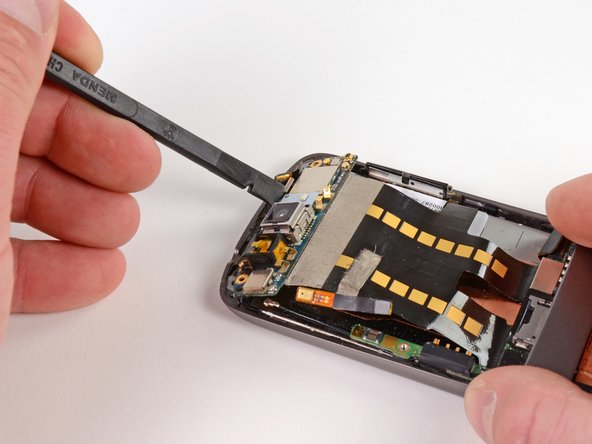

Add Note Edit Step 17 — Motherboards  ¶
  • Insert the spudger under the connector.
  • Push the spudger up and twist to release the connector.
  • Repeat for the next connector.

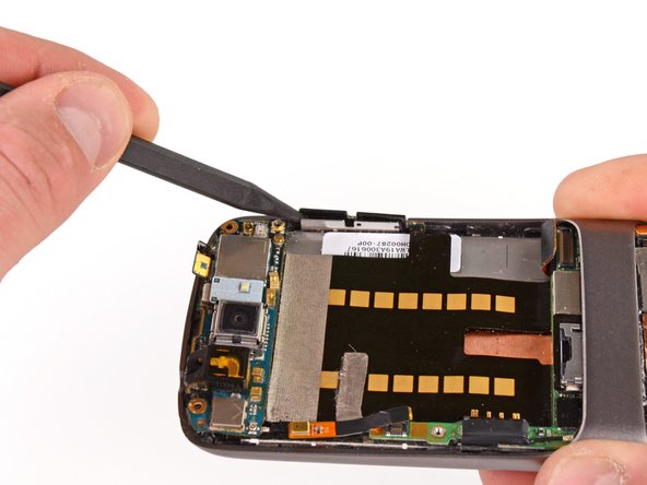

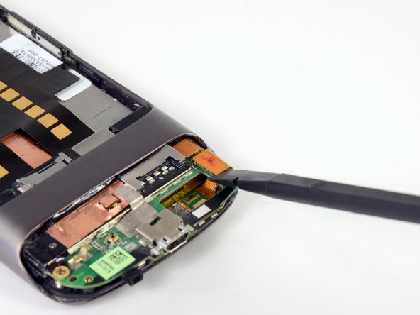

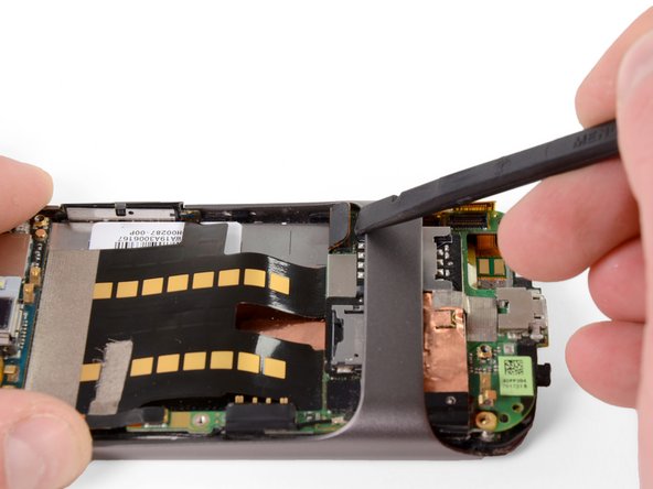

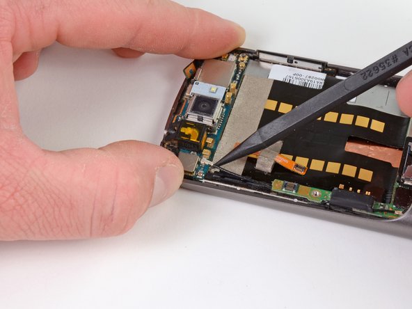

Image #1 Image #2 Image #3
Add Note Edit Step 18  ¶
  • Push on the USB port to expose the black connector.
  • Use the spudger to pry the connector upwards.

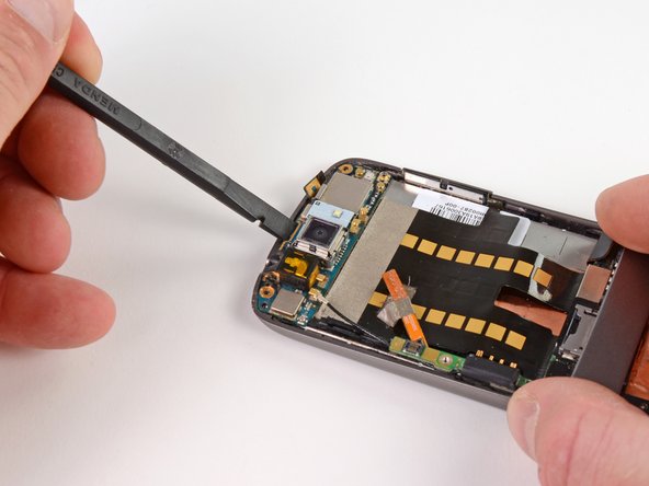

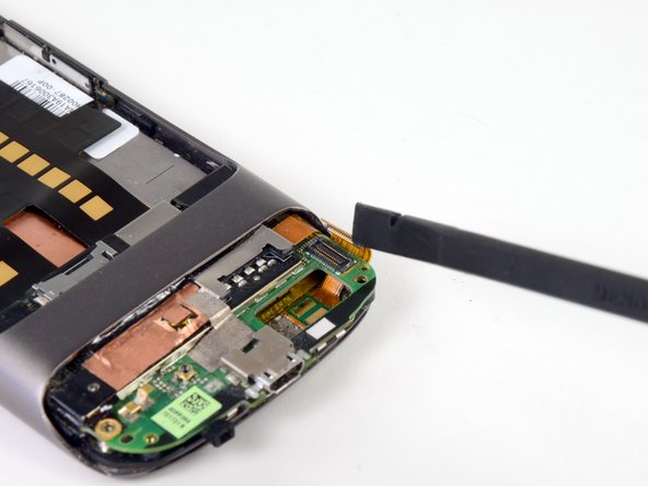

Image #1 Image #2
Add Note Edit Step 19  ¶
  • Place the spugder under the antenna connector.
  • Pry connector up vertically.

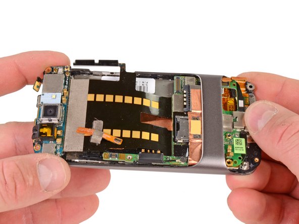

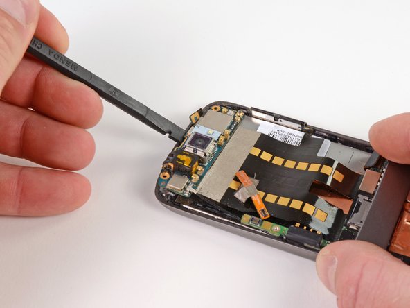

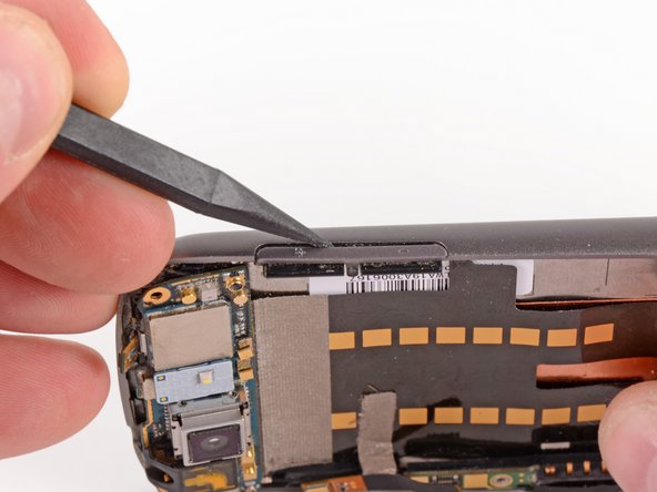

Add Note Edit Step 20  ¶
  • Insert the spudger into tab above the camera.
  • Slide upwards until the board detaches from the case.

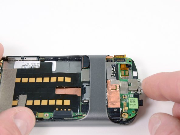

Image #1
Add Note Edit Step 21  ¶
  • Press the pointed tip of the spudger into the space below the button assembly.
  • Wiggle the spudger tip towards the outside of the button.
  • The button assembly is under some tension and may fly off.

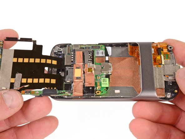

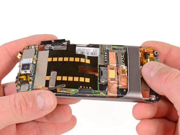

Add Note Edit Step 23  ¶
  • Push on the lower motherboard until it slides under the case support.
  • The motherboard assembly comes out as a single piece.
  • Save the small black rubber rectangular sound guide under the motherboard, to replace over the microphone.

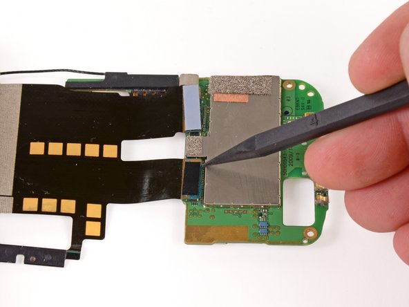

Image #1 Image #2
Add Note Edit Step 24 — Upper Motherboard  ¶
  • Using the spudger, lift the blue colored connector.
  • Use the supdger to lift the black connetor up as well.
  • Detach the upper motherboard from the lower motherboard.
