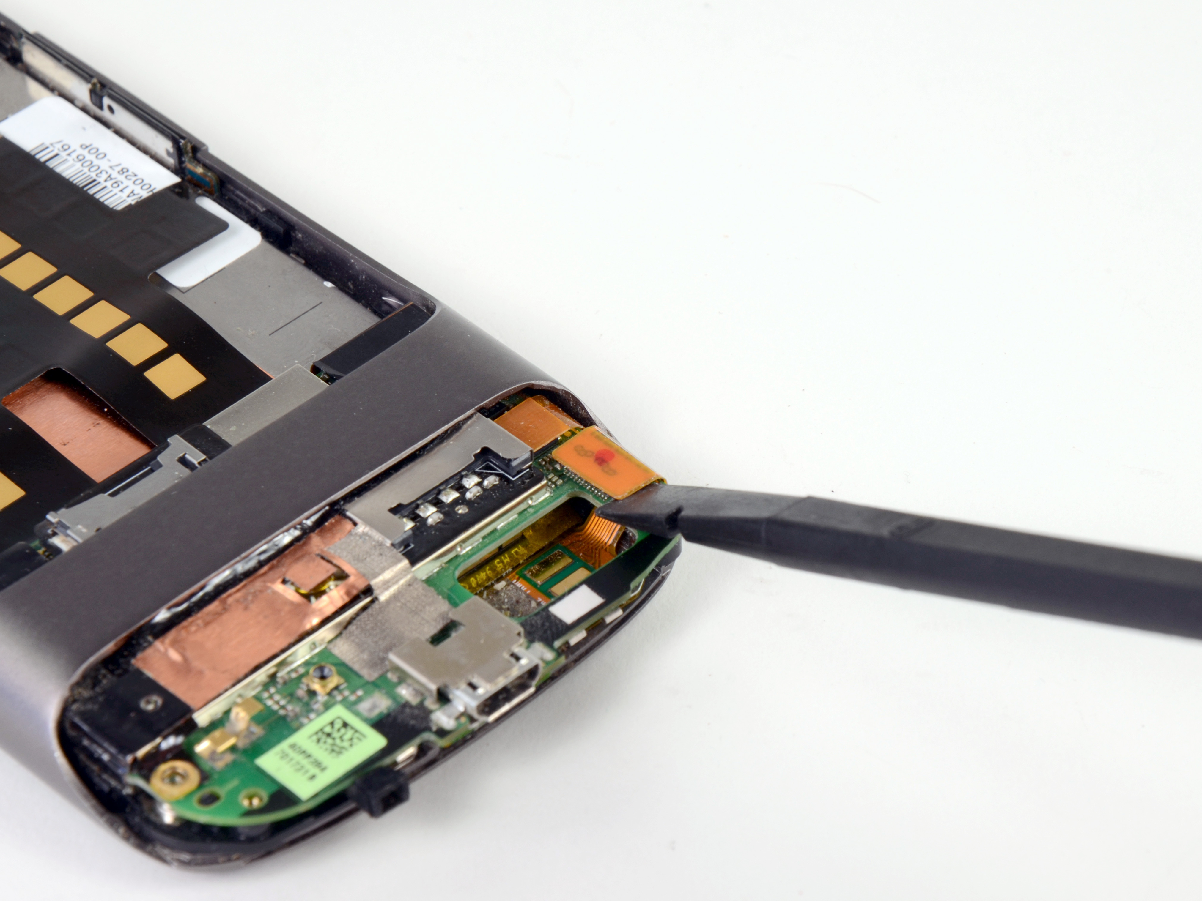

Add Note Edit Step 17  ¶
  • Place the spugder under the antenna connector.
  • Pry connector up vertically.
