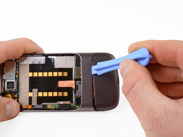

This guide is for removing the lower cover on the Nexus One.
  • Author: Niklas Johnson
  • Time required: 2 to 5 minutes
  • Difficulty: Moderate
Image #1 Image #2
Add Note Edit Step 1 — Lower Cover  ¶

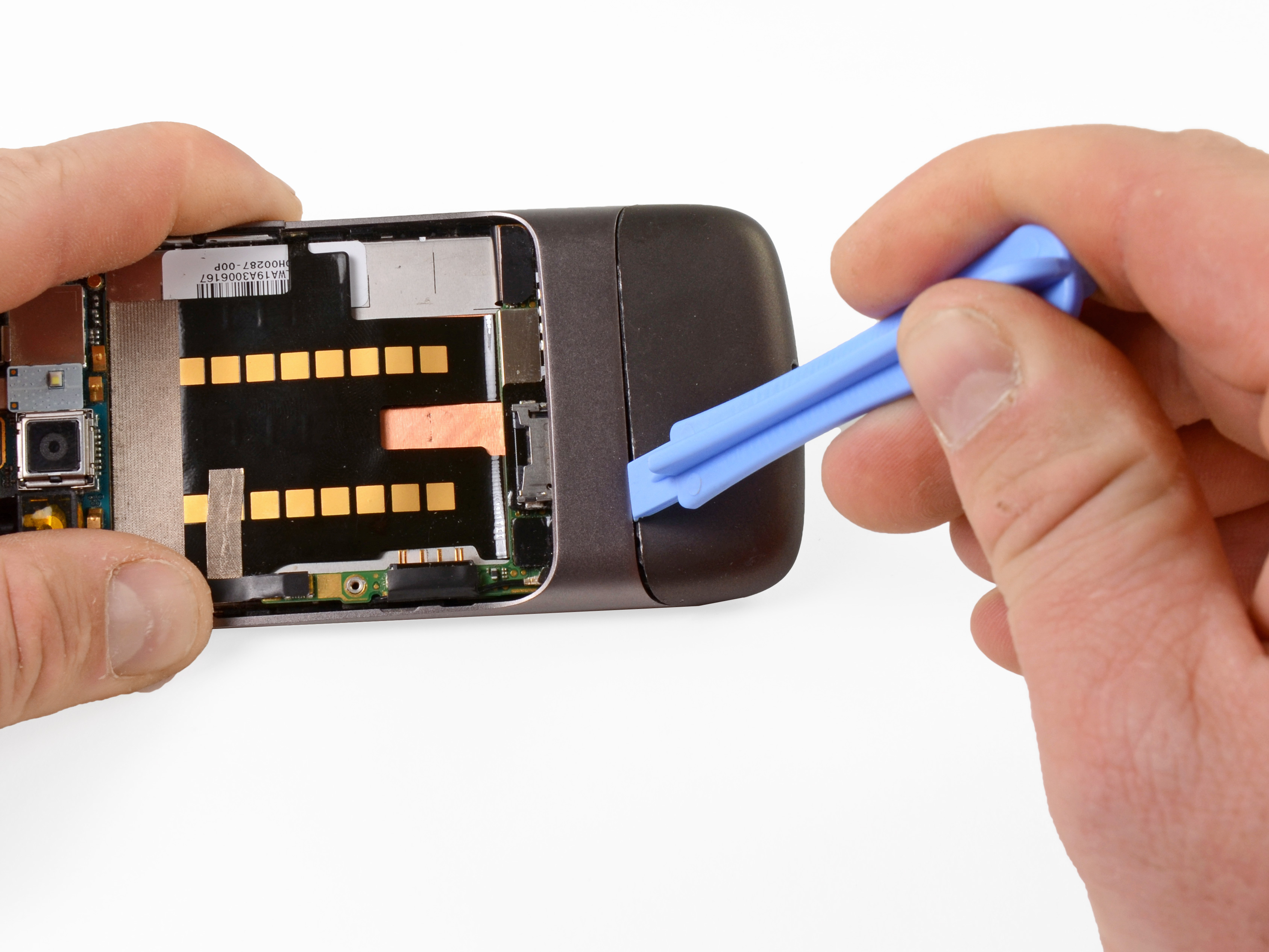

  • Using the plastic opening tool, push the blade into the space between the case and lower cover.
  • Turn the opening tool slightly, the lower cover will detach on that side.
  • Repeat on other side of the seam.
  • The lower cover will slide off.
