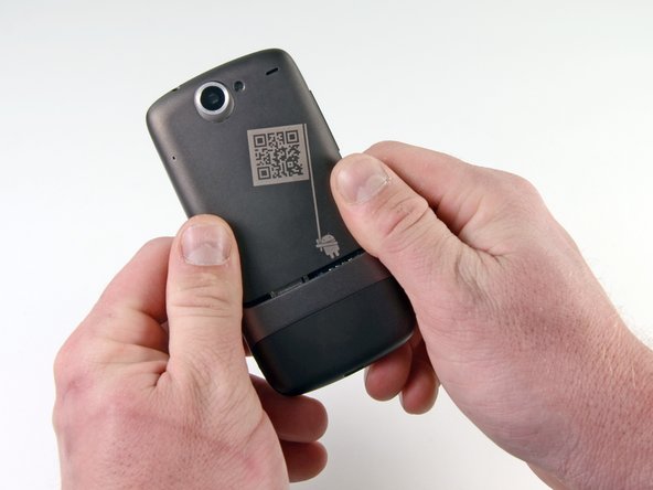

Add Note Edit Step 1 — rear cover  ¶

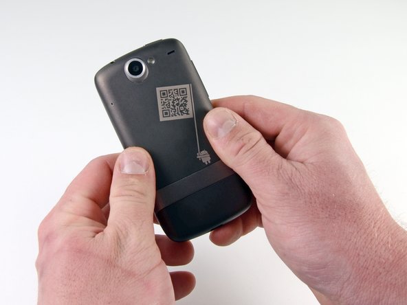

  • Using two fingers, push up on the rear cover.
Image #1

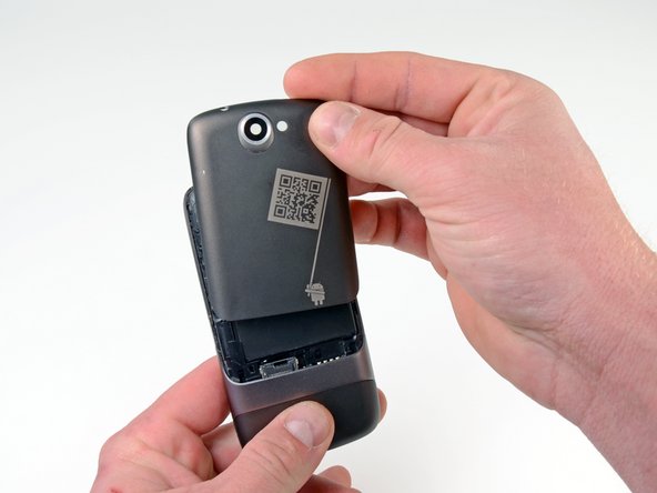

Add Note Edit Step 2  ¶
  • The rear cover slides up and off.
Image #1

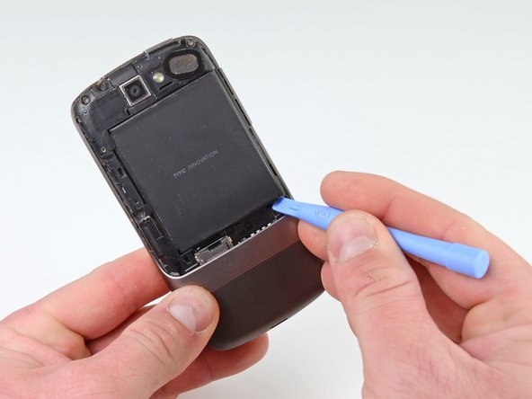

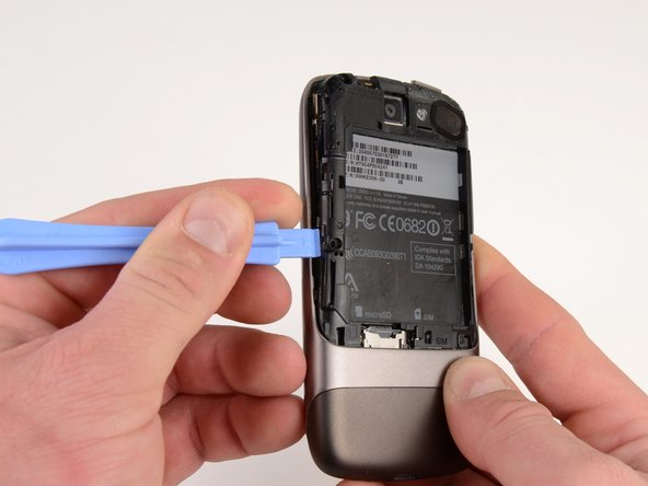

  • Using the plastic opening tools, pry the left bottom corner of the battery up.
Image #1

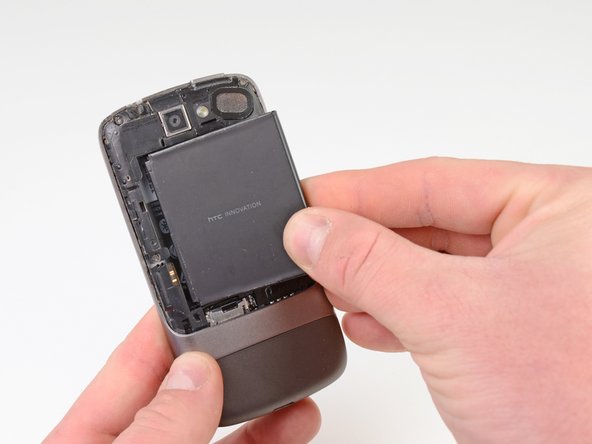

Add Note Edit Step 4  ¶
  • Pull the battery up and out.
Image #1

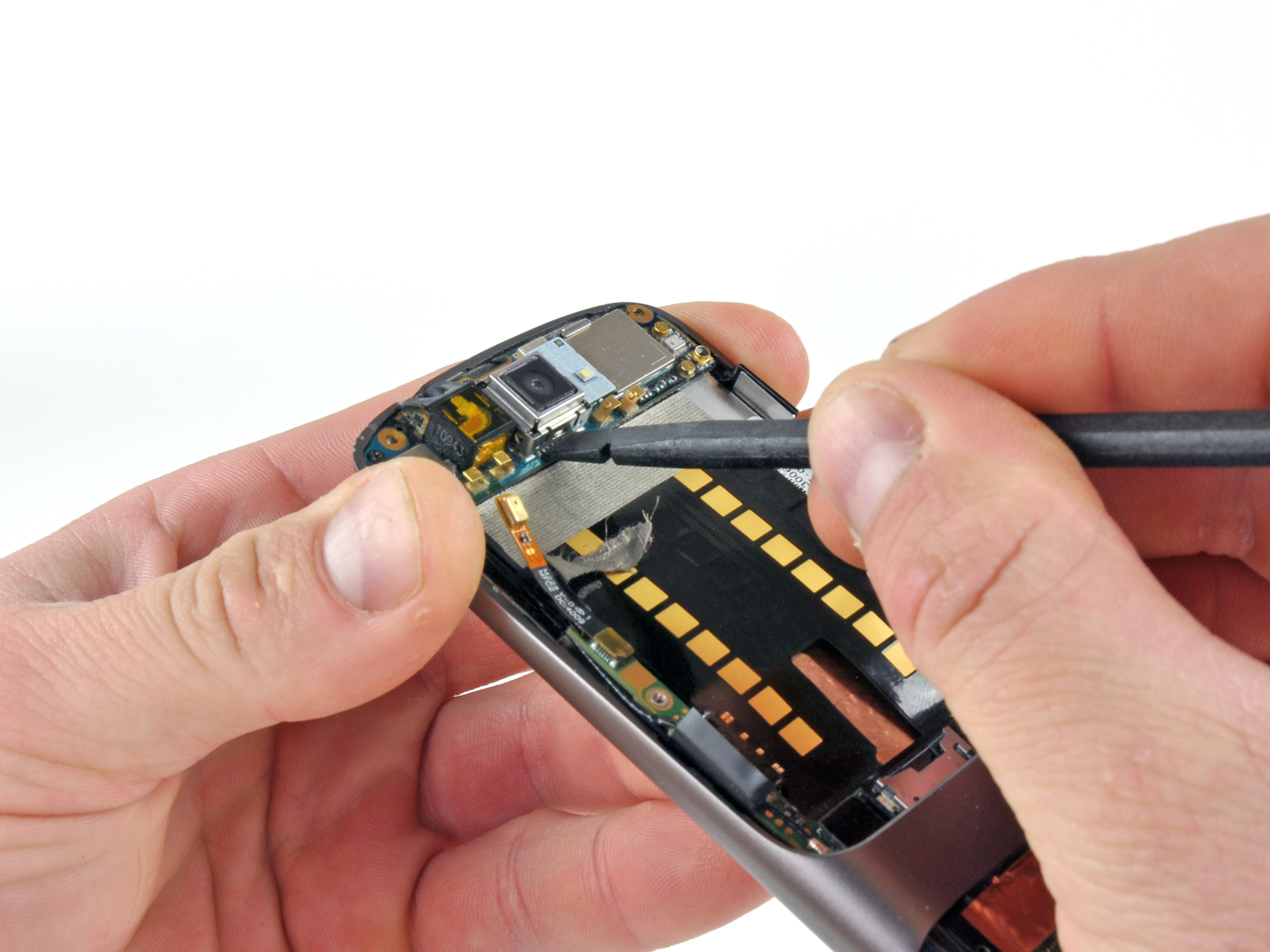

Add Note Edit Step 5 — battery housing  ¶

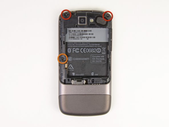

  • Remove the two Torx T5 screws.
  • Remove the one Philips #00 screw.
Image #1 Image #2

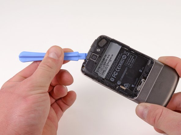

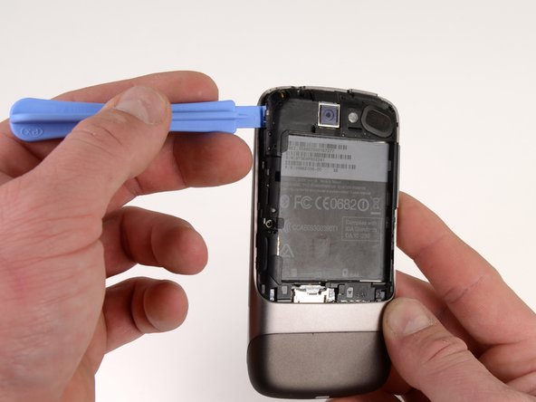

Add Note Edit Step 6  ¶
  • Using the plastic opening tool, pry up the battery housing upwards.
  • Push pry tool down, undoing the plastic tab.
Image #1 Image #2

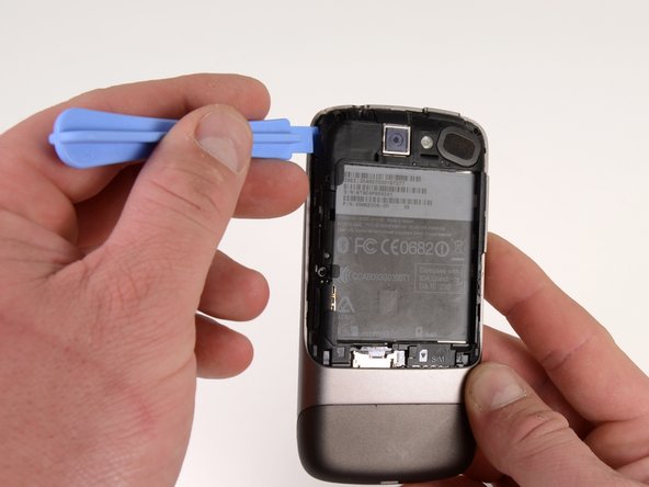

Add Note Edit Step 7  ¶

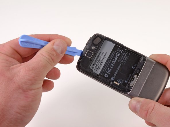

  • Pry the upper left tab open on the battery housing.
Image #1 Image #2

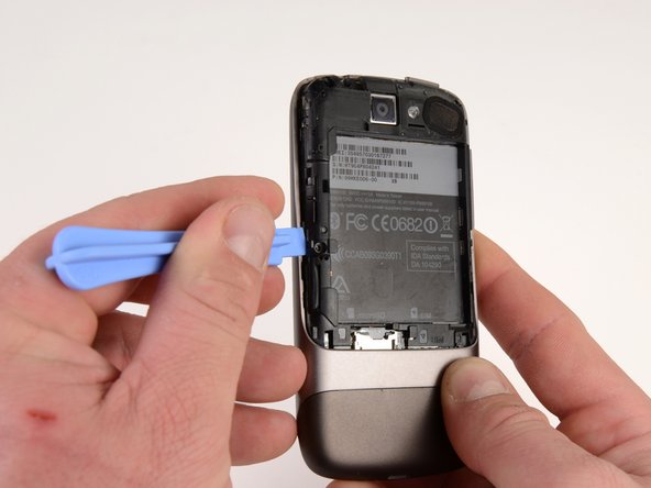

Add Note Edit Step 8  ¶
  • Pry the top tab of the battery housing.
