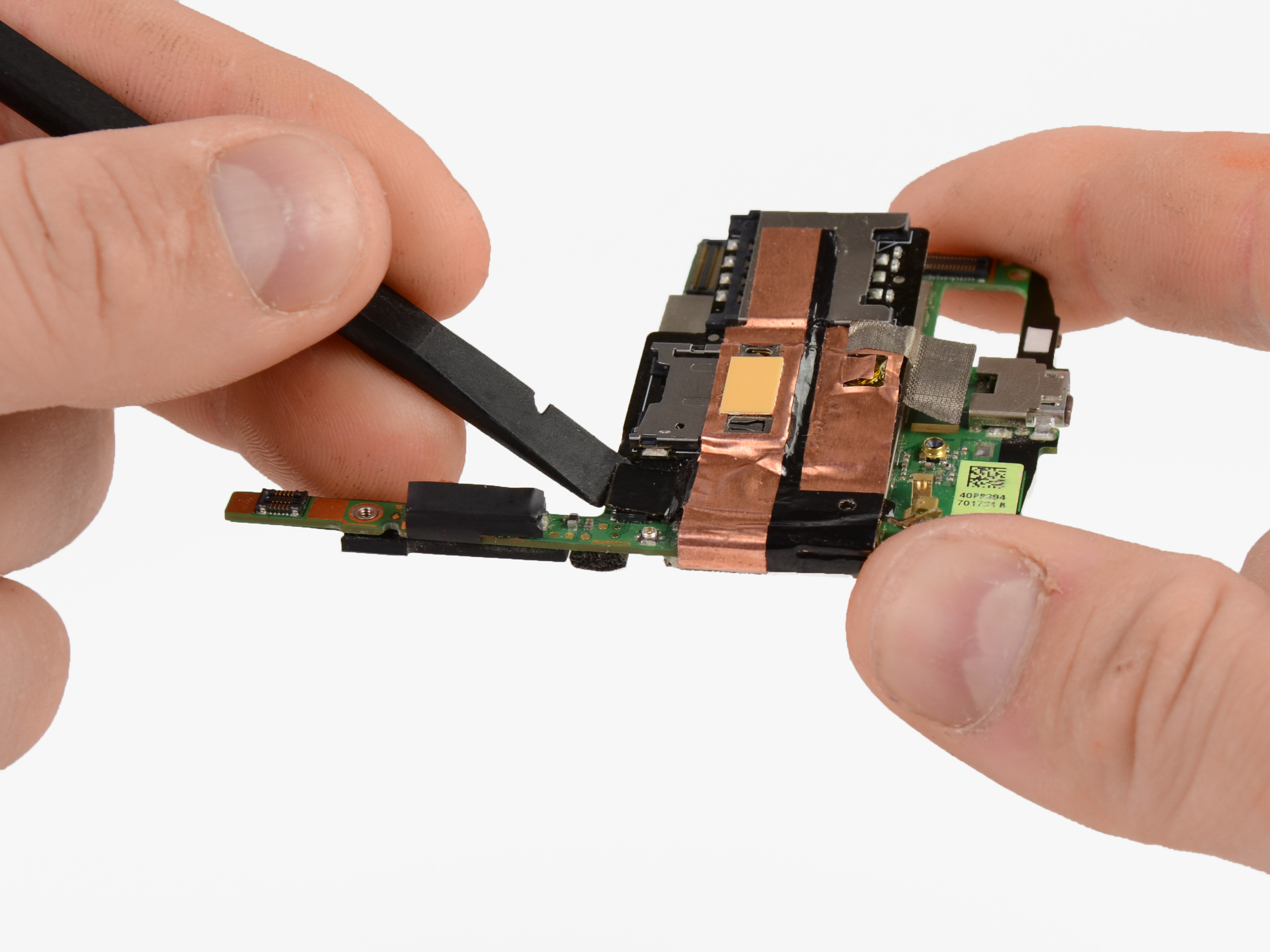

This guide is for replacing the SIM card tray/MicroSD card tray module.
  • Author: Niklas Johnson
  • Time required: 30 to 45 minutes
  • Difficulty: Moderate
Sections (continued)
Image #1 Image #2
Add Note Edit Step 1 — Rear Cover  ¶
  • Using two fingers, push up on the rear cover.
Image #1
Add Note Edit Step 2  ¶
  • The rear cover slides up and off.
Image #1
  • Using the plastic opening tools, pry the left bottom corner of the battery up.
Image #1
Add Note Edit Step 4  ¶
  • Pull the battery up and out.
Image #1
Add Note Edit Step 5 — Battery Housing  ¶
  • Remove the two Torx T5 screws.
  • Remove the one Philips #00 screw.
Image #1 Image #2
Add Note Edit Step 6  ¶
  • Using the plastic opening tool, pry up the battery housing upwards.
  • Push pry tool down, undoing the plastic tab.
Image #1 Image #2
Add Note Edit Step 7  ¶
  • Pry the upper left tab open on the battery housing.
Image #1 Image #2
Add Note Edit Step 8  ¶
  • Pry the top tab of the battery housing.
