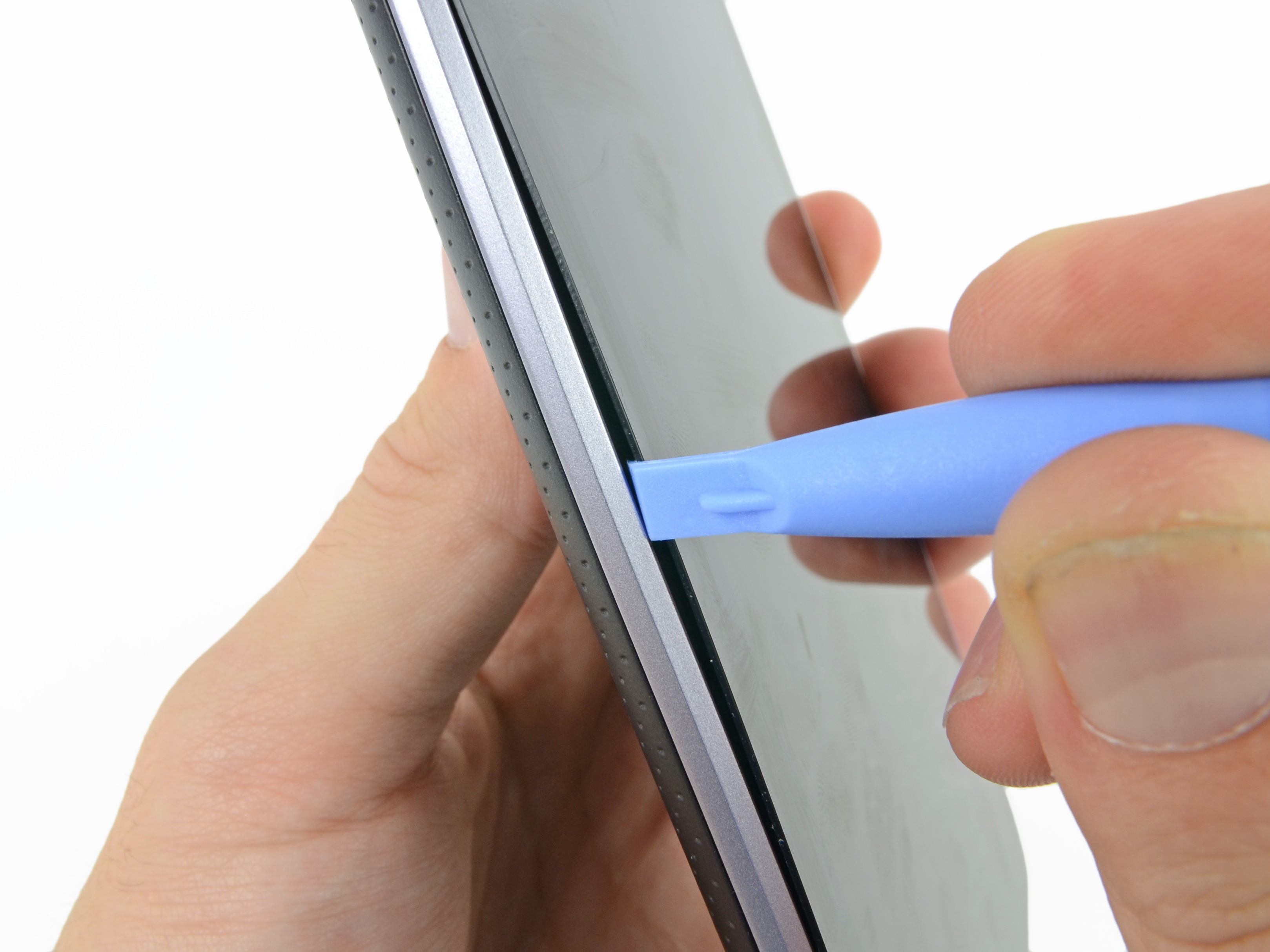

Add Note Step 2  ¶
  • Gently insert a plastic opening tool near the top of the Nexus 7 between the rear panel and the front panel assembly.
  • Carefully run the plastic opening tool along the top edge to pry the rear panel away from the front panel assembly of the Nexus 7.

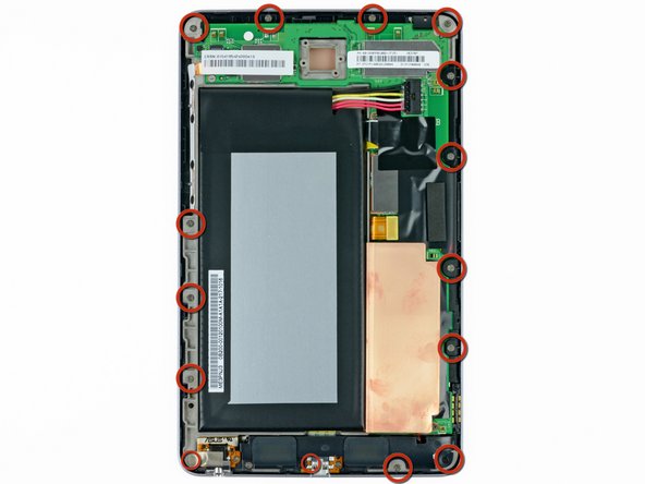

Add Note Step 6 — Screw Tightening  ¶
  • The issue at hand is that the front glass panel seems to be separate quite easily from the front panel assembly.
  • The picture shows just how easily the front glass panel lifts off the Nexus 7.
  • If you are currently one of the unlucky Nexus 7 owners suffering this dilemma, follow along for a quick but effective fix.
Image #1 Image #2

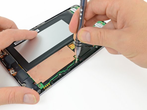

Add Note Step 7  ¶
  • Tighten the Phillips screws along the perimeter of the Nexus 7's front panel assembly (highlighted in red)
  • Do not over-tighten the screws. Doing so may strip the screws or cause damage to several components.
