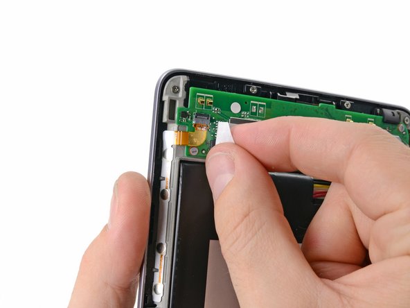

Add Note Edit Step 7 — Power & Volume ZIF Connector  ¶
  • Peel back the label covering the power and volume button ZIF connector.
Image #1 Image #2

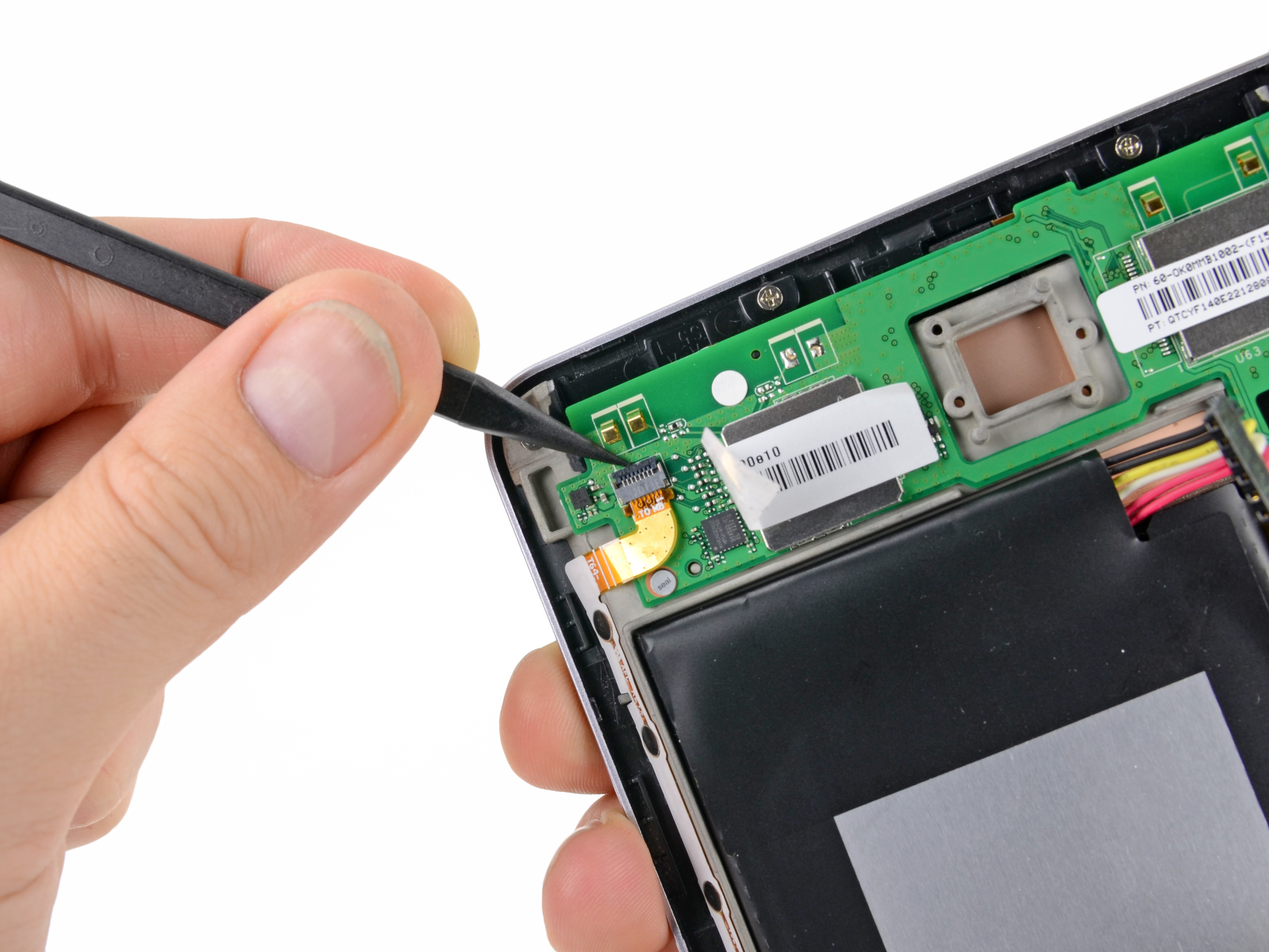

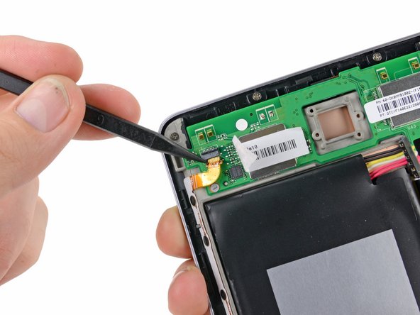

Add Note Edit Step 8  ¶
  • Use the tip of a spudger to carefully flip up the retaining flap on the power and volume button ribbon cable ZIF socket.
  • Make sure you are flipping up the retaining flap, not the socket itself.
  • Use the tip of a spudger to pull the power and volume button ribbon cable straight out of its socket.
