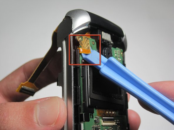

  • Using the plastic opening tool, pry off the top faceplate.
  • Place the tool in the small crack that runs along the side of the phone and pry.

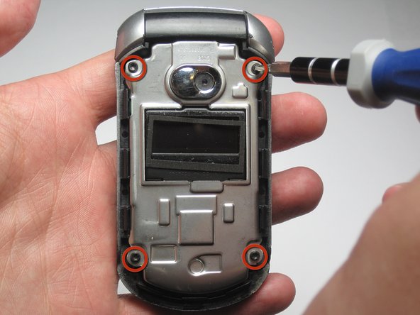

  • Using the T6 Torx Screwdriver remove all 4 small screws.

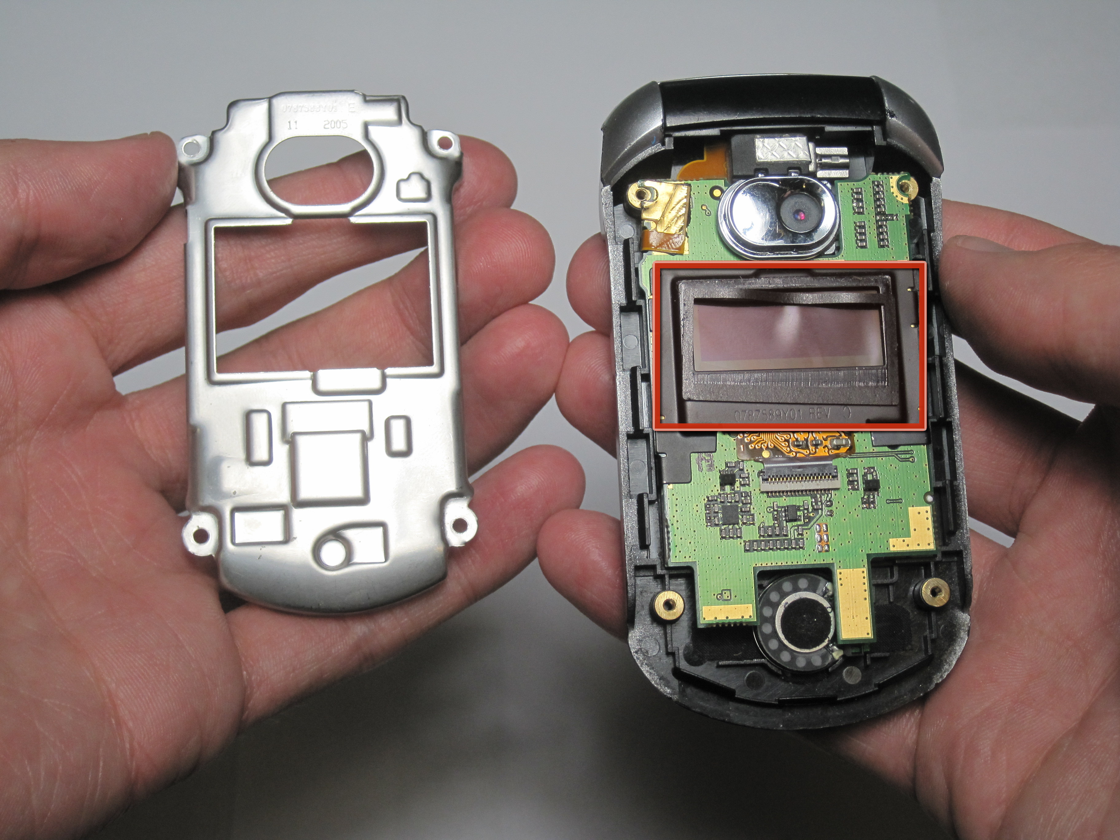

  • Remove silver plate from phone.

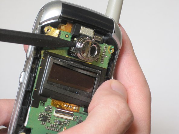

  • Using the spudger remove the plastic camera casing

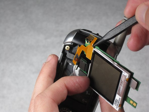

  • Using the iPod Opening Tool remove the yellow flex cable from the green logic board.
Image #1
Add Note Edit Step 6  ¶
  • Use Spudger or hands to detach flex cable from front screen logic board

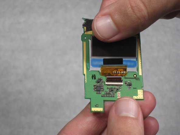

  • Using the plastic opening tool, lift the small black flap to unlock the screen from the logic board.
Image #1
Add Note Edit Step 8  ¶
  • Using your fingers, carefully pull out the small LCD display screen.
