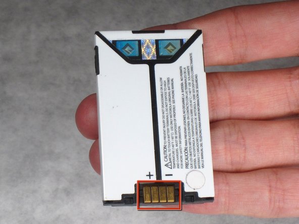

  • Note the metal connections on the phone, which are now exposed with the battery removed.
  • There are corresponding metal connectors on the replacement battery.
  • When you install the battery, be sure both connectors are matched up. Otherwise, your battery will be unable to supply power to your phone.

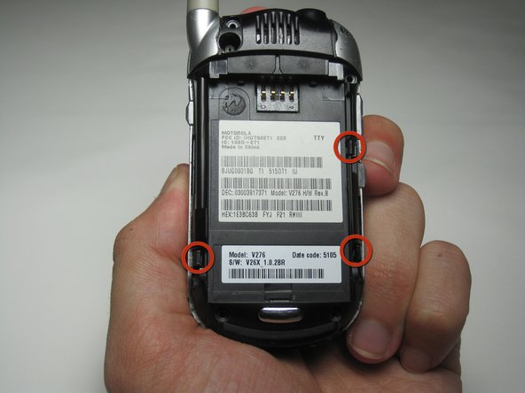

  • Use Spudger to remove rubber plug from upper left corner of the back of the phone
Image #1
Add Note Edit Step 5  ¶
  • Using a Hex T6 screwdriver, remove the 4 screws holding the back plate of the phone in place
Image #1 Image #2 Image #3

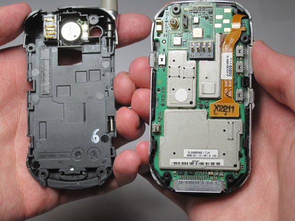

Add Note Edit Step 6  ¶
  • There will be three tabs holding the back plastic plate in
  • To remove the back plate, pull the tabs towards the outside of the phone and lift the plate up simultaneously
  • Be careful when removing the back plate; don't put too much stress on the back plate or the plastic may snap

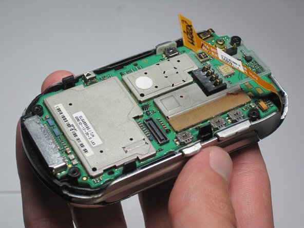

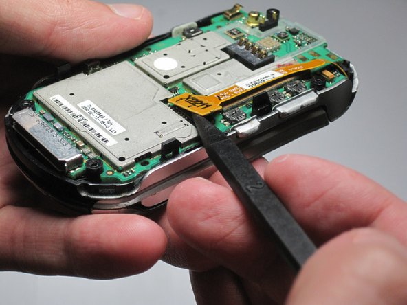

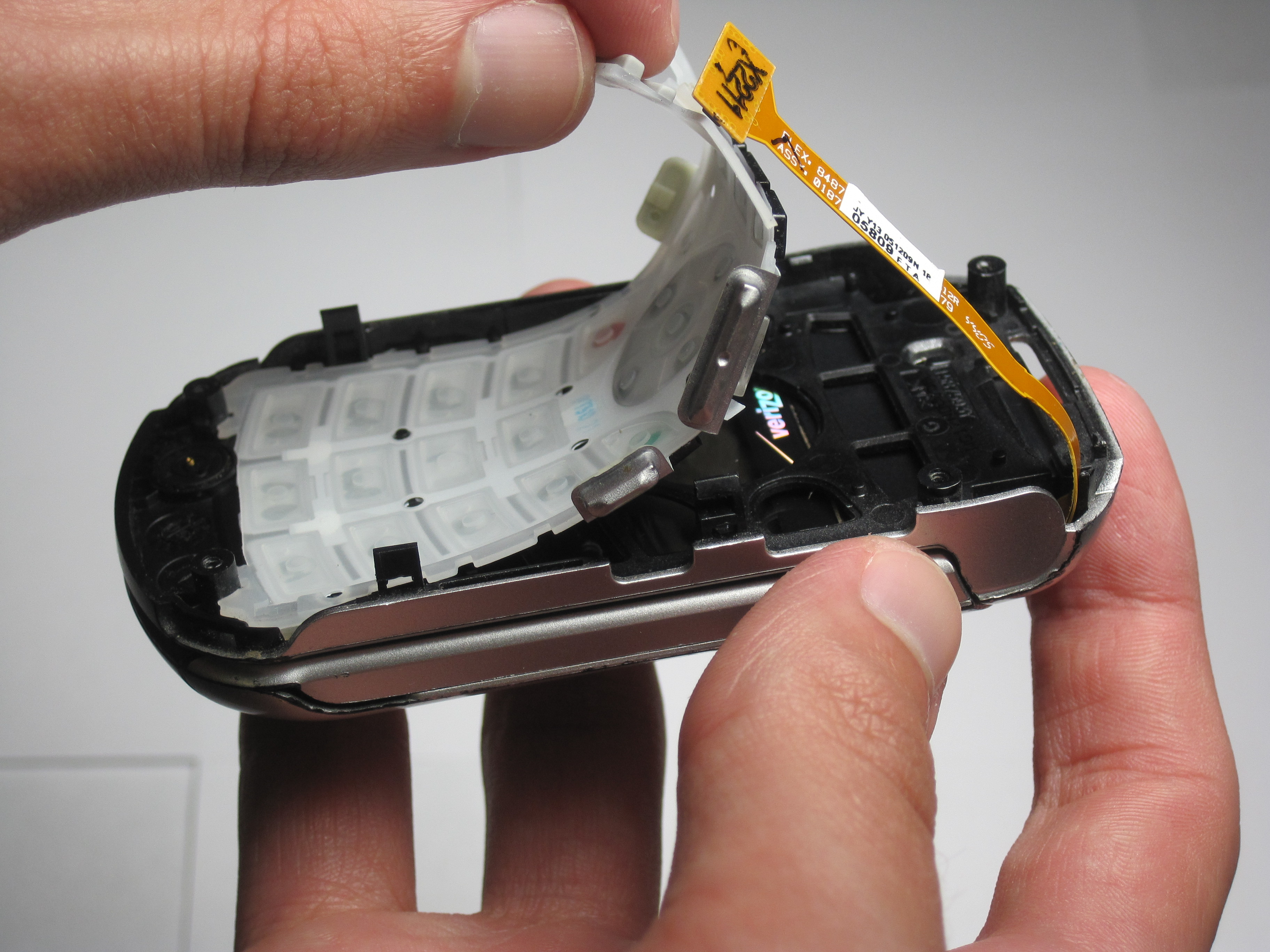

Add Note Edit Step 7  ¶

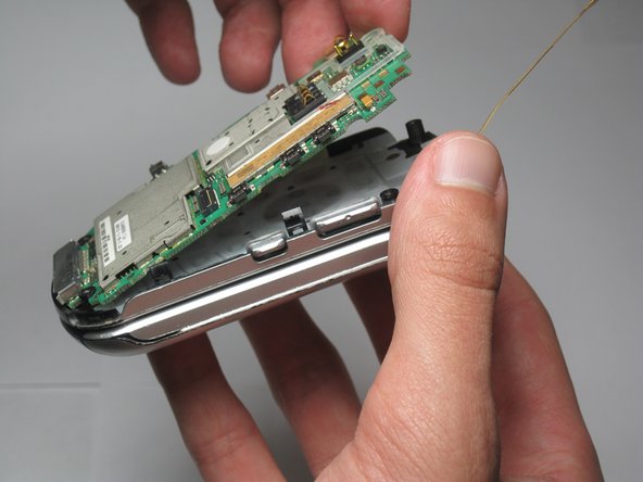

  • Remove the flex from the mother board using the Spudger
  • Be delicate while removing the ribbon cable because it is slightly fragile and it is necessary for the phone to function
Image #1
Add Note Edit Step 8  ¶
  • Gently peel back the motherboard from the main part of the phone.
