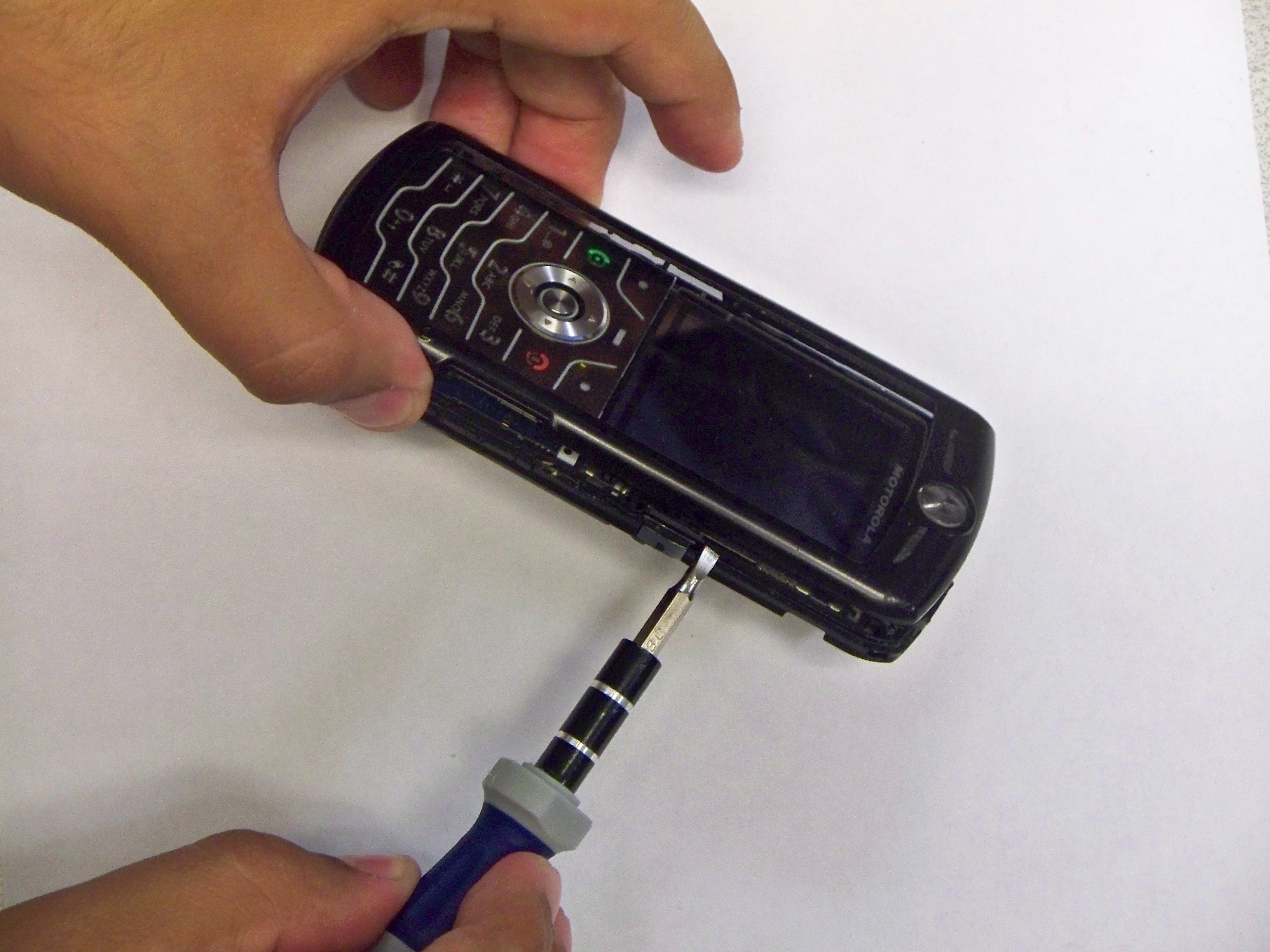

  • Push down on the black tab located at the top center of the Motorola phone
Image #1

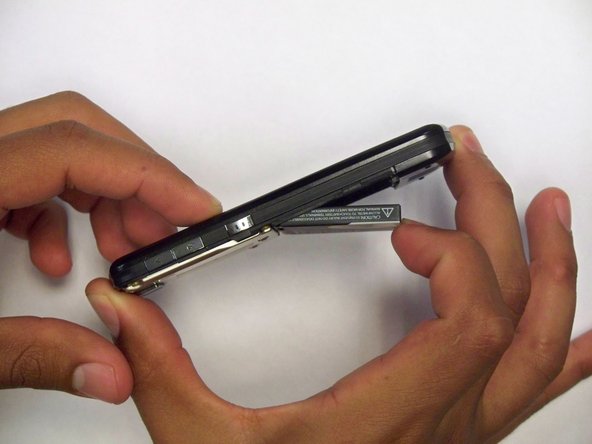

Add Note Edit Step 2  ¶
  • Remove the battery by pulling the battery from the top center.

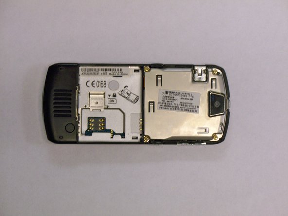

Add Note Edit Step 3  ¶
  • Remove the four T6 2 mm TX Torx screws

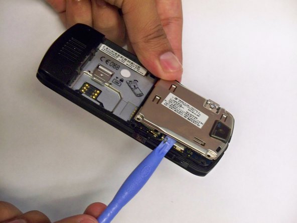

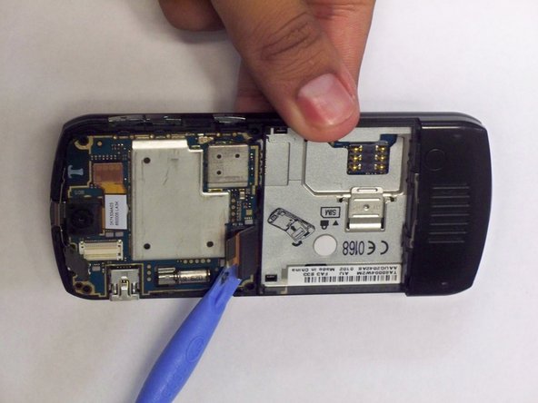

Add Note Edit Step 4  ¶
  • Insert the flat end of a plastic opening tool and pry the metal cover up off the phone.
Image #1 Image #2

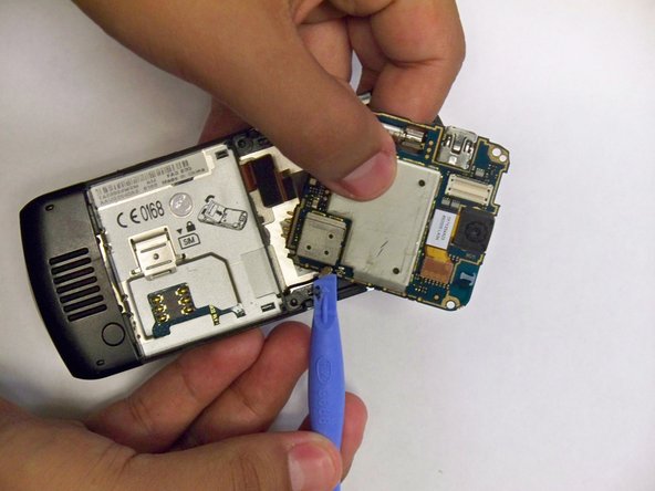

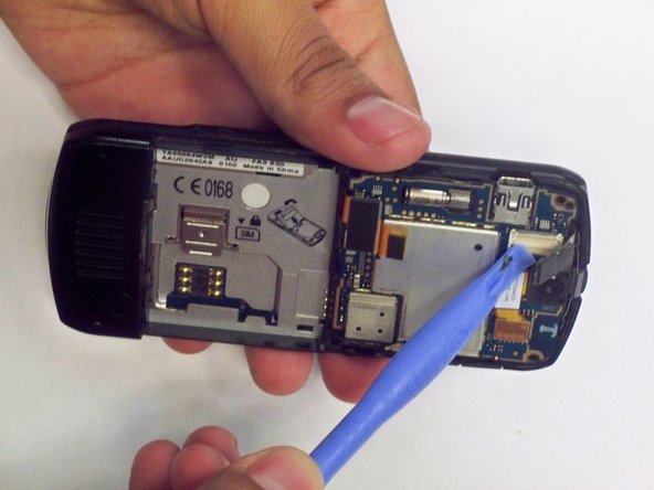

Add Note Edit Step 5  ¶
  • Carefully, disconnect the two connectors from their sockets on the motherboard using the flat end of a plastic opening tool.
Image #1
Add Note Edit Step 6  ¶
  • Use a plastic opening tool to pry the antenna cable connectors from its respective socket on the motherboard.
  • De-route the antenna cable by pulling it out.

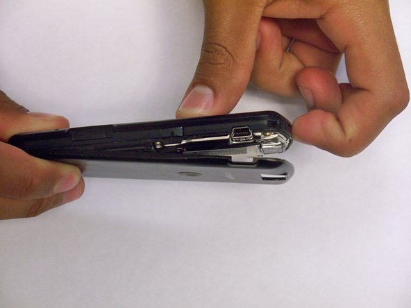

Image #1
Add Note Edit Step 7  ¶
  • Use a spudger to lift and remove the black plastic screw cover at the bottom of the phone near the speaker
  • The cover is attached by adhesive, so some force may be required.

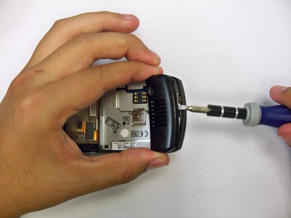

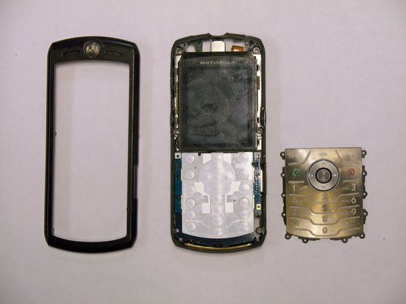

Image #1 Image #2

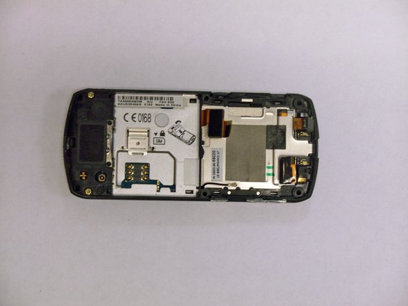

Add Note Edit Step 8  ¶
  • Insert the flat end of a spudger and pry the frame off the phone.
  • The frame is attached by adhesive, so some force may be required
