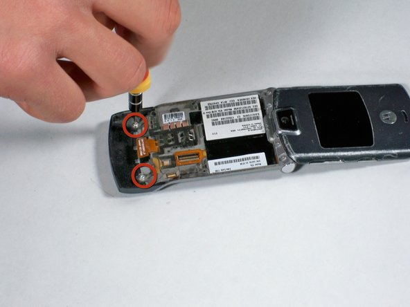

Add Note Edit Step 3 — Keypad Cover (CDMA)  ¶
  • Remove the two T6 screws on the back of the phone.
Image #1

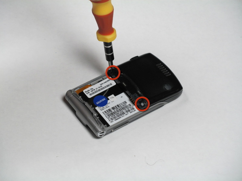

Add Note Edit Step 6  ¶
  • Remove the two T6 screws securing the plastic speaker cover to the phone.
Image #1

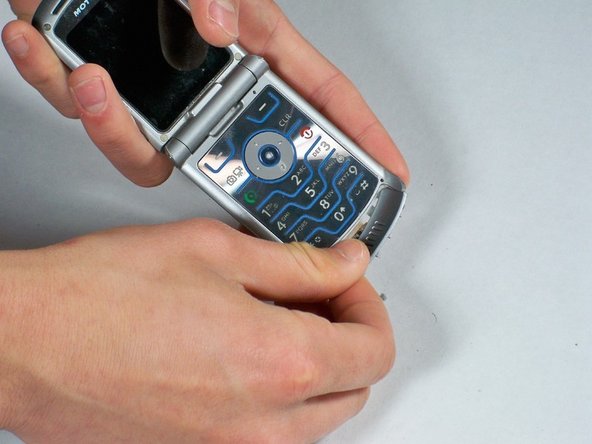

Add Note Edit Step 7  ¶
  • Pull off the lower front casing.
  • The metal shield will come off when the lower front casing is removed, make sure to replace this when reassembling the lower bottom casing.
Image #1
Add Note Edit Step 8  ¶
  • Pull the silver plastic cover down away from the rest of the phone.
