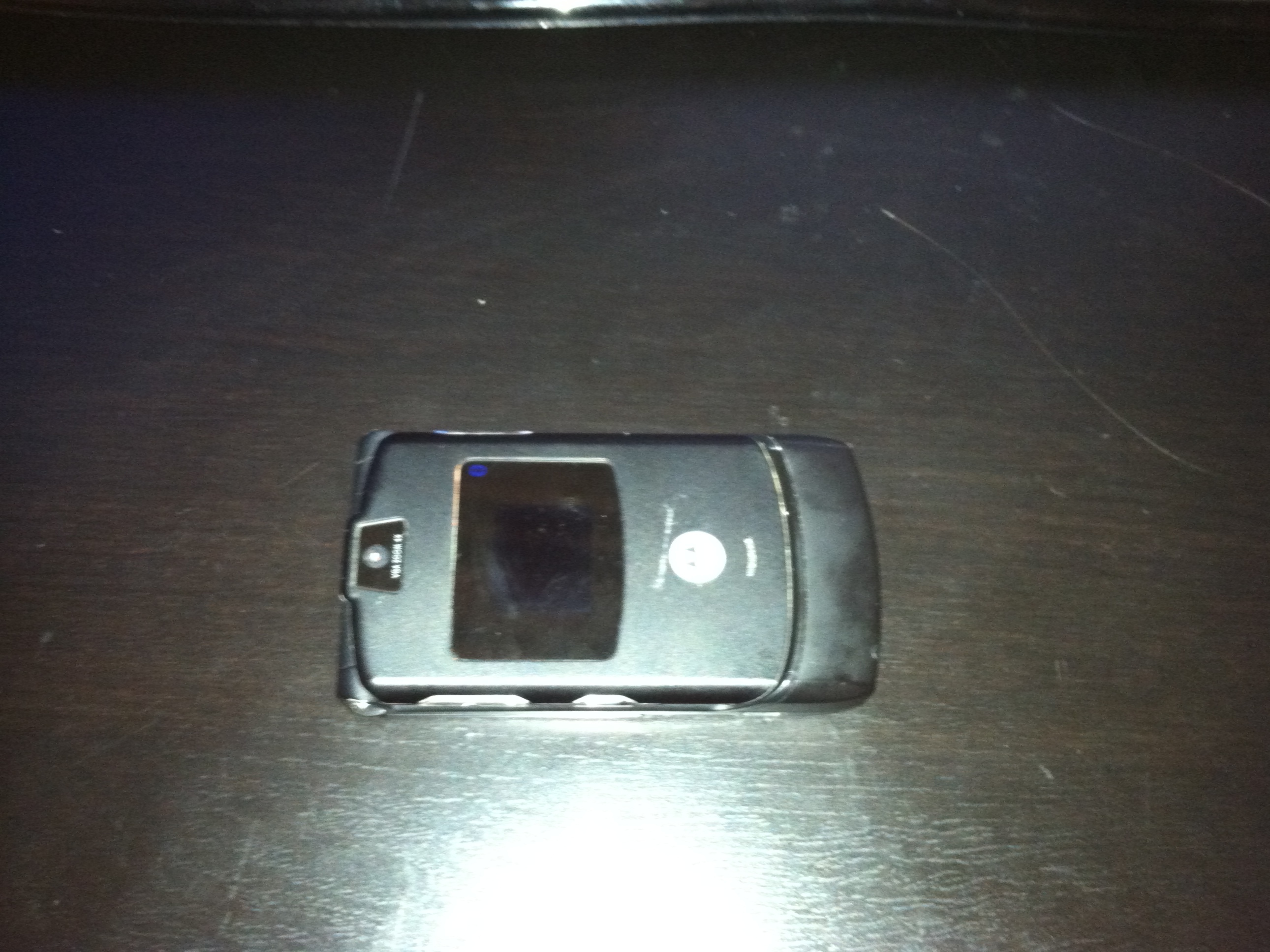

Image #1
Add Note Edit Step 1 — Face-Screen  ¶
  • Find a work space that will allow you to take a part the phone. You will need to place the screws in a place where they will be easy found--in order to reassemble.
Image #1
Add Note Edit Step 2  ¶
  • Open the face of the phone.
Image #1
Add Note Edit Step 3  ¶
  • Use a 1.5mm Hex tool to take off the four screws that are located around the face plate.
Image #1
Add Note Edit Step 4  ¶
  • Once the four screws are off, use a flat surfaced tool to click the face-screen cover off.
Image #1
Add Note Edit Step 5  ¶
  • Check in: Once the cover to the face-screen is off, your work area should look like this.
Image #1
Add Note Edit Step 6  ¶
  • Since there is nothing securing the face-screen, all you must do is remove it using your fingers.
Image #1
Add Note Edit Step 7  ¶
  • After the face-screen is off and out of it's casing, you may replace it with one that works.
Image #1
Add Note Edit Step 8  ¶
  • Time to put it back together! Place the new face-screen in the casing, then place the come back on it.
