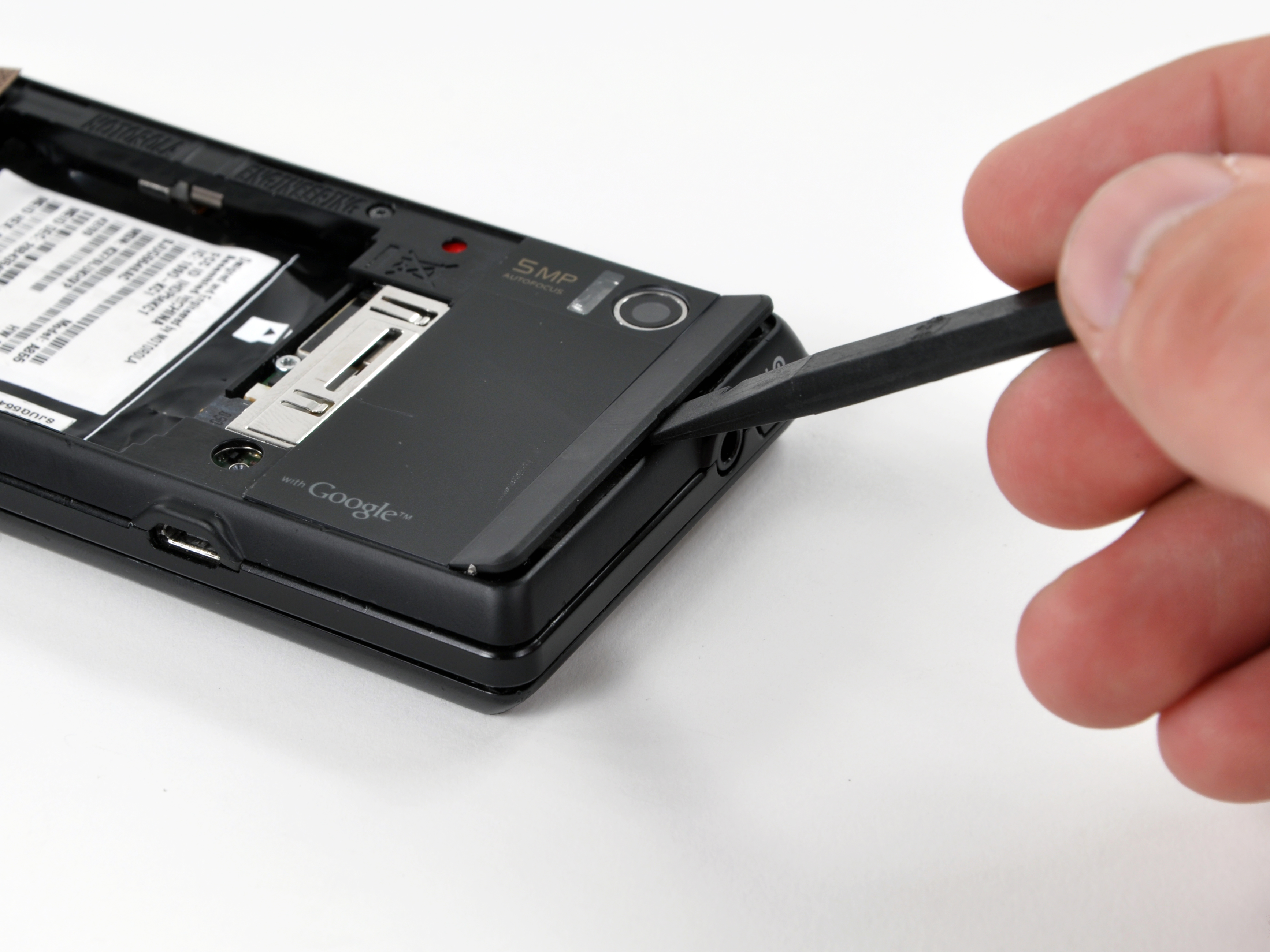

Add Note Edit Step 6  ¶
  • Insert the flat end of a spudger and pry the plastic camera cover up off the phone.
  • The thin plastic cover is attached to the phone with an adhesive. Work slowly and carefully.
Image #1
