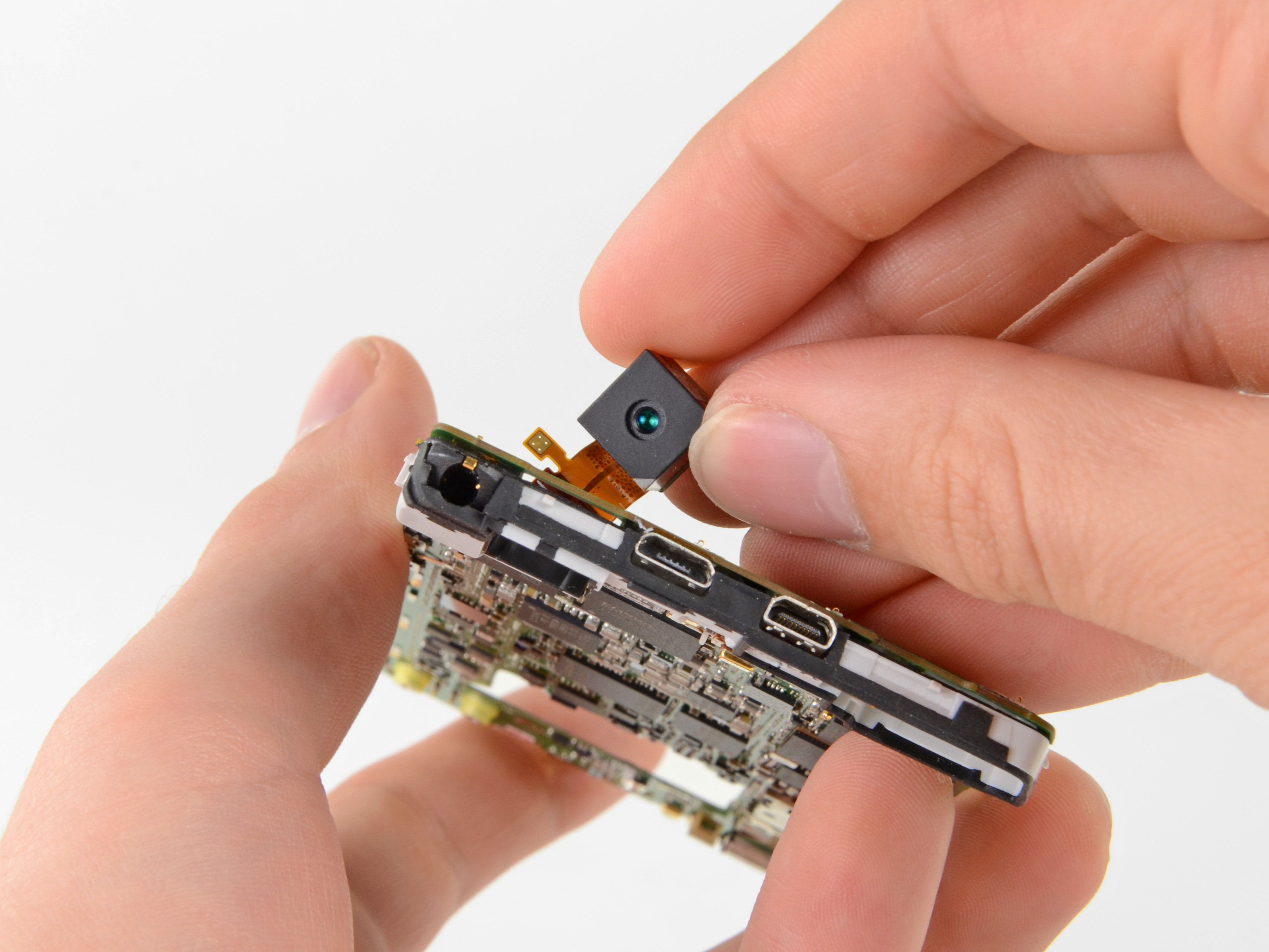

Installing Motorola Droid RAZR Rear-Facing Camera
Droid RAZR rear-facing camera replacement.
What's the point of a phone if it can't take 8 megapixel pictures, right? Replace the rear-facing HD camera in your Droid RAZR to help keep your Mobile Uploads album on Facebook up to-date.

Add Note Edit Step 8 — Rear Case  ¶
  • Remove the six screws securing the rear case to the rest of the phone:
    • three 6.7 mm silver T3 Torx screws at the top,
    • four 4.0 mm gold T3 Torx screws in the middle,
    • and three 4.5 mm black T5 Torx screws at the bottom.
