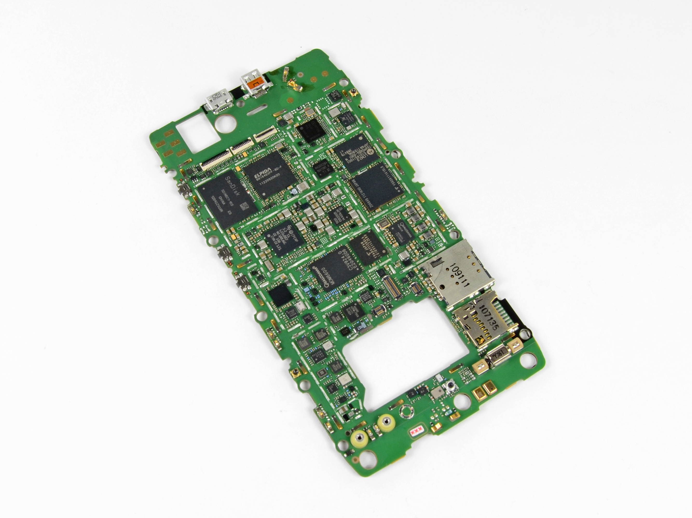

Droid RAZR motherboard replacement.
The motherboard of the Droid RAZR houses a number of critical components, including the SD and SIM card readers, vibrator motor, lower microphone, and microSD and micro HDMI ports.
