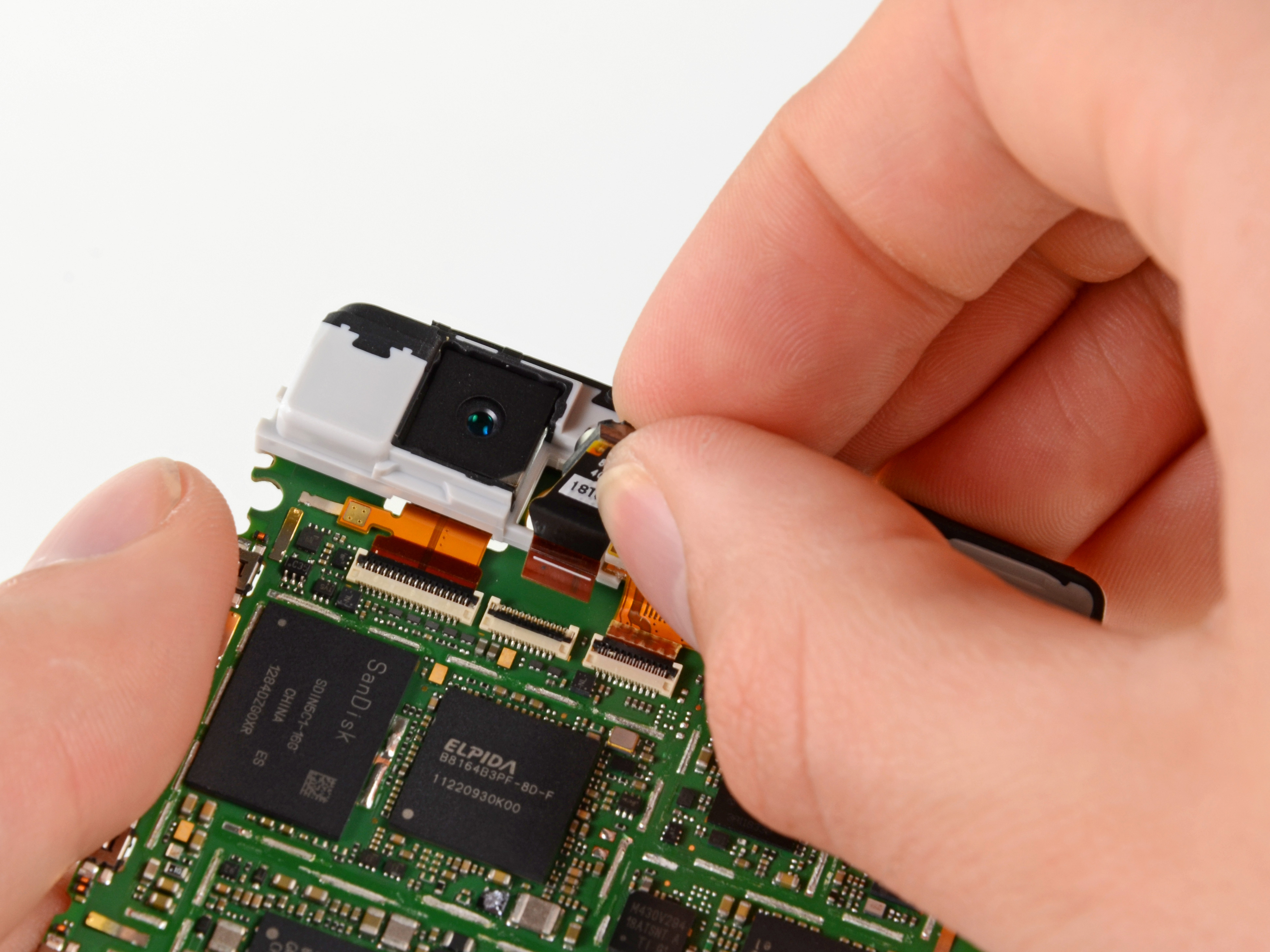

Add Note Edit Step 6 — Camera Cover  ¶
  • Use a heat gun or hair dryer to soften the adhesive underneath the camera cover.
    • The following steps were performed without the use of a heat gun. Notice that the camera cover cracks very easily if you do not heat the adhesive that holds it in place.
  • Gently pry up the bottom edge of the camera cover with a plastic opening tool.
  • Carefully slide the plastic opening tool across the bottom edge to free it from the adhesive.
  • Continue to use the heat gun as needed to soften the adhesive as you remove the camera cover.
Image #1 Image #2 Image #3
Add Note Edit Step 7  ¶
  • Insert the plastic opening tool underneath the top edge of the camera cover.
  • Gently pry the camera cover up as you slide the plastic opening tool across the top edge to free it from the adhesive.
  • Remove the camera cover.
Image #1
