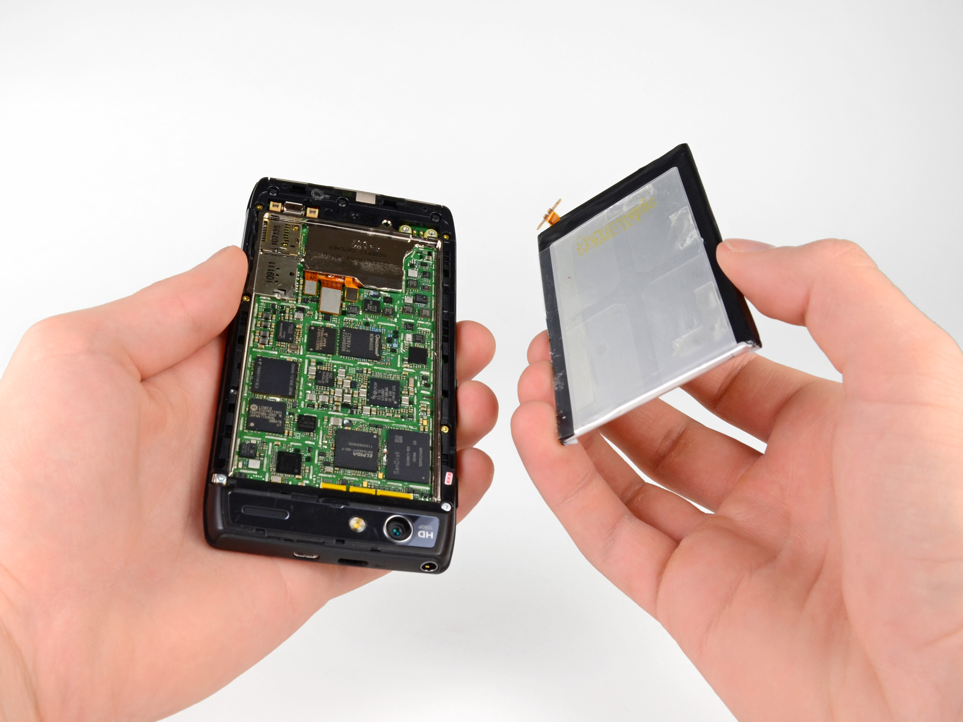

Give life back to your Droid RAZR with a new battery.
If your battery is swollen, take appropriate precautions.
Insert a plastic opening tool between the back cover and rear case at the lower left edge of the back cover.
Pry the back cover up with the plastic opening tool to free the plastic clips.
Continue prying along the left edge of the back cover towards the top of the phone.
Use the tip of a spudger to lift up the red silicone cover over the battery terminal screws and remove it.

Great guide. Honestly the spudger tool made it soooo easy.. I even used the spuder to remove the case from the phone. gently inserting the spudger while using slight pressure on removing the case. you could hear the small cracks as the adhesive gave way.. Take your time when doing this and it will come out just fine.... Also used the spudger on removing the battery from the case..... again carefully inserting the tool while pulling up slowly with the blue tab...
You guys rock.....Thanks again.
I bought a knock off brand battery off of amazon and used it. At first i thought it wouldn't work but after a little playing around with it i got it to fit. Big thing is be delicate, SLOWLY remove the back paneling and try not to bump the bottom thing where the screws go.
Very helpful and informative article, it made it easy for me to fix my phone at home. Thank you a million!
