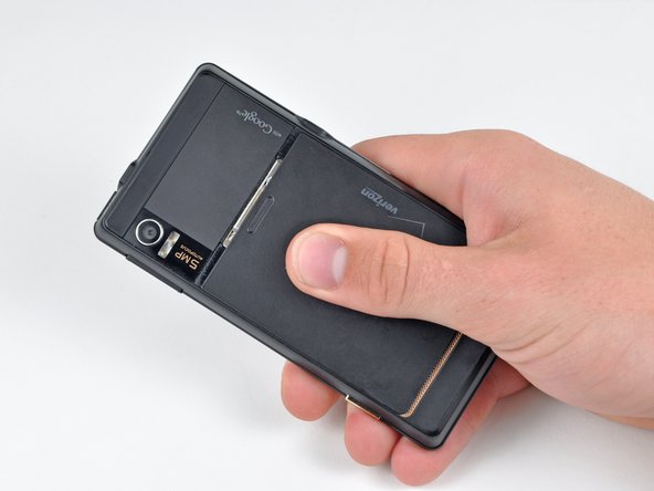

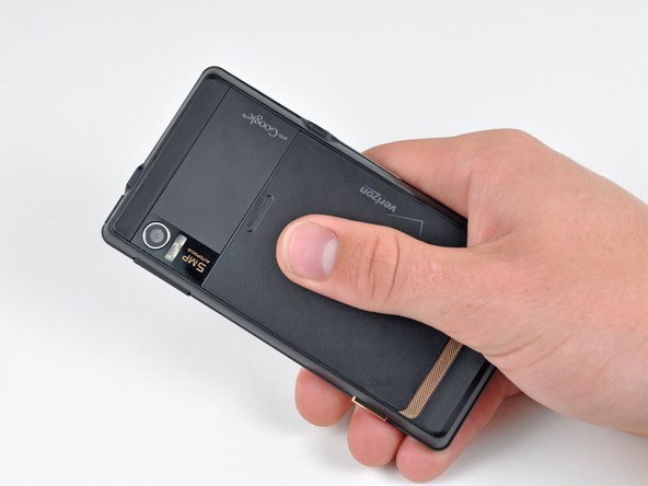

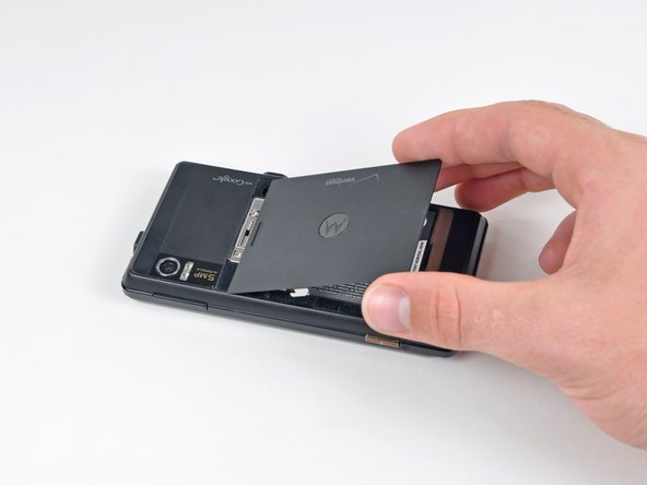

    • Slide the battery cover downwards while applying pressure to the center of the battery cover with your thumb.
    • Lift and remove the battery cover out from the phone.

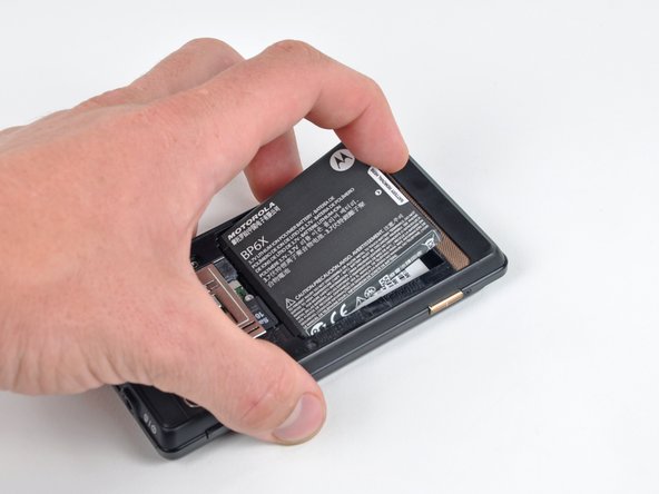

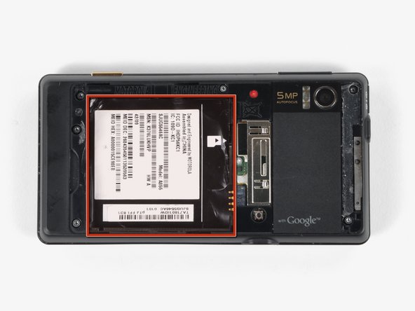

  2. Motorola Droid LCD Replacement: step 2, image 1 of 1
    • Grasp the upper left corner of the battery and lift it out of its housing.

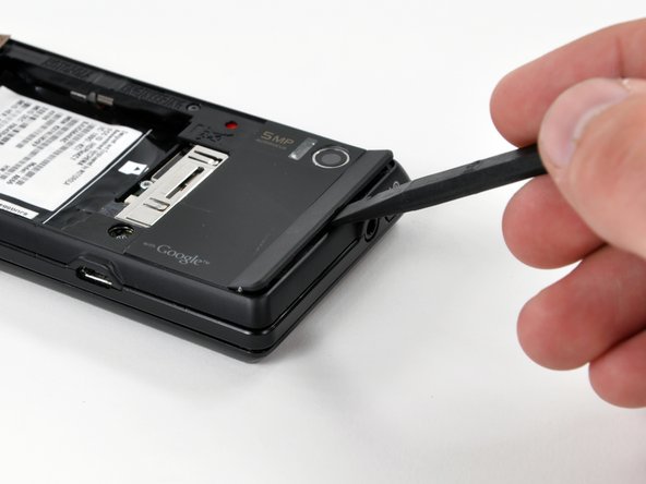

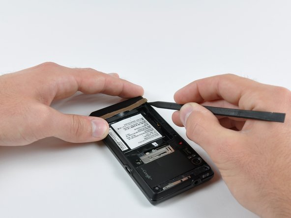

  3. Motorola Droid LCD Replacement, Rear Case: step 3, image 1 of 1
    • Use a spudger to lift and remove the black plastic screw cover at the top of the phone near the camera.
    • The cover is attached by adhesive, so some force may be required.

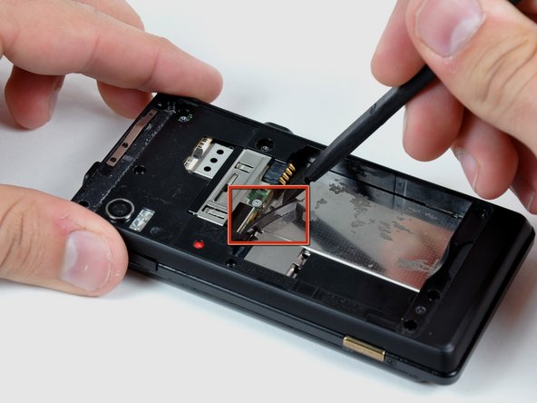

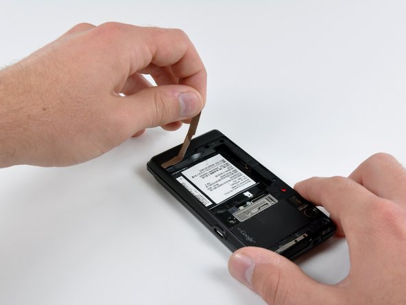

  4. Motorola Droid LCD Replacement: step 4, image 1 of 2 Motorola Droid LCD Replacement: step 4, image 2 of 2
    • Using the tip of a spudger, peel up one corner of the gold ribbon beneath the battery compartment.
    • Peel the ribbon up off the phone.

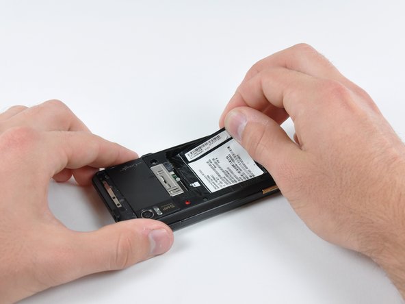

  5. Motorola Droid LCD Replacement: step 5, image 1 of 2 Motorola Droid LCD Replacement: step 5, image 2 of 2
    • Carefully peel the device information label that covers the motherboard EMI shields.
    • This label contains important information specific to the phone. Remove it with care and keep it in a safe place.
