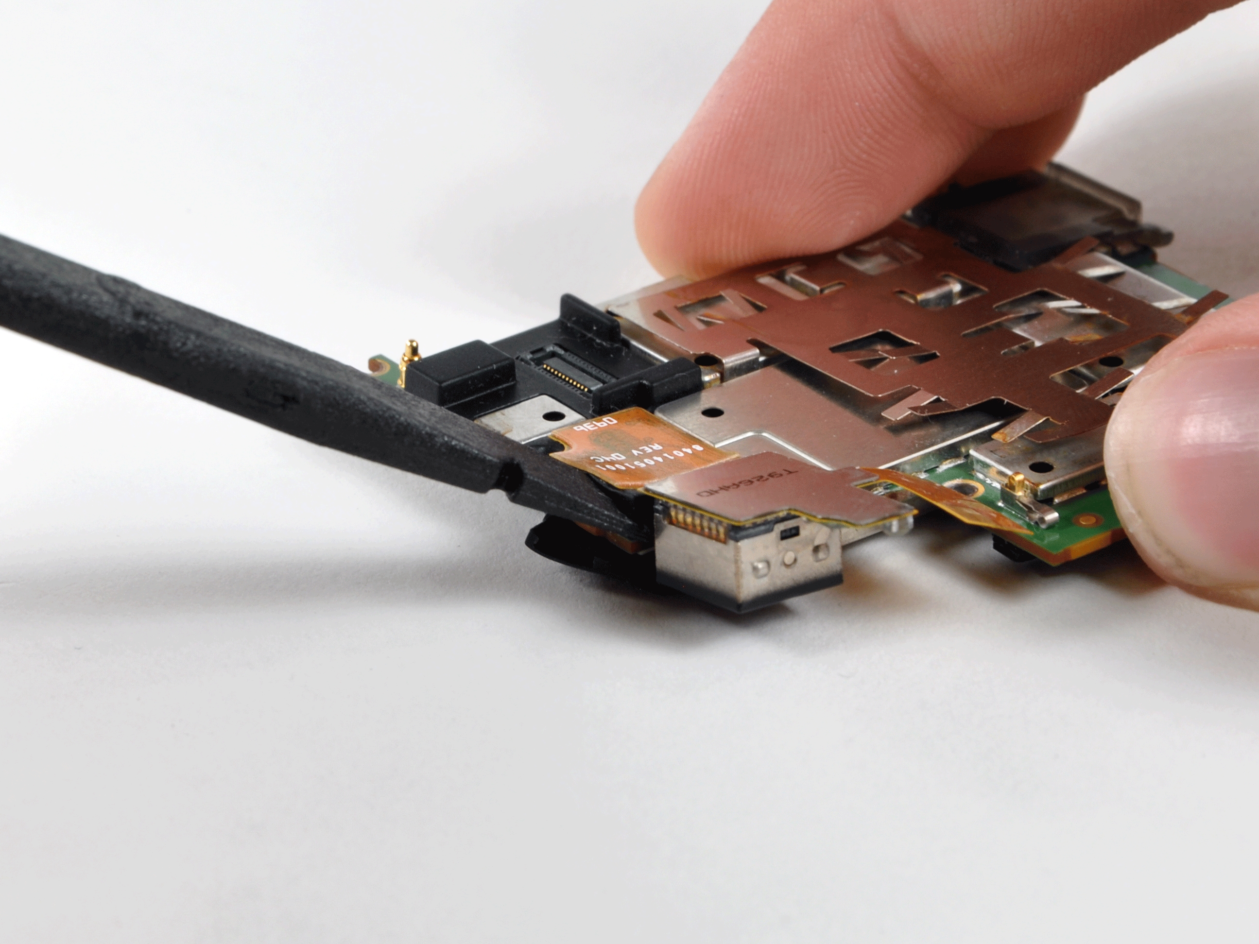

Add Note Edit Step 8  ¶
  • Insert the flat end of a spudger and pry downwards to release the plastic tab holding the rear case to the motherboard screw.
