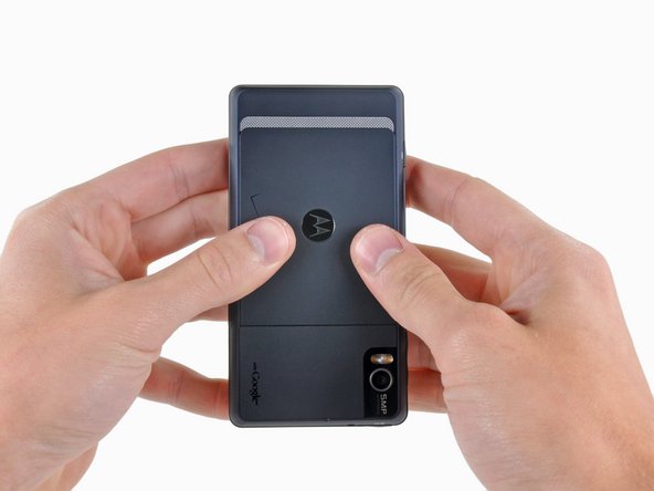

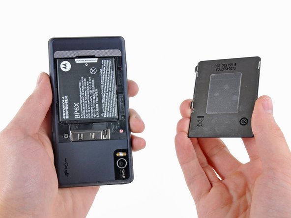

  • Slide the battery cover toward the bottom edge of the phone.
  • Remove the battery cover from the rear of the phone.

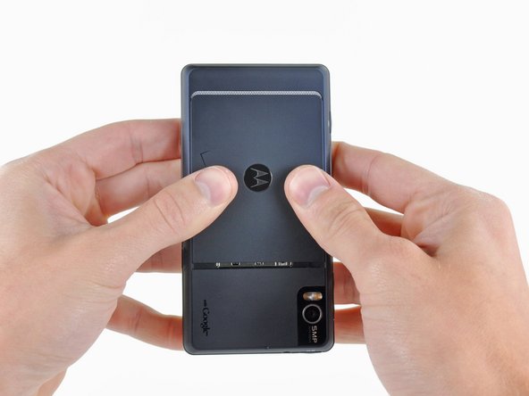

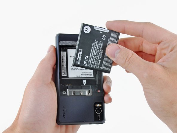

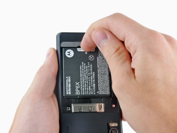

  • Lift the battery out of the Droid 2 from the edge closest to the bottom of the phone.
  • Remove the battery from the Droid 2.

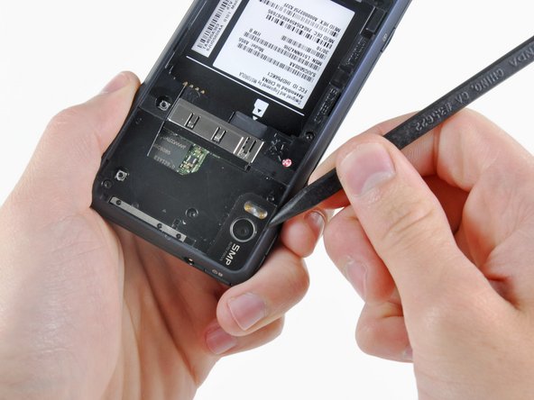

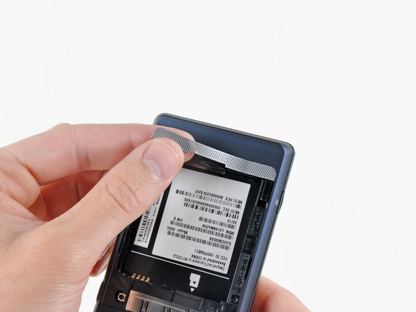

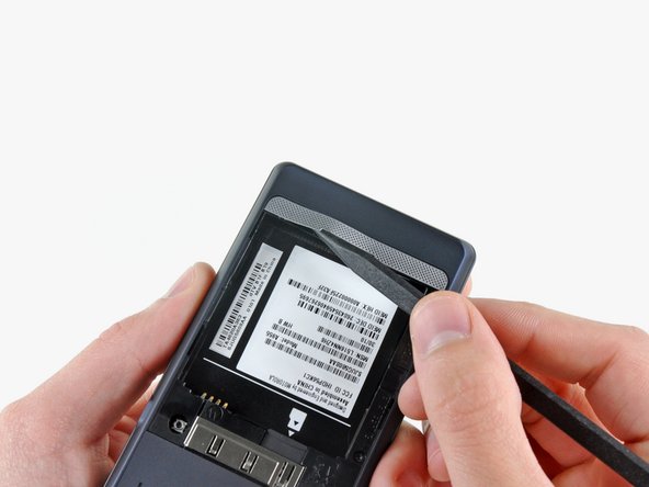

  • Using the tip of a spudger, peel up one corner of the silver ribbon below the battery compartment.
  • Peel the ribbon off the phone.

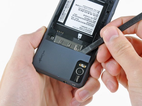

  • Insert the flat end of a spudger and pry the plastic camera cover up off the phone.
  • The thin plastic cover is attached to the phone with an adhesive. Work slowly and carefully.

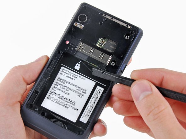

  • Use the tip of a spudger to remove the camera bezel stuck to the rear case.
Image #1

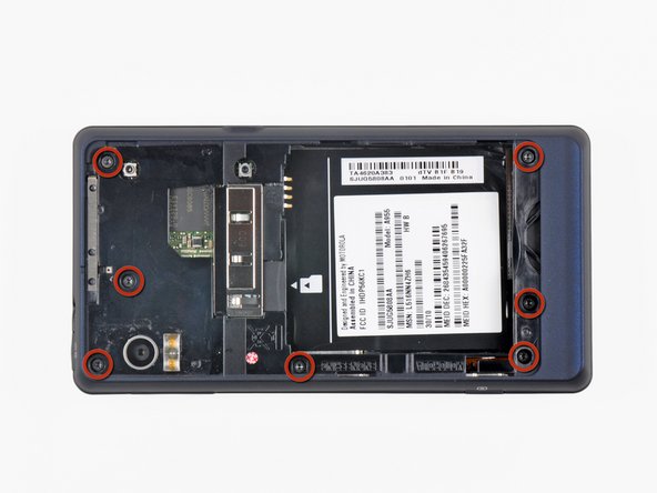

  • Remove the seven 5.5 mm T5 Torx screws securing the rear case to the inner case.
