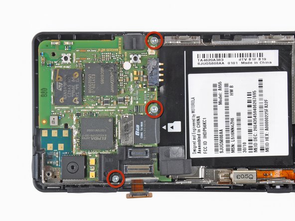

Image #1
Add Note Edit Step 17  ¶
  • Remove three 3.8 mm T5 Torx screws securing the motherboard to the front case.
  • Don't attempt to remove the motherboard yet, it is still attached by the keypad ribbon connector.
Image #1
Add Note Edit Step 18  ¶
  • Carefully lift the motherboard from the front case and lay it next to the Droid 2, minding the keypad connector that is still attached.
  • Disconnect the keypad connector by prying it straight up off its socket on the motherboard.
  • Remove the motherboard from the Droid 2.

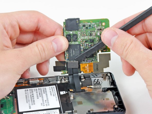

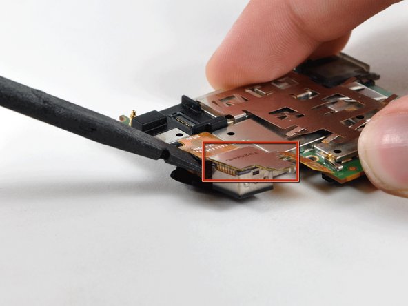

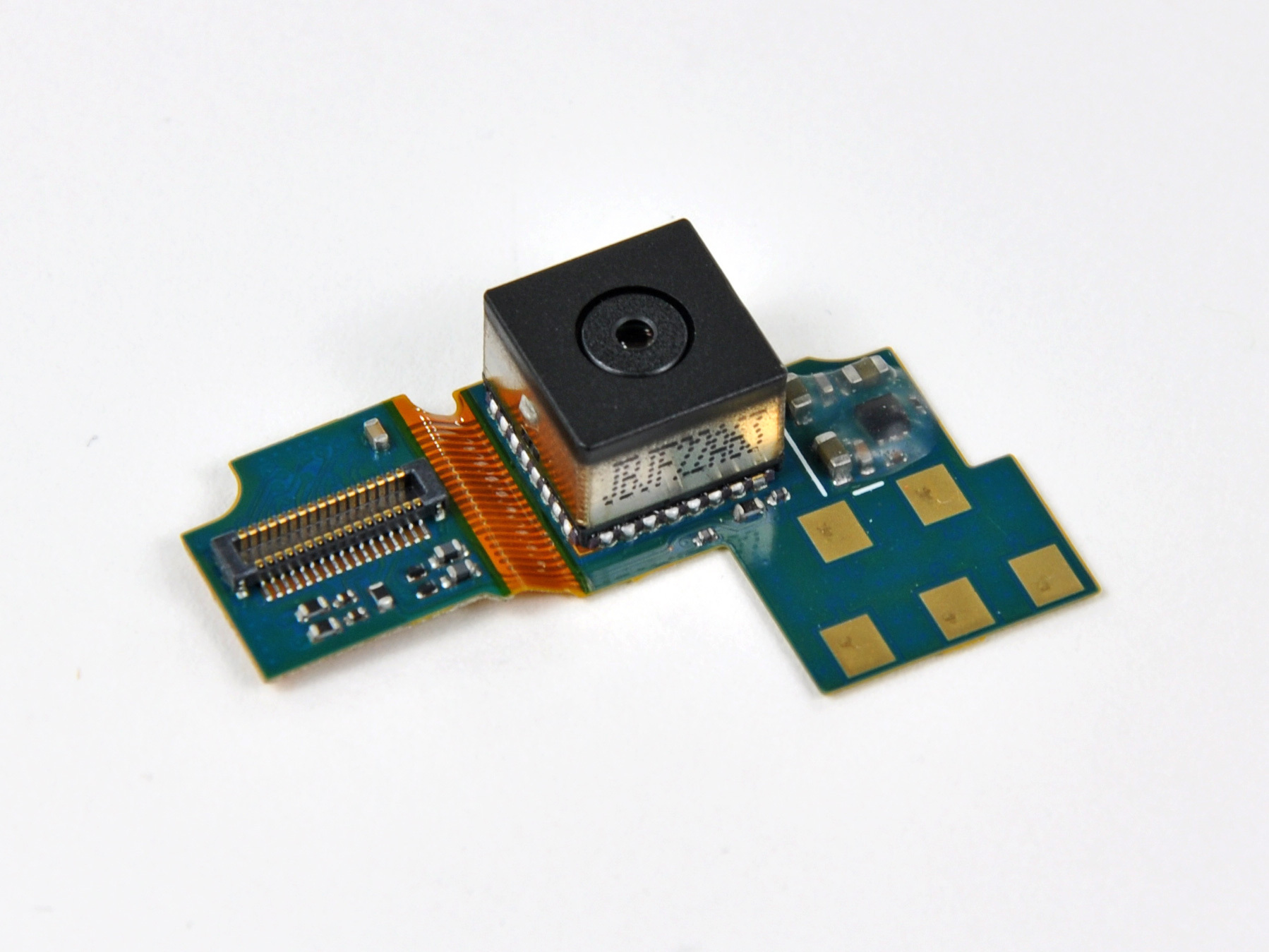

Image #1 Image #2
Add Note Edit Step 19 — Camera Assembly  ¶
  • Orient the motherboard so that the camera lens is face down.
  • Disconnect the camera connector from its socket by prying it straight up with a spudger.
  • Remove the camera assembly from the motherboard.
